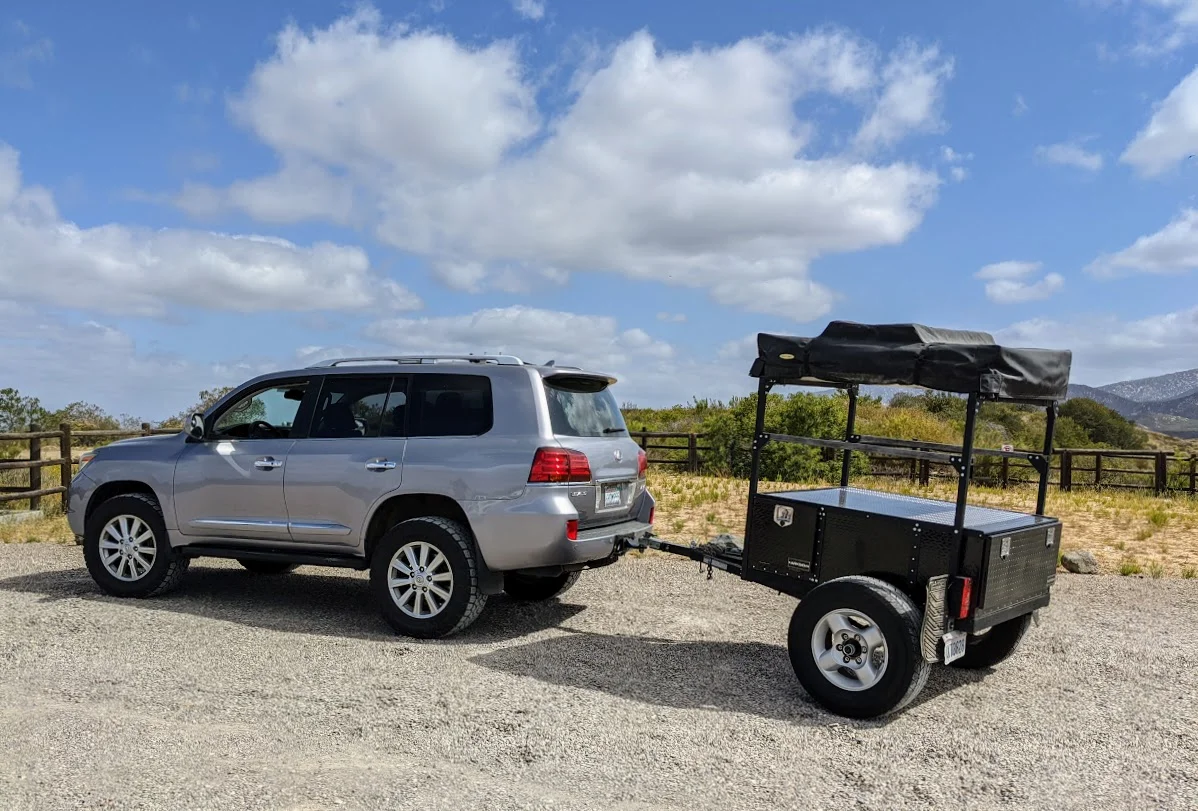

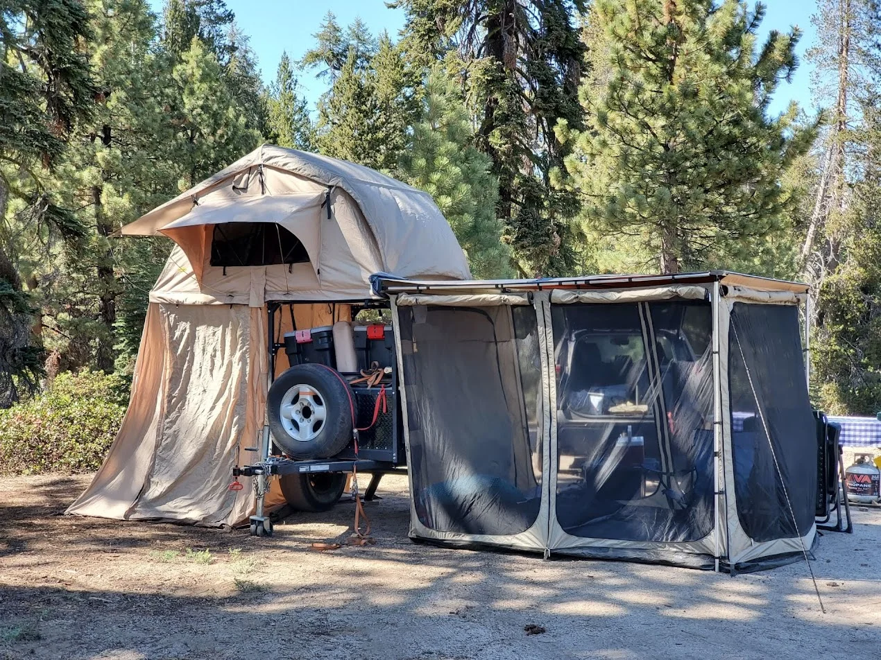

I built this modest trailer for a buddy (trying it on my car for size here). He's loving how functional it is. With 20 gallons on board, doubling of storage with half of it secure and away from the elements, RTT for 2, annex for changing, and another awning/room for 2 more. I'm thinking this may be a path I might do for myself.

I can't argue with the overland trailer approach if that's the style of camping you're looking to do. It's potentially infinitely more capable than a heavily built out overlanding vehicle. And gives you the ability to setup of a base camp while still having a vehicle to explore. Though if you're into technical terrain, still hugely viable with a compact trailer, but could have it's limitations too.
!!! That was put together for $1k (teckis engineering not included)??? Wow.
Donated professional services to a good cause. :) I was half selfish in that I camp with this buddy all the time, and wanted to see what off-road trailer camping looks like. My other buddy bought a $50k Vorsheer trailer and he's loving it too. But the honesty and ease of use of the smaller trailer makes the big one look excessive, and not necessarily for the better in many ways. Smaller lighter gets though stuff in ways that bigger, badder, can't. Sets up easier too.

It was closer to $1.5k after adding a water tank and custom axles. Not including the RTT and awning/room as those are another $1k+ in goodies.
