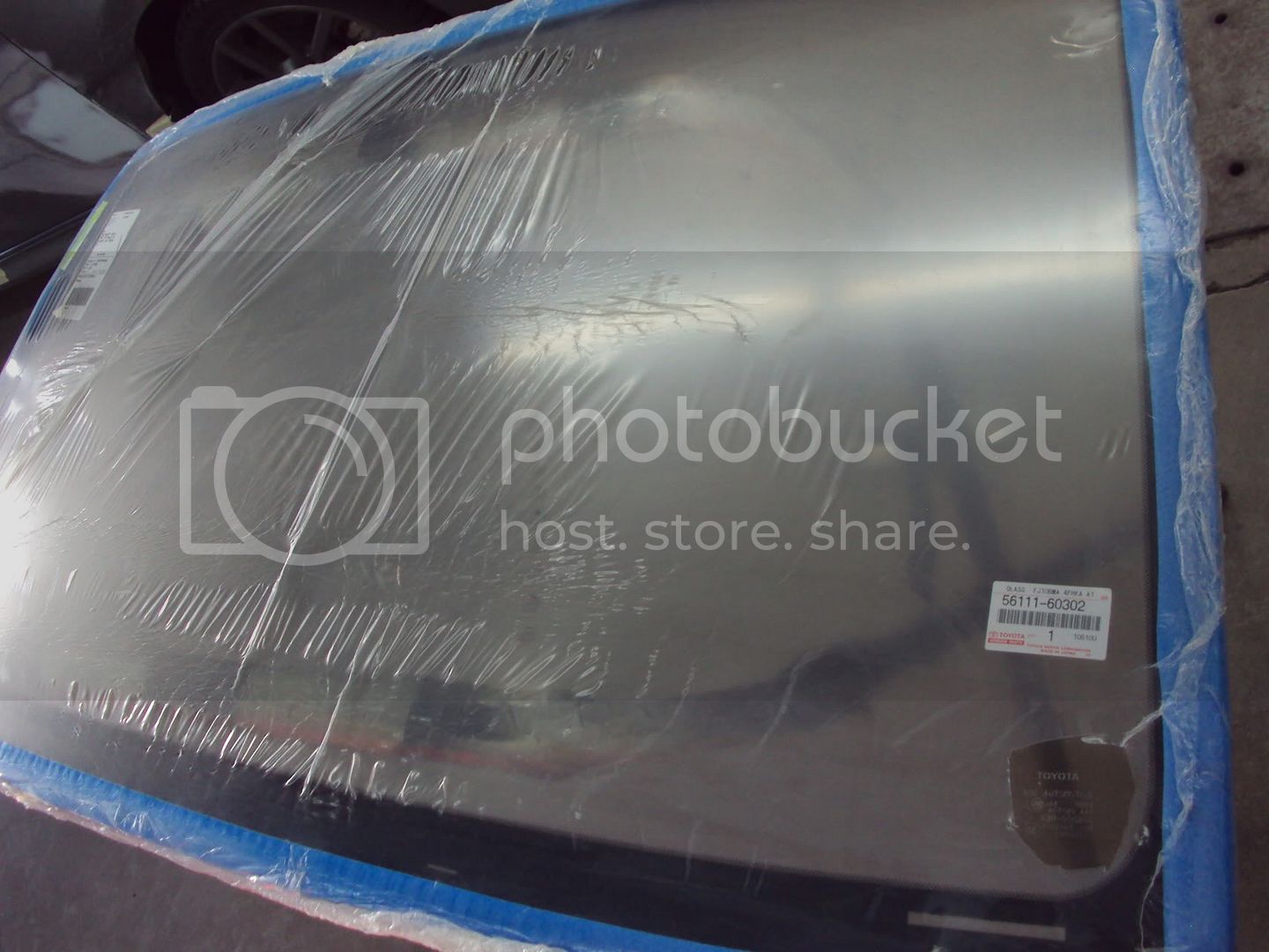

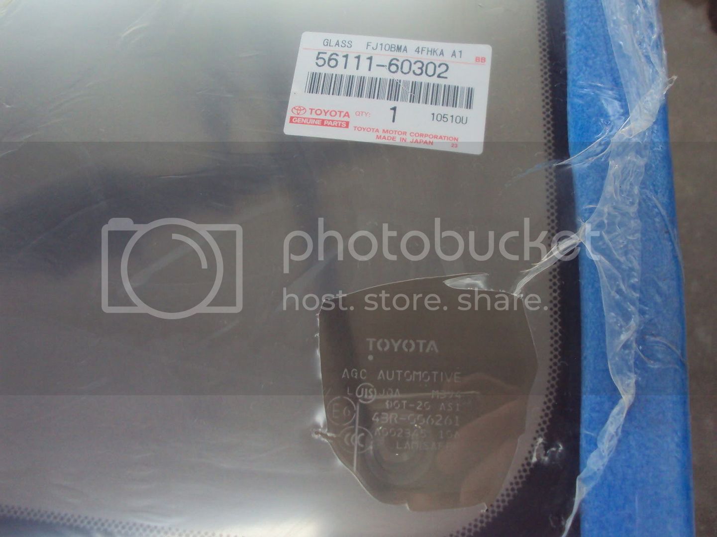

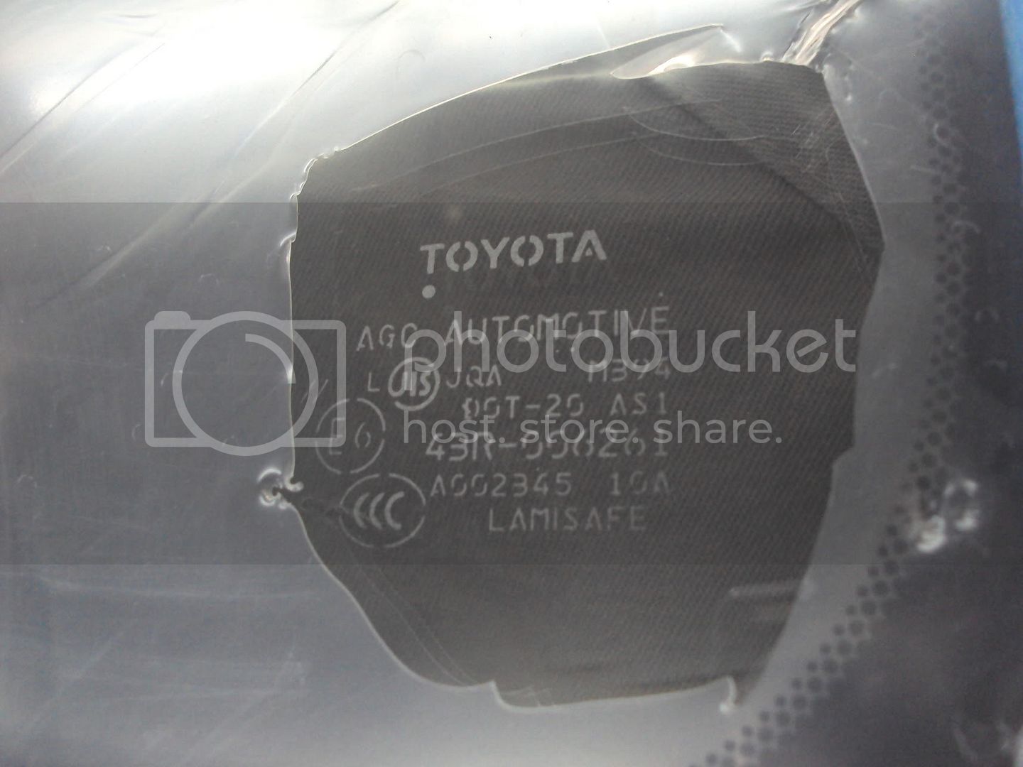

I have an OE windshield at the shop waiting to go in.
What is it you need to know?
Markings? Shading?
Only that we can confirm Pilkington is oem.

Were you wanting to see the actual tint to it? Or just the manufacturer?
