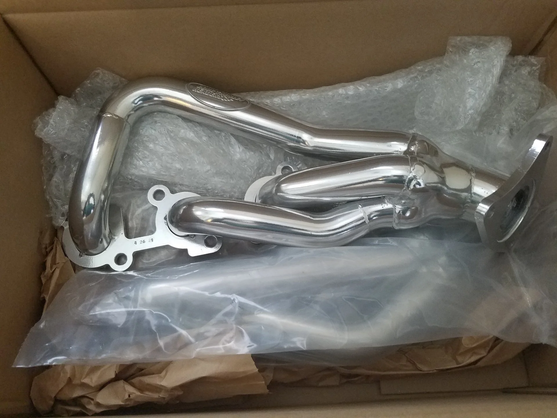

Everyone who's heard of these headers knows the install is a royal PITA given there's virtually no room and the manifold nuts are basically guaranteed to strip.
I haven't ever used a shop for any LC work but I may get a shop to install these.
Anyone have a local LC shop they'd trust to install these? I'd prefer someone with LC knowledge and maybe who's done these before.
Or if some folks want to lend a hand with the install and may have more tools/know-how for removing seized bolts and such, I'm game for that too! I started it and two of the passenger side manifold nuts stripped with my 14mm sockets, a spline socket and my nut removal cut socket didn't get them either. That's when I stopped and here we are! Having never tapped out of a job before...this hurts my pride.

I'm working on psyching myself up to give it another go Wednesday afternoon. I bought some deep extraction sockets to work on the manifold bolts since that was my main issue. My short extraction sockets were just barely too short to fully seat.

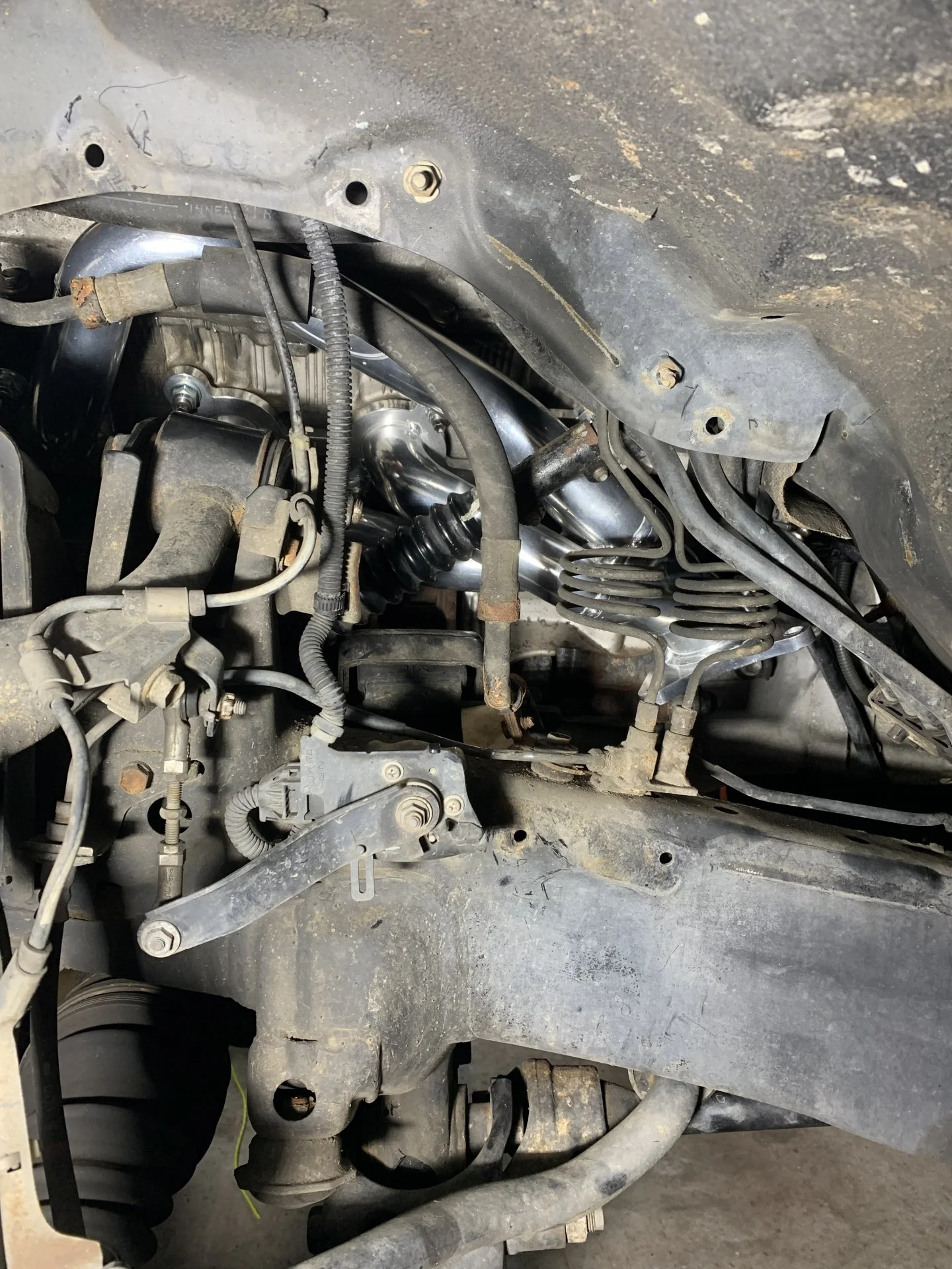

Well..the new deeper extraction sockets did the trick. Got the passenger side header in today. Going to attempt to tackle to the driver side tomorrow. My intermediate steering shaft from the wheel to the rack is seized on so I'll have to get creative to get it off.

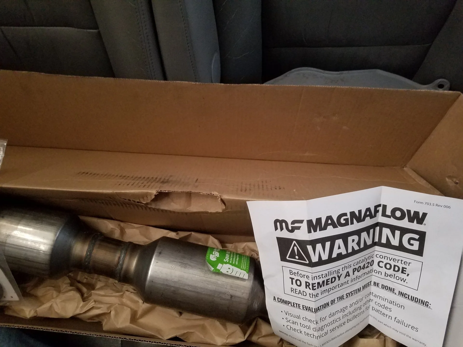

It was like that when I bought it. Let me look up the for sale ad and see if there is any more info. These are complete replacements and small.

I got the MF high-flow cats and DT cat-back system to go with the headers.

@Hokie LX - Those look like the CATS I have.

Honestly, not nearly as bad as I thought. Once I stopped trying (wasting time) to get the steering shaft out and remove the heat shield, I just left them in and got the manifold bolts out from there the swap was easy.
My pride has been restored! Now to button up the exhaust and put the covers back on and take it for a spin
