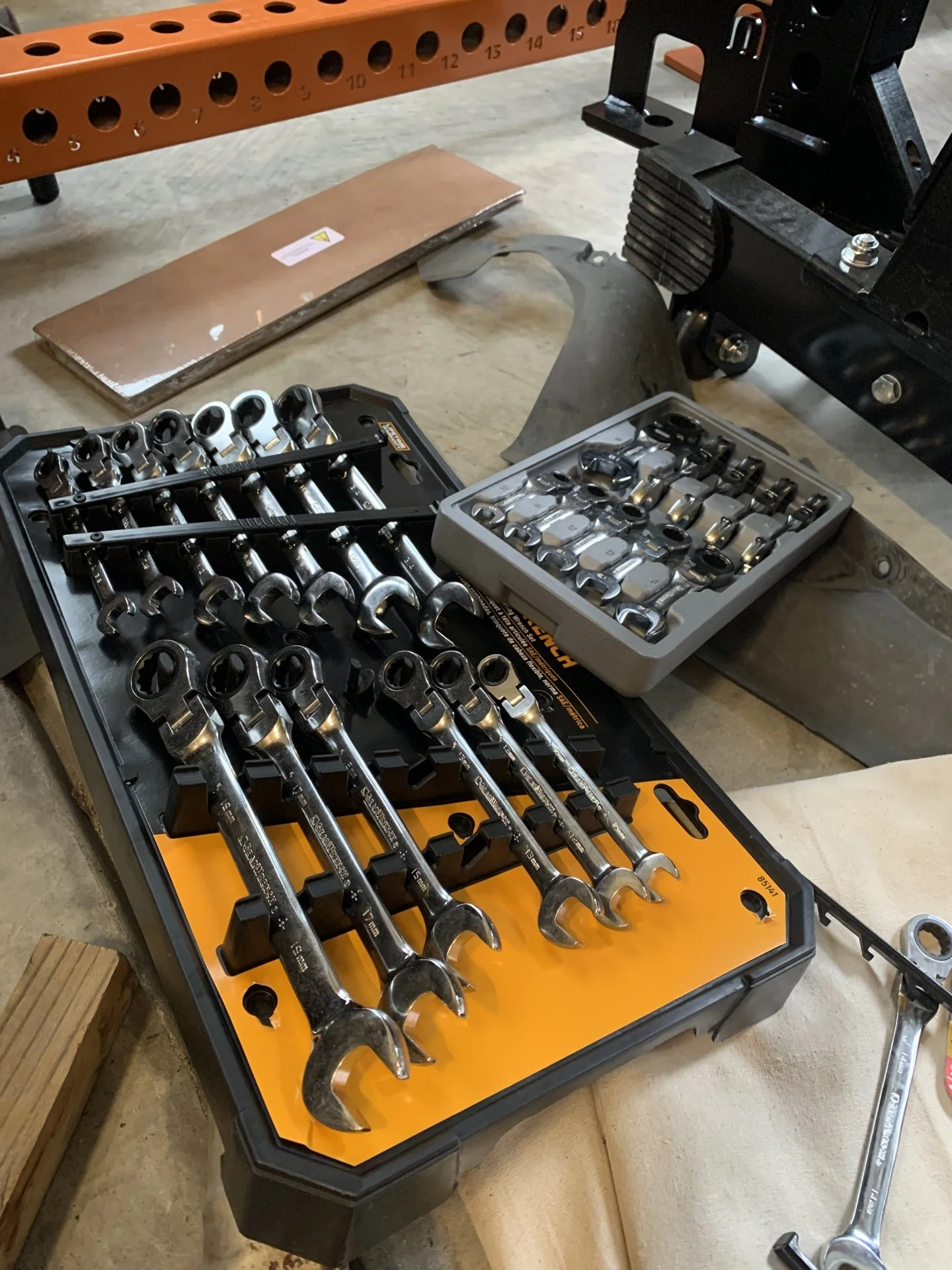

Honestly...the hardest part of the driver side job today was getting the f**king oil dipstick tube retaining bolt back in! The DT header tube now goes right in front of it and it was honestly a huge pain in the butt since there's no room to place and manipulate it and it's at an odd angle to get a normal socket on it through the fender well. I finally got it with a swivel socket that I happened to find in my toolbox (lucky) and packing it full of grease so the bolt would stay in it while I fished it through the fender well.
Here are the wrenches I ordered. GearWrench swivel ratcheting wrenches. I bought stubby and normal length and used them both.
