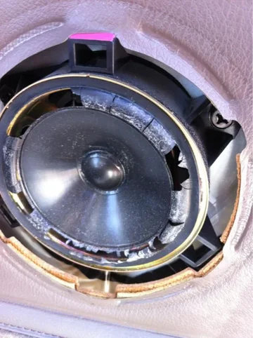

Just put a pioneer avh 4400 into 95fj80; replaced fronts and tweets with 6.5 tsa1604c pioneer combo. Pics
Hi DEADSALT,
I am loking for aftermarket replacements for the OEM speakers in my 97 LX450 and was wondering what brand and spec are the ones shown on the third photo down on your post #13. Thanks and regards,

Texan - I have just replaced the HU and speakers in my 97 LX450. I used the same Pioneeer HU you are looking at. Fits great. Went ahead and replaced the four door speakers as well. I used Kicker 6 1/2s in front, Memphis Audio 4 1/2s in back. The fronts required cutting a spacer mount to provide enough depth, but was able to use the OEM speaker cover. The rears went in with no problem.
The sub is in the center console between the seats. It is a 4 1/2 pioneer with the tweeter removed. Mine was working fine so we decided not to replace. The front door speakers were trashed with paper missing.
