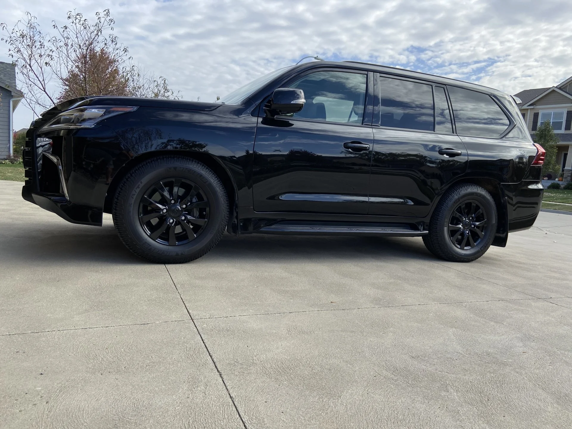

Black on black with LC200 powder coated 18” Michelin LTX AT2 275/65/18.
Happy with the look and performance.
You could easily go larger.
275/70/18 is an easy 33” fit.
Butttt you can go much bigger with a little more work. I run a 295/70/18 (34.5”), @radman runs 305/70/18f @TeCKis300 runs 35x12.5, @grinchy running a skinny 35.

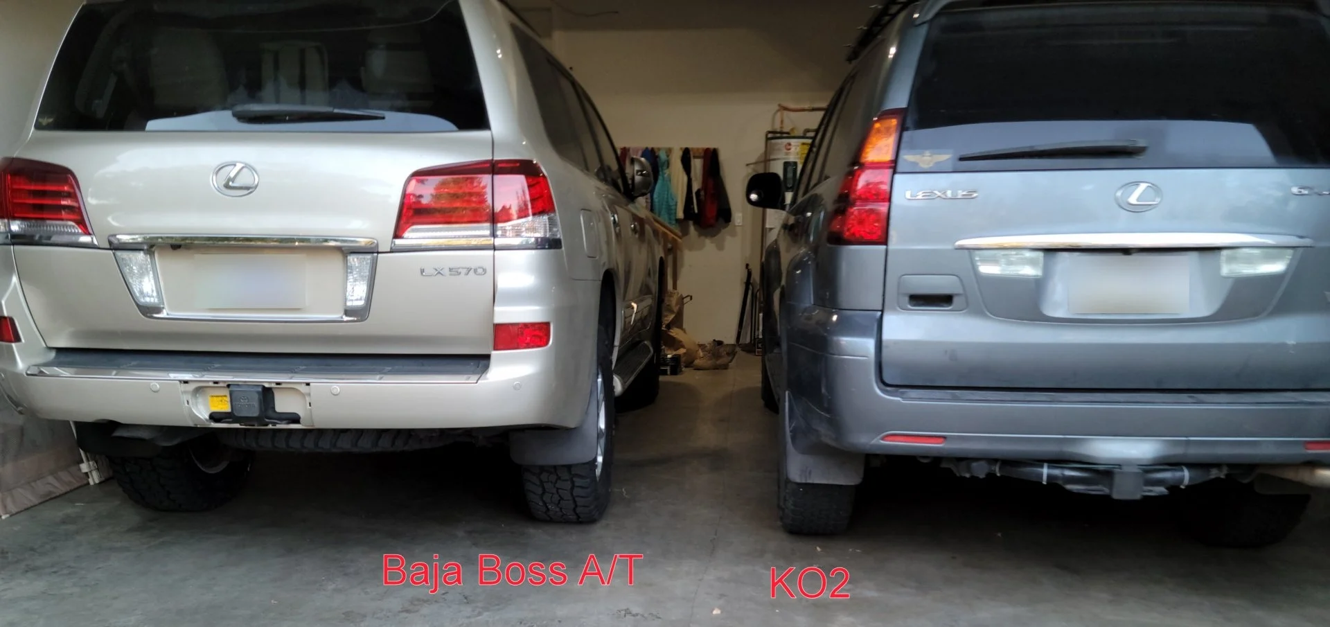

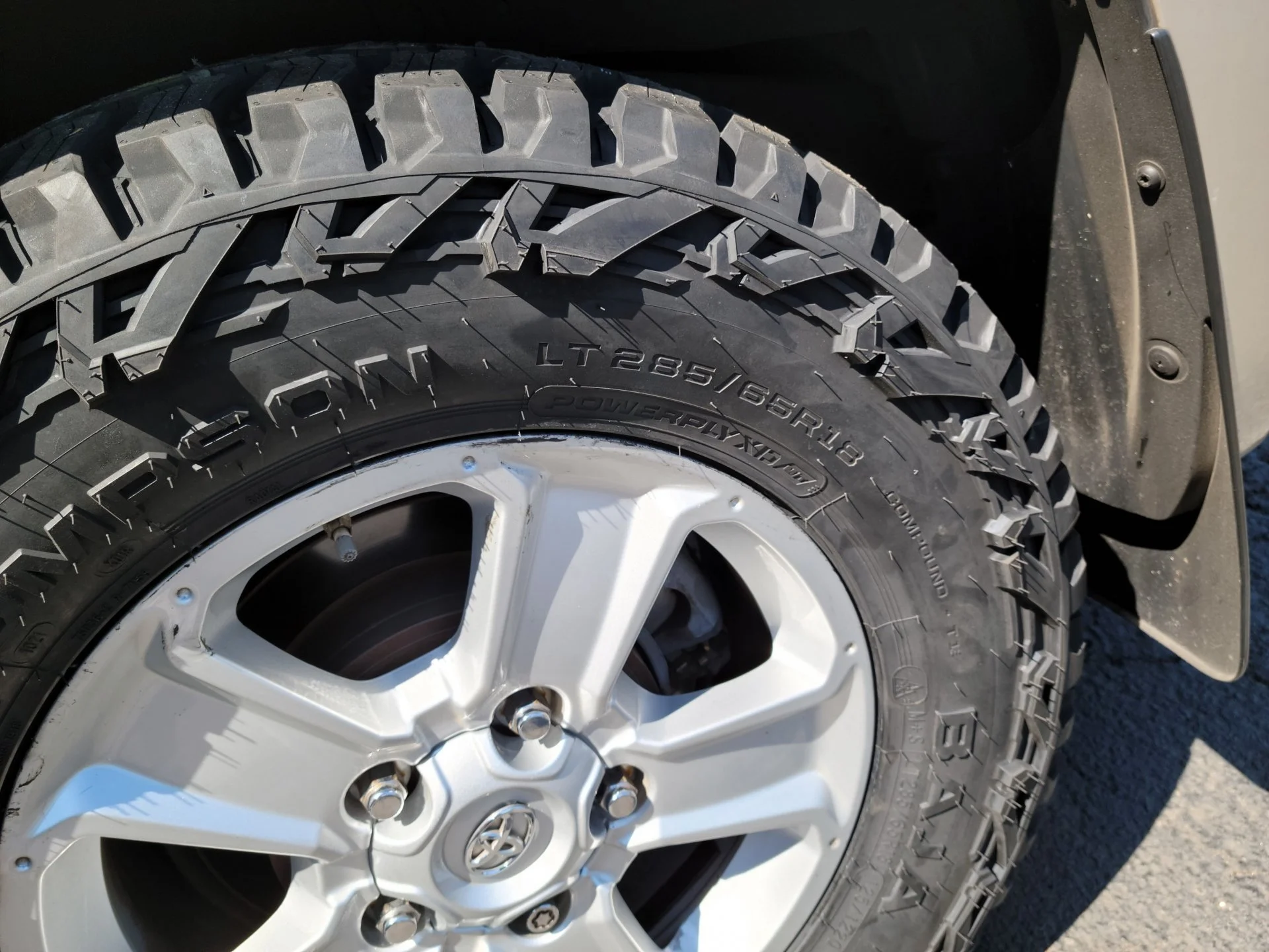

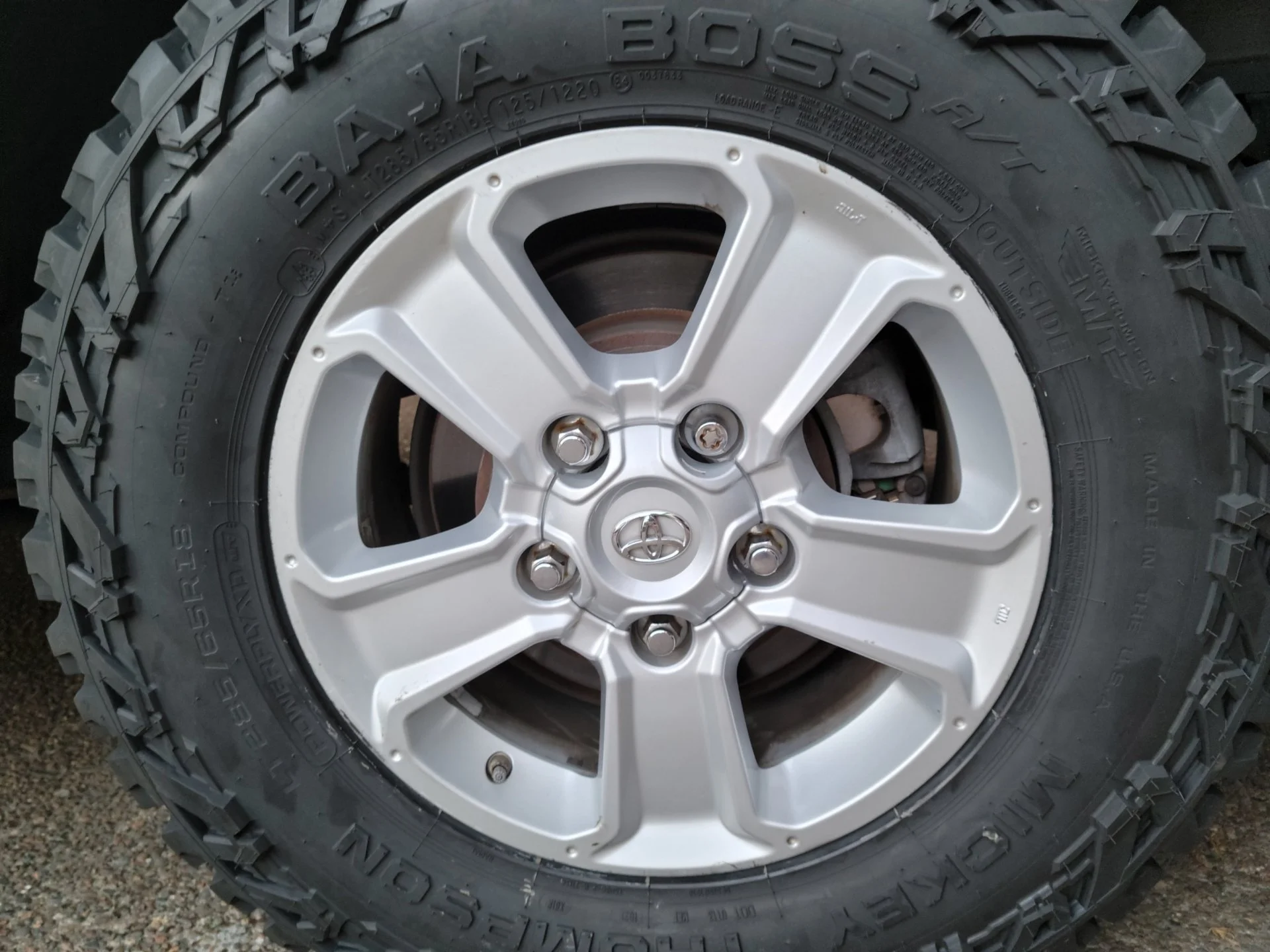

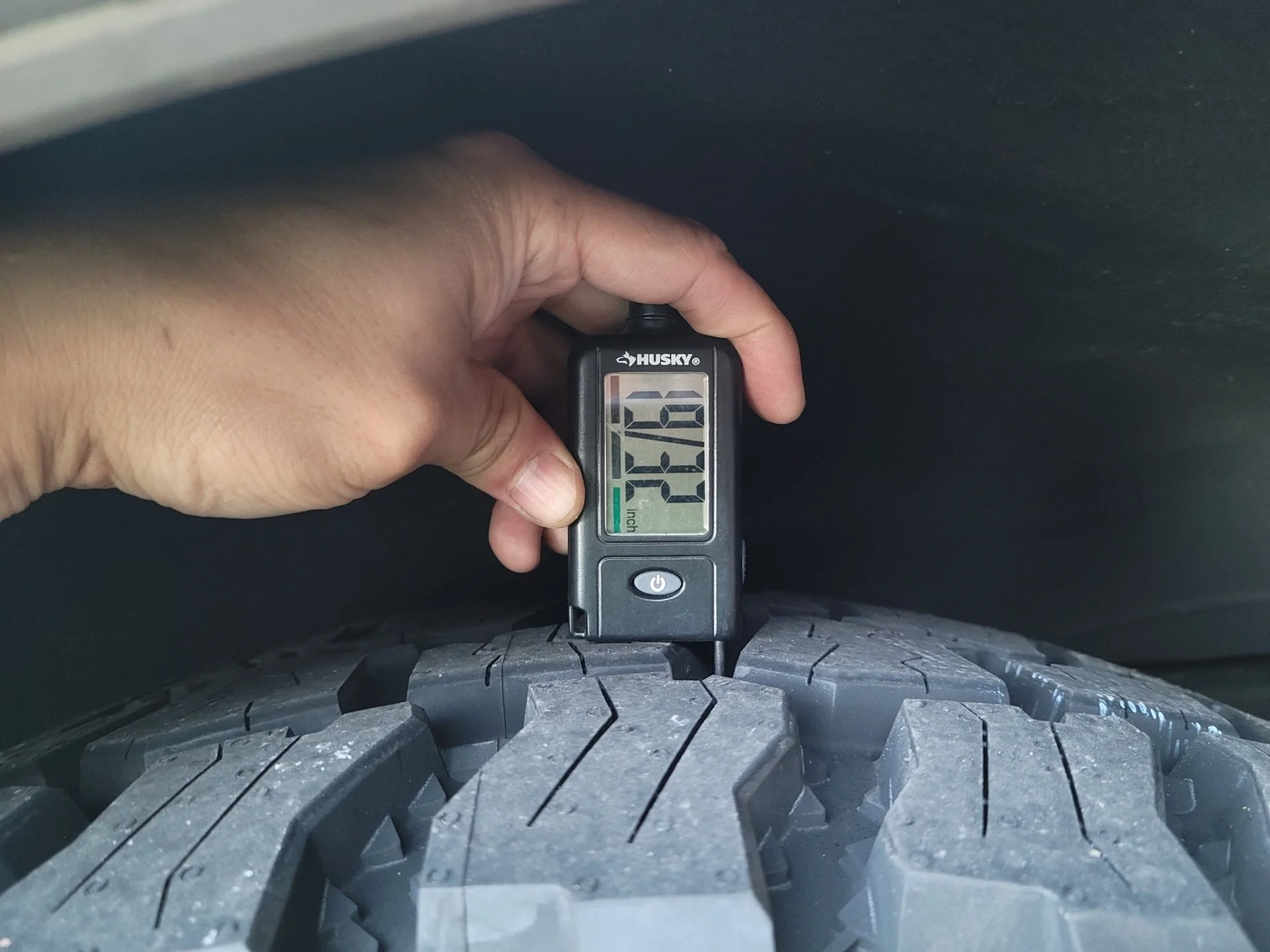

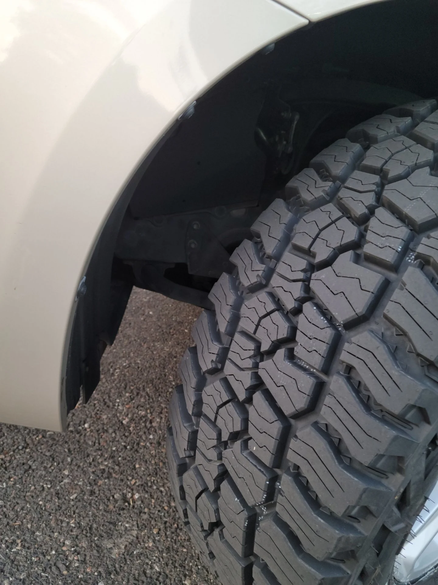

33" ish is the largest tire you can go without rubbing/modification plus it will fit in the spare (which I think can take up to a 34" tire). I am currently running the new Mickey Thompson Baja Boss A/T in 285/65R18 on 18in Tundra wheels. These are 33.2in OD tires (with 19/32in deep threads) so it rubbed slightly on the front mudflaps on full lock. I modified the front mud flaps by bending the inner portion toward the frame by .5in to create a concave shape and now I have no rubbing at all. Alternative is to just remove the front mudflaps. Alignments are in spec as well. I am not running any spacers. The Tundra rim (426110C160) specs are 18" x 8" with an offset of 60mm. Noise level is probably the same as the KO2 and I can't really hear it when the windows are closed.
The Baja Boss A/T tires are more aggressive than the KO2 that I have on my 4Runner and GX. The sidewall grips are even more beefier. They are in between an A/T and M/T tire. They are not dedicated M/T like the KM3 though.
I forgot to mention that LT285/65R18 KO2 and KM3 have an OD of 32.6in. The Baja Boss A/T is 0.6 in taller with an OD of 33.2in so it will rub slightly.

I have only used them in the sand (Oregon/Washington beach) since I got them installed 2 weeks ago. Subjectively, it feels the same as the KO2. I will have to wait till the rainy/snow season to see how well they perform. I got these over the KO2 primarily for better mud performance due to the weather in the Pacific Northwest from October to March.
Where did you get them? They seem to be in short supply.
The Baja Boss A/T tires are hard to come by. I ordered them on 4Wheel Parts but there are a few online vendors that also offer them. Discount Tires (America's Tire in Cali) do not have them. I called them to see if they can order the tires but they wouldn't. There is a long delay for shipping since I ordered them back in early June 2021.
Really sweet looking tire, how do they compare to KO2s on the street/highway?
They are just a tiny bit louder than the KO2 on the street/highway and perform about the same. They do have more siping so I hope they will perform better in the rain.

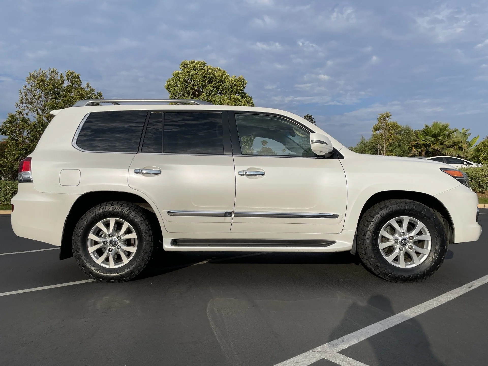

Have you done anything to lift you LX? That looks more than just a sensor lift....
