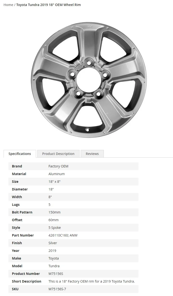

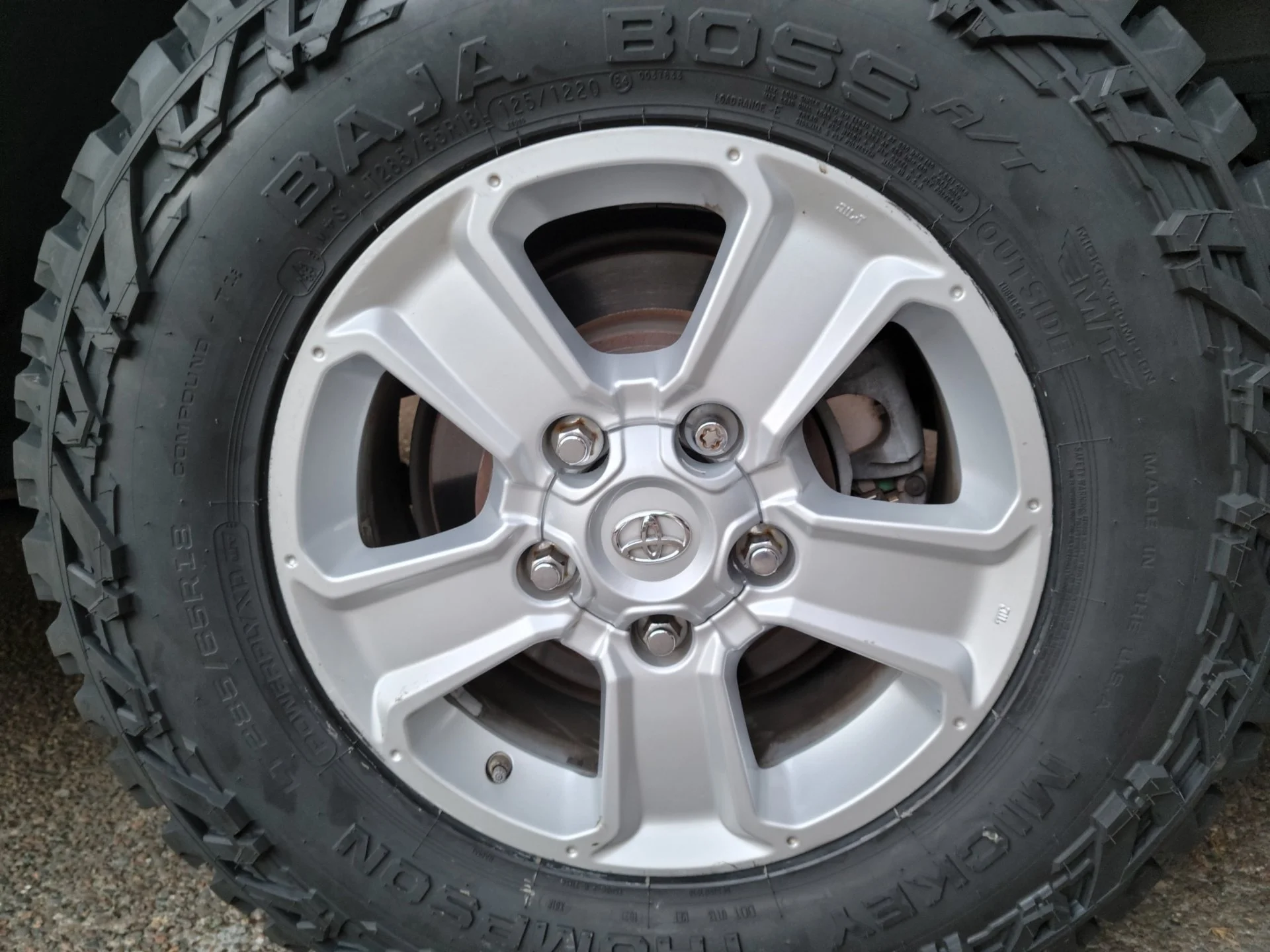

I don't think the 18in Tundra wheels I have are TRD wheels. They are just generic alloy wheels that is available on both the Tundra and Sequoia. I picked them up on Facebook marketplace for $100 from a guy who took it off his 2019 Tundra. I got them because of the 60mm offset and I didn't want to use spacers.Don't know if your Tundra TRD wheels are the similar to the LC HE wheels but after swapping out for the HE wheels (on Toyo AT3 275/70/18s btw) there was no tire rubbing but there was very little clearance with the front brake calipers on my '08 LX. This led to adding 1.25" spacers to get a bit more clearance which in turn created some rubbing on front mudflaps. Solution for now is to run without the mudflaps until I have time to mess with figuring out if they can be easily modified/reshaped.

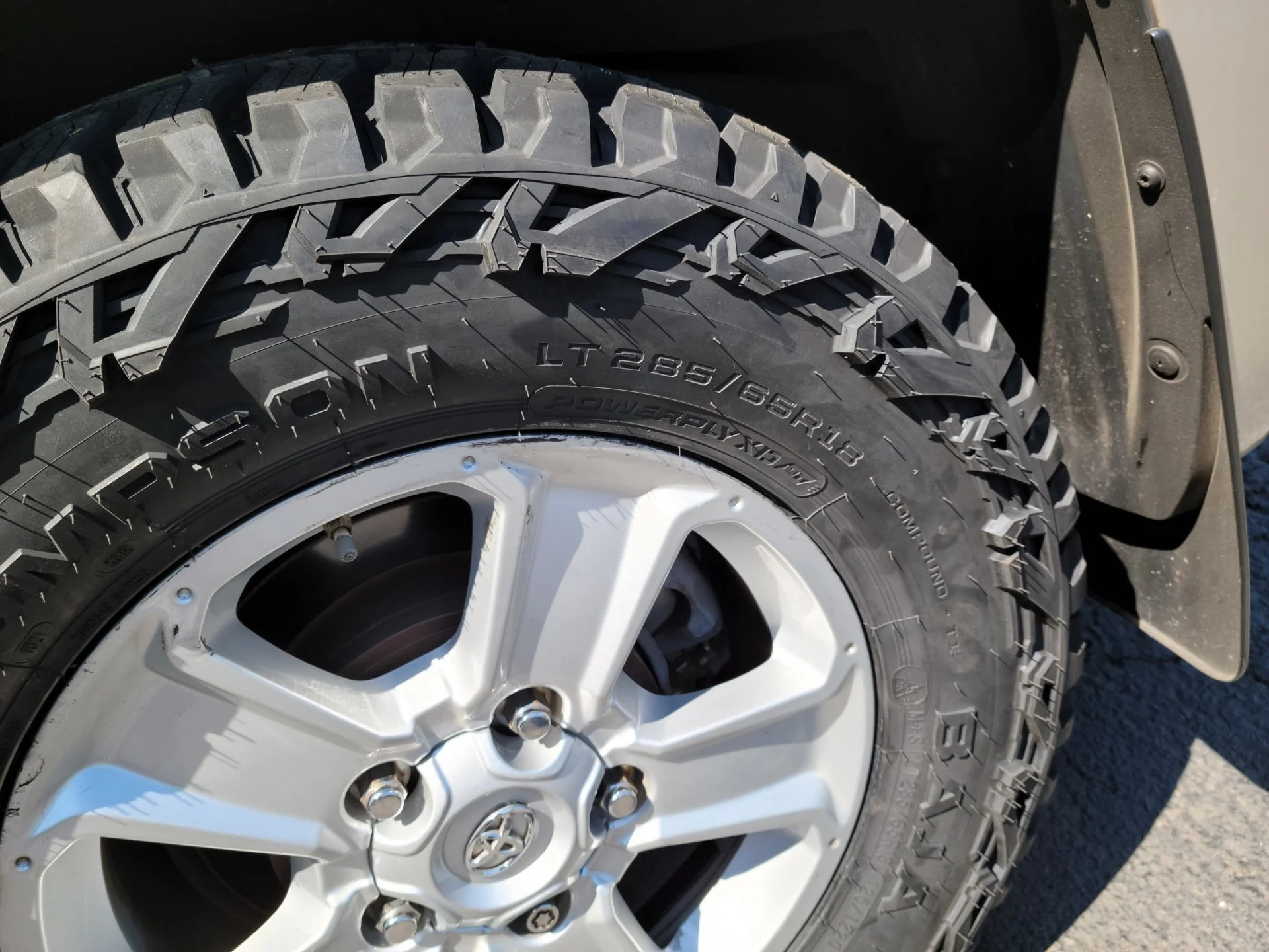

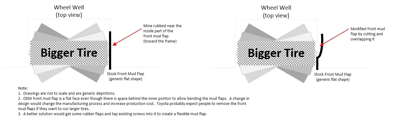

I modified my front mud flaps on the inside so it is not flat faced. It is now like an arc. This allowed my tires to clear without rubbing.

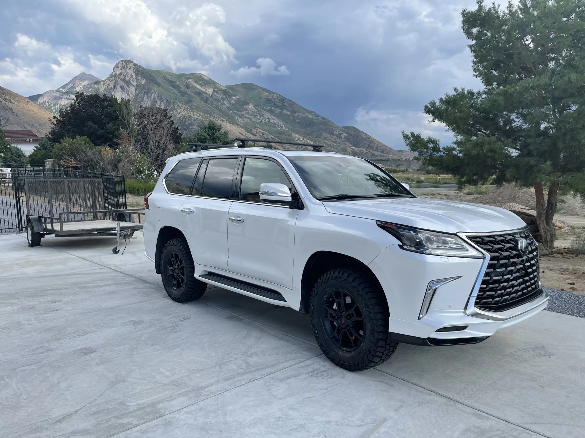

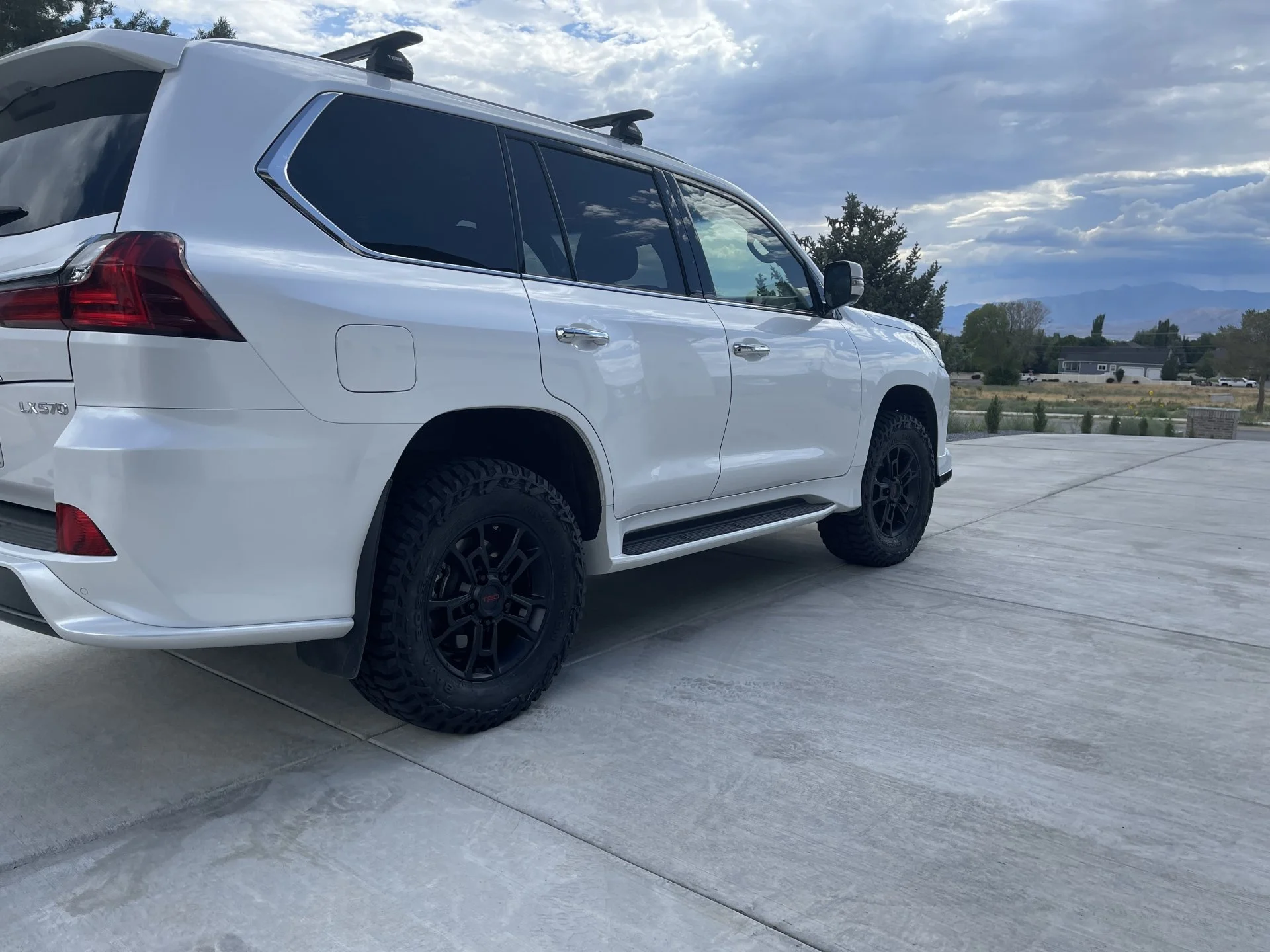

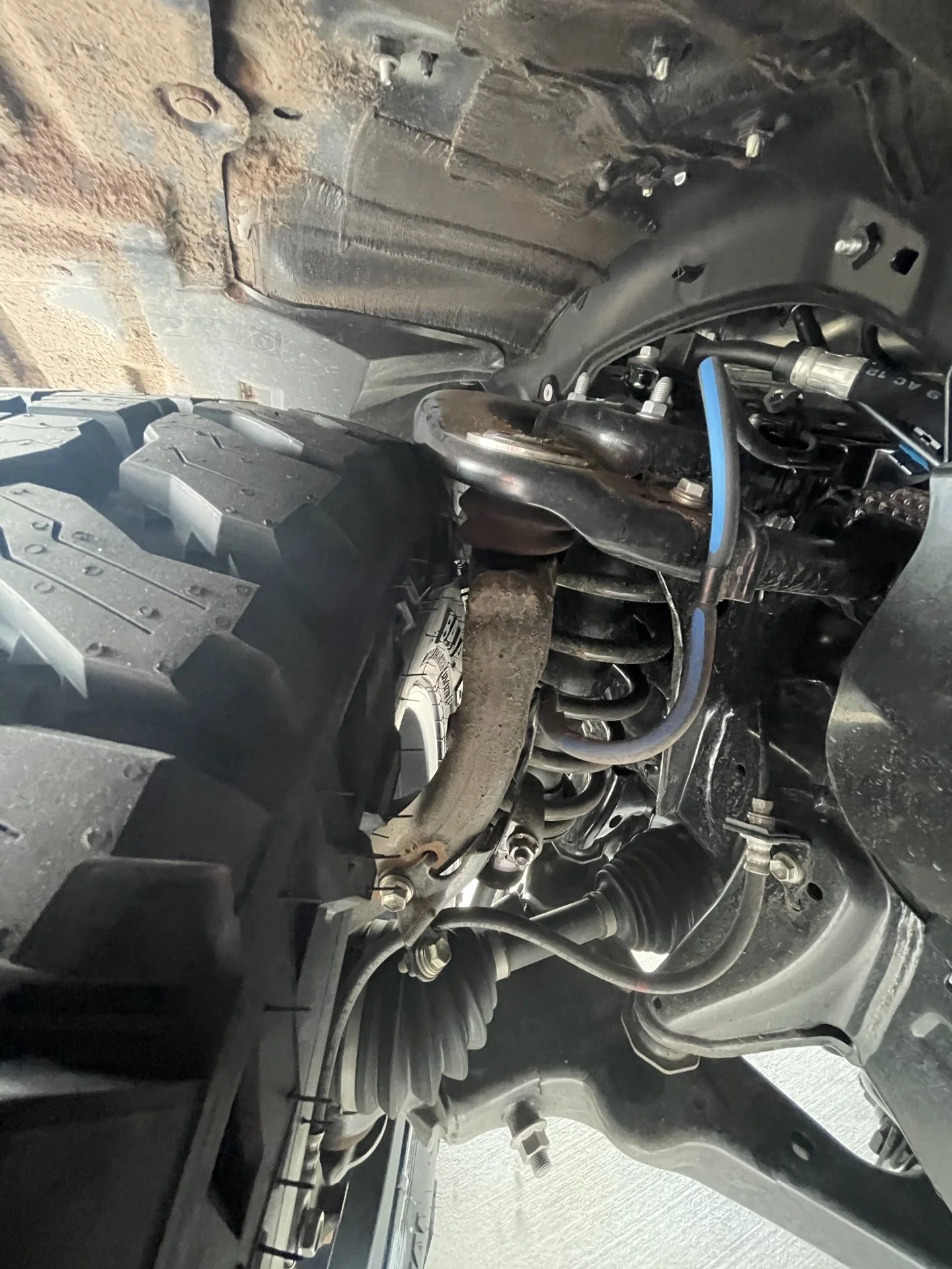

Damn sexy - what size tires did you go with?Finished product. Looks like I’ll be investing in some spacers. View attachment 2746796View attachment 2746797View attachment 2746798
285/65/18. I really wasn’t expecting there to be that much rubbing.Damn sexy - what size tires did you go with?

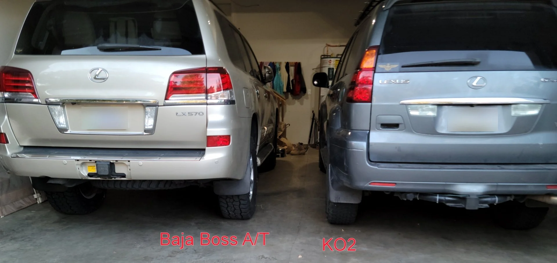

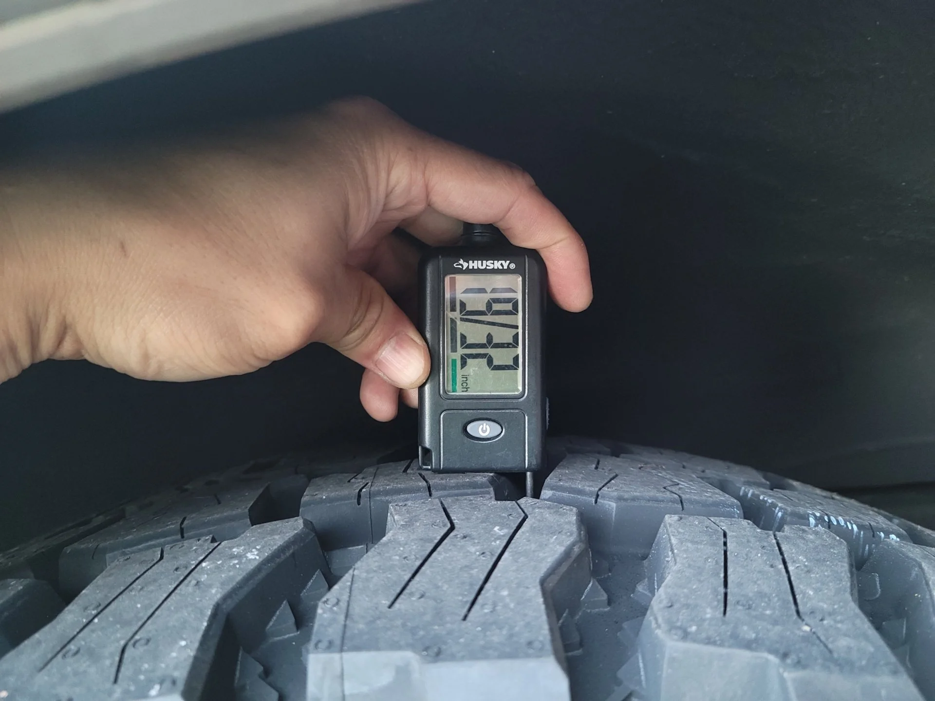

Went with basically the same set up but I’m bumping up against the UCA by a decent amount. Wondering if Lexus changed the UCA they are using somewhere along the way.33" ish is the largest tire you can go without rubbing/modification plus it will fit in the spare (which I think can take up to a 34" tire). I am currently running the new Mickey Thompson Baja Boss A/T in 285/65R18 on 18in Tundra wheels. These are 33.2in OD tires (with 19/32in deep threads) so it rubbed slightly on the front mudflaps on full lock. I modified the front mud flaps by bending the inner portion toward the frame by .5in to create a concave shape and now I have no rubbing at all. Alternative is to just remove the front mudflaps. Alignments are in spec as well. I am not running any spacers. The Tundra rim (426110C160) specs are 18" x 8" with an offset of 60mm. Noise level is probably the same as the KO2 and I can't really hear it when the windows are closed.
The Baja Boss A/T tires are more aggressive than the KO2 that I have on my 4Runner and GX. The sidewall grips are even more beefier. They are in between an A/T and M/T tire. They are not dedicated M/T like the KM3 though.

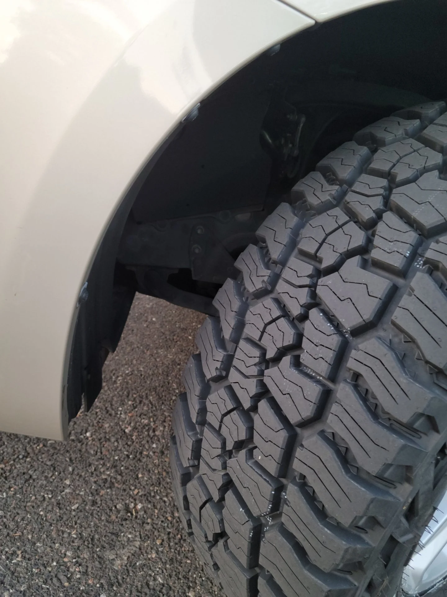

275/70/18 should clear your uca without spacers. If you went to Discoubt Tire, they have a really good return policy285/65/18. I really wasn’t expecting there to be that much rubbing.
Not sure. I looked at mine and I didn't have it rubbing like yours. I have a 2013. Maybe try a slight sensor lift to clear the UCA?Went with basically the same set up but I’m bumping up against the UCA by a decent amount. Wondering if Lexus changed the UCA they are using somewhere along the way.
Lift won’t allow for bigger tires on IFS. He’ll need a skinnier tire or spacers.Not sure. I looked at mine and I didn't have it rubbing like yours. I have a 2013. Maybe try a slight sensor lift to clear the UCA?
Any chance swapping out the UCA’s will help at all? I think I’d rather do that than add spacers.Lift won’t allow for bigger tires on IFS. He’ll need a skinnier tire or spacers.
Sadly, even with .25” spacers I am still rubbing. I’ve decided to purchase 275/70/18 Ko2s and sell the Baja Bosses.Finished product. Looks like I’ll be investing in some spacers. View attachment 2746796View attachment 2746797View attachment 2746798
