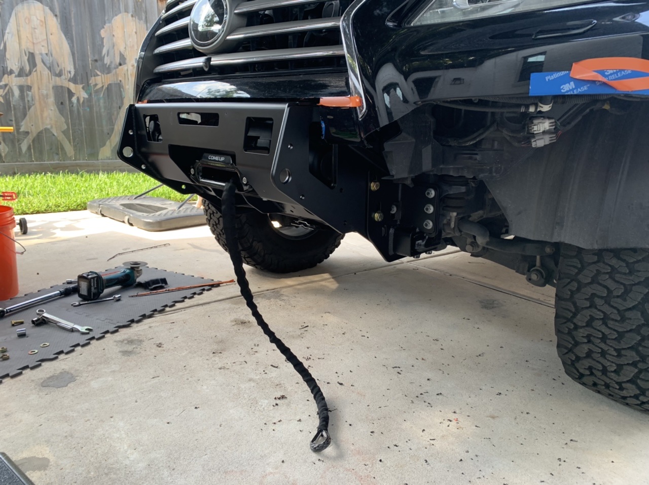

this is the old version - but yes, you could leave all the stock plastics in place and cut a notch out of the middle to make it look slick.
Thanks for this! This is exactly what I was wanting to know
