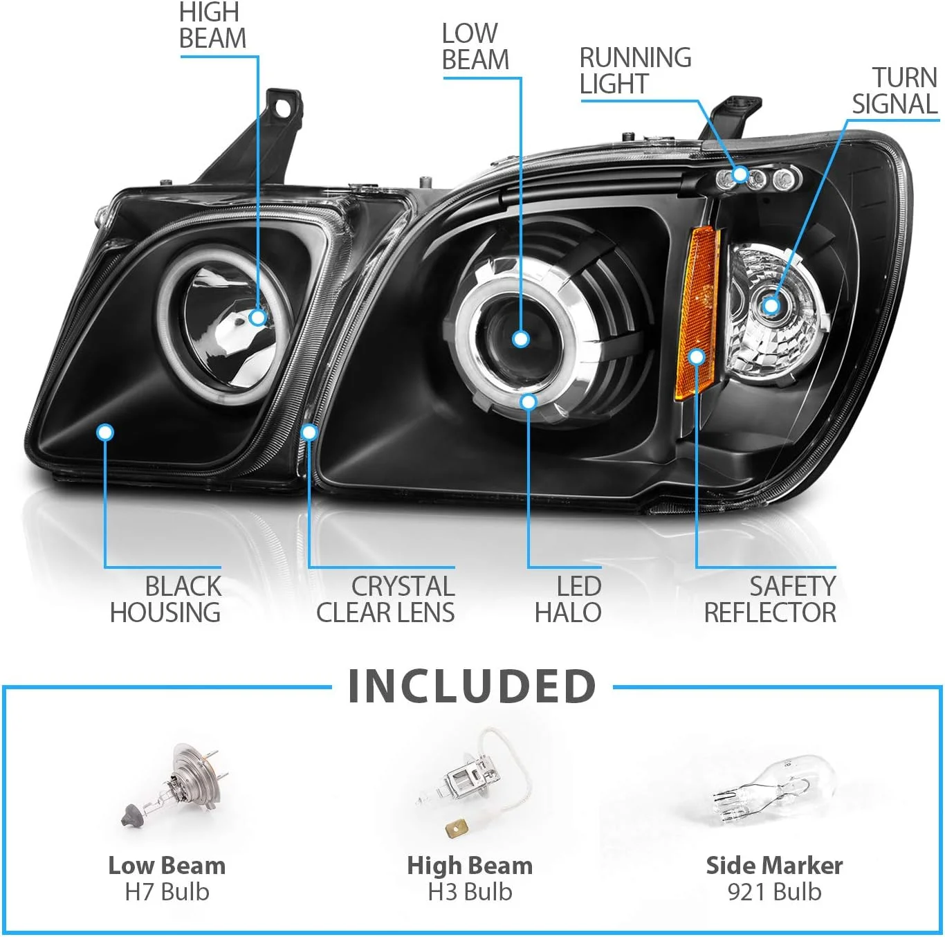

I'm thinking about installing a pair of Eagle Eye headlights in my 99 LX 470. I know that an OEM retrofit is the "right" way to go, but I really like the one piece headlight look and this seems to be the only real option for the 470.
In case anyone isn't familiar with these, these are available all over Amazon/Ebay/Alibaba etc and look like this:
After looking at a few threads and talking to someone with them installed, it seems like there are a few known issues with these:
  • Water can leak into the headlights
  • The wiring can degrade
  • The bulbs that come with the unit aren't great
I was thinking of making the following improvements to hopefully negate these issues:
  • Buying some replacement butyl sealant and resealing the headlights (these are oven-safe, right?)
  • Wrapping any wires in automotive-grade anti rat electrical tape and double checking everything when they're opened
  • Upgrading the low beam and high beam bulbs
  • Headlight PPF
Is this a terrible idea? Any other improvements I'm missing out on?
Advice greatly appreciated.

The vehicle I purchased (and since sold) came with these one piece and I hated them. Not for the looks -- although I didn't like the look, either -- but the lighting itself was really bad. Driving into campsites at night was really difficult. Maybe it was just the PO of mine that didn't have them set up right but they had a short throw and had an area in front they didn't illuminate at all.
I since sold the car, but I had spent 800 dollars buying replacement glass assemblies (that I now need to sell) because I considered it a safety issue. Hopefully mine were just set up wrong, so just providing one data point. The adjustment locations were very poorly thought out so u could only do so by removing the light entirely, which was not something I wanted to deal with.
My LX had a set of these on when I got it. Absolutely horrible light output. Beyond that, in my opinion they looked and felt very cheap. They would never be something I would want to spend time or money into "improving". I would vote that they are not worth fixing the known flaws.
If you're dead-set on them because you like the way they look though, then have at it. For potential future owner(s) of your vehicle though, keep the stock ones handy.
I installed some Eagle Eyes on my Highlander. I'd say you will get exactly what you're expecting. It lacks high end quality, and felt cheap all around, but it fit in the position of the OEM headlights and when I turn my headlight switch on, light comes out of them lol so overall mission accomplished . I would not have installed them on my cruiser but it really all depends on you, and what purpose your truck is serving for you.

I saw in one example a few years ago that someone managed to hack a couple of the cheap plastic housing to retrofit higher out put bulbs and within a few weeks they had actually melted the housings. This was because the plastic was so thin.

In my defense, they look closer to OE in chrome, which is what I’d get. The black background ones look bad and the smoked out chrome doesn’t make sense unless your whole build is murdered out. I just used the first image in the Amazon listing in the post.

If your clips are good on your side light assemblies it should sit very tightly against the headlight assembly. There really shouldn't be a gap. There isn't a gap on mine at all.
Opinions are like a**holes, everyone has one. I was once in your position, no one likes it on MUD, everyone hates the Eagle Eye Taiwanese headlights. I had them, they weren't too bad, but definitely could be a lot brighter. I think you posted in the other thread I started, right?
Anyhow, mine never had condensation, nothing degraded on them. If you want to be extra safe about it, I would just glob silicone around the seals.
It was OK. I recently got retrofits via Teqcustoms and it's definitely brighter. I still need to make some adjustments to have driver/passenger match up. But yea there is definitely no other option other than these two. Good luck!
I’ve had Anzos from Jeg’s for like 4 years. They’ve been fine.
If you try and bake open the headlights there’s a good chance they won’t come apart easily. A lot of the after market headlights now use a different type sealant making it very difficult to disassemble
