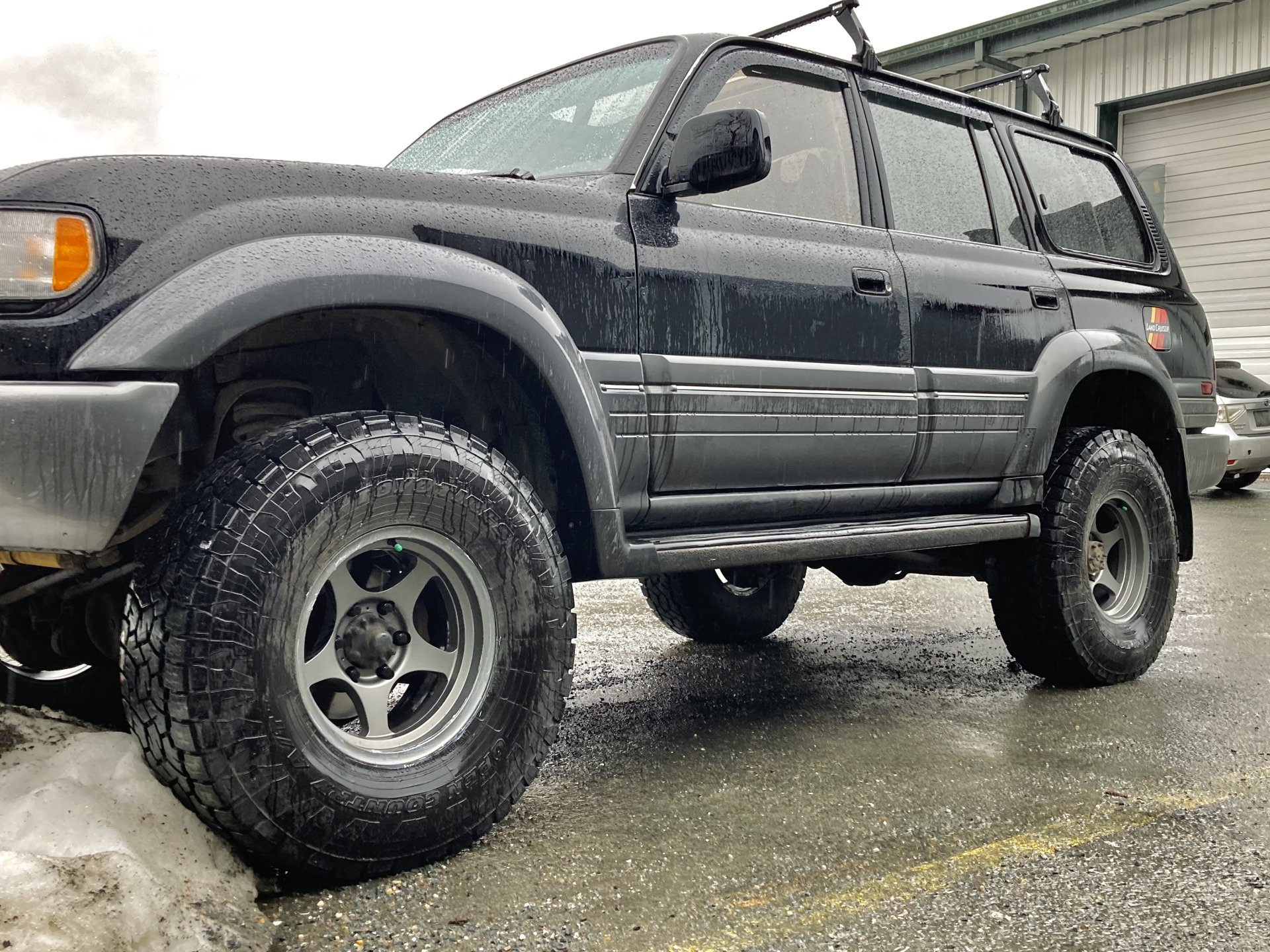

Hate to bump this for something I have saved, but wanted to be sure. Scored some FN 5-star wheels which are conical, but don’t have steel inserts like OEM. In the above lists of year/wheel/nut type, there isn’t one for late 80 series, alloy wheel, conical nut. Am I correct that I would still go 109 without inserts? Or simply put, is the only time you go 76 for shank nuts?
All conical nuts go to 109 steel and alloy.
Only shank style go to 76.
I have both shank and conical on my truck so I adjust torque based on lug nuts on each wheel.
Same with mine, currently. Just didn’t know if it made a difference not having inserts - thanks

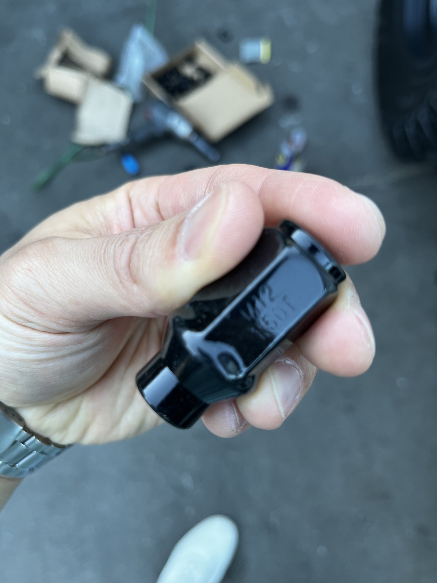

There seems to be something else to this lug-nut torque business than just conical vs shank style.

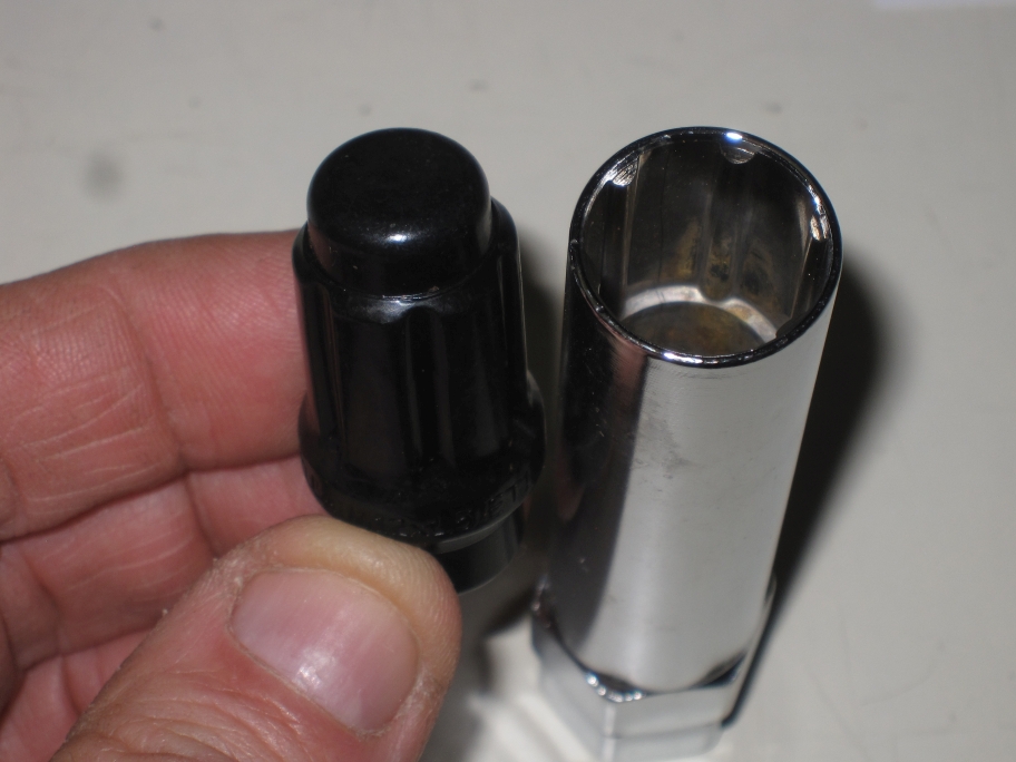

Like @SpenserAK - I just got some new FN wheels - in my case, they are called "Six-Shooter", but came with a full set of the same type of lug-nuts.
These lug-nuts are from Gorilla-Auto.com, 60 degree conical seat, cold-forged and (black) chrome plated, small diameter, spline-keyed units that fit our M12x1.5 wheel studs.
Gorilla's torque vs stud size table gives a torque range of 75-85 ft-lbs, which is more similar to the traditional Toyota washered shank spec of 76.
