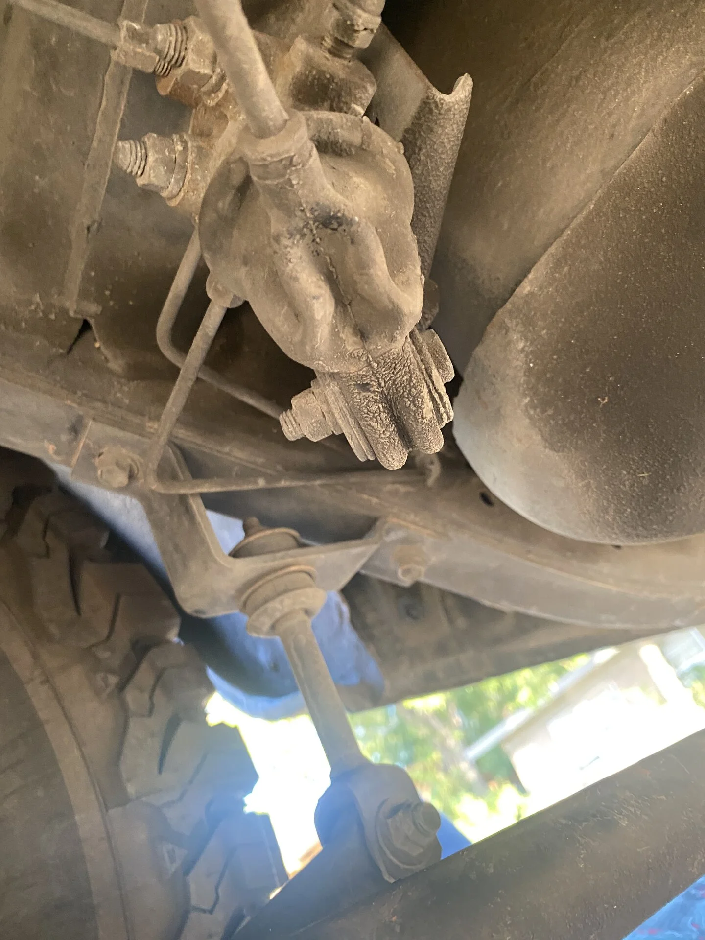

I’ve recently started having a weird brake fade situation that occurs intermittently on hot days, which has me preparing for a brake flush as the old stuff looks pretty black and contaminated, as well as the replacement of rubber hoses to refresh the system a bit.

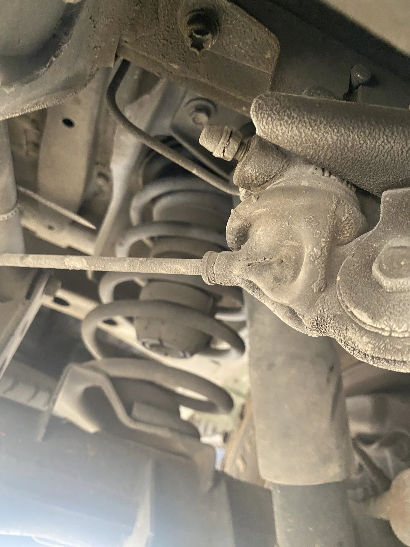

I’ve sprayed some PB Blaster on the bleeders to prepare as well, but upon the inspection before preparation, I noticed that my LSPV boot is looking kinda sucked in. I’ve googled photos and everyone’s looks pretty round and supple, which leads me to believe either something is up with mine………. Or something is up with mine.
I’ve tried searching for similar cases, but can only find posts of leaky ones. Anyone have any idea what could be up with mine?
I appreciate any info and time you guys can spare and hopefully can get this figured out because I’ve had a few scares where the brakes just lose all pressure, as if the brake fluid gets too hot, or the lspv is trying balance the braking when I have a tired suspension with an ARB bar in front and 33” tires.

Did you try simply letting some air in along the rod to see if it would re-inflate and look normal?
I'm no expert, but I did replace my LSPV last weekend... with help from folks on here on MUD. And yes I tore my boot like many others.
honestly, this is my first time I’ve done anything brake fluid related as I want to learn more about my cruiser, but I’ll look into that! Thanks for the reply!
Oh man! So if I just bleed it as normal, it may not reinflate, but it’s all good?
I’m just trying to get my brakes feeling safe again. 😰
Bleeding the brakes will have no impact on that rubber boot. It's an external protective cover to keep dust and mud etc out of moving parts. It's important for that function, but had no direct effect on braking.
If it was full of fluid, hitting the brakes would blow it up like a balloon

Tire size has no impact on the LSPV position, only lift, or cargo load.
If you have stock suspension, I'd leave it alone, don't try to adjust the LSPV.

edit:when Slee did my 3" lift they bent the LSVP rod down in the middle about 1 - 1.5"s. Works fine best I can tell.

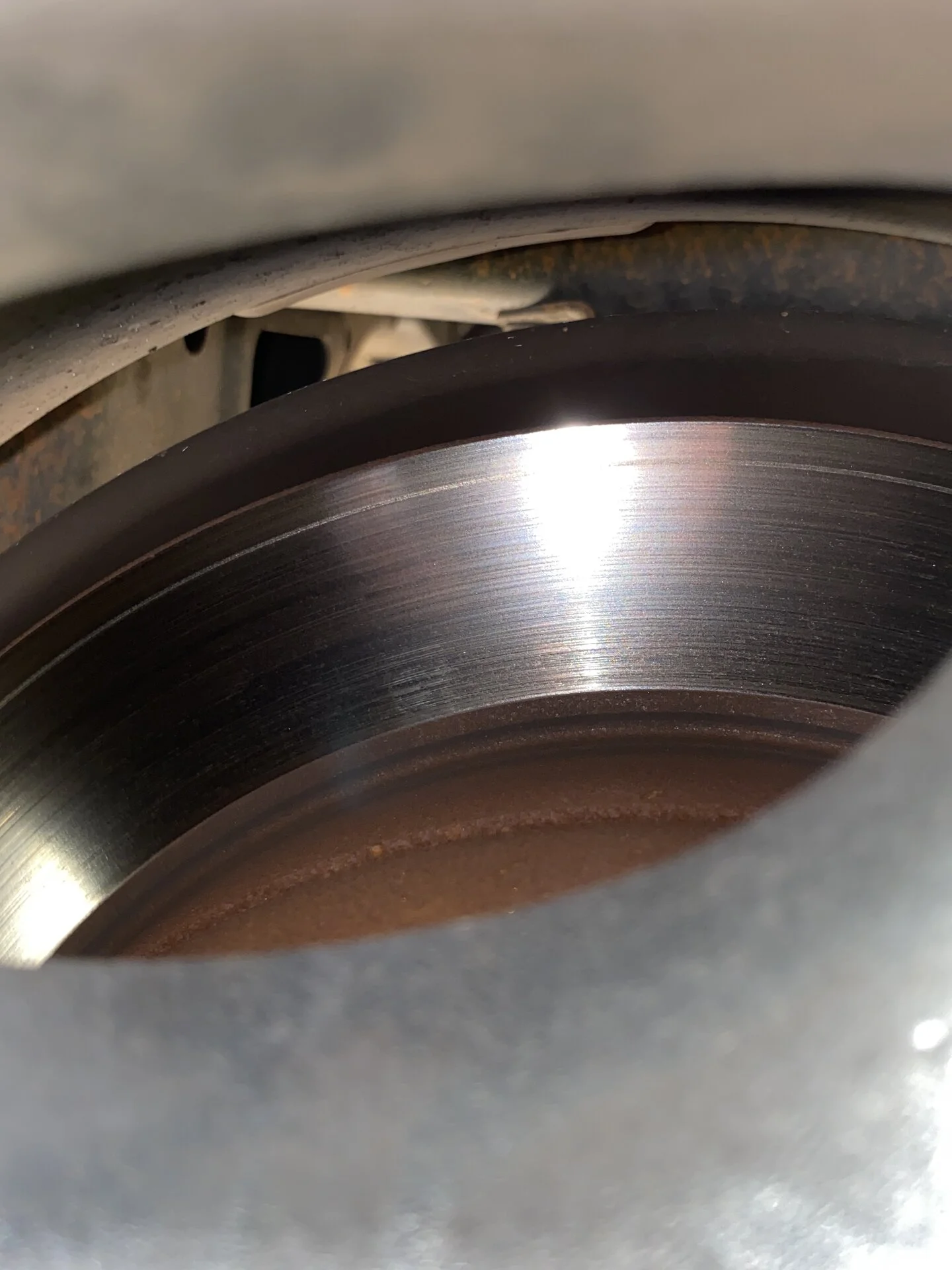

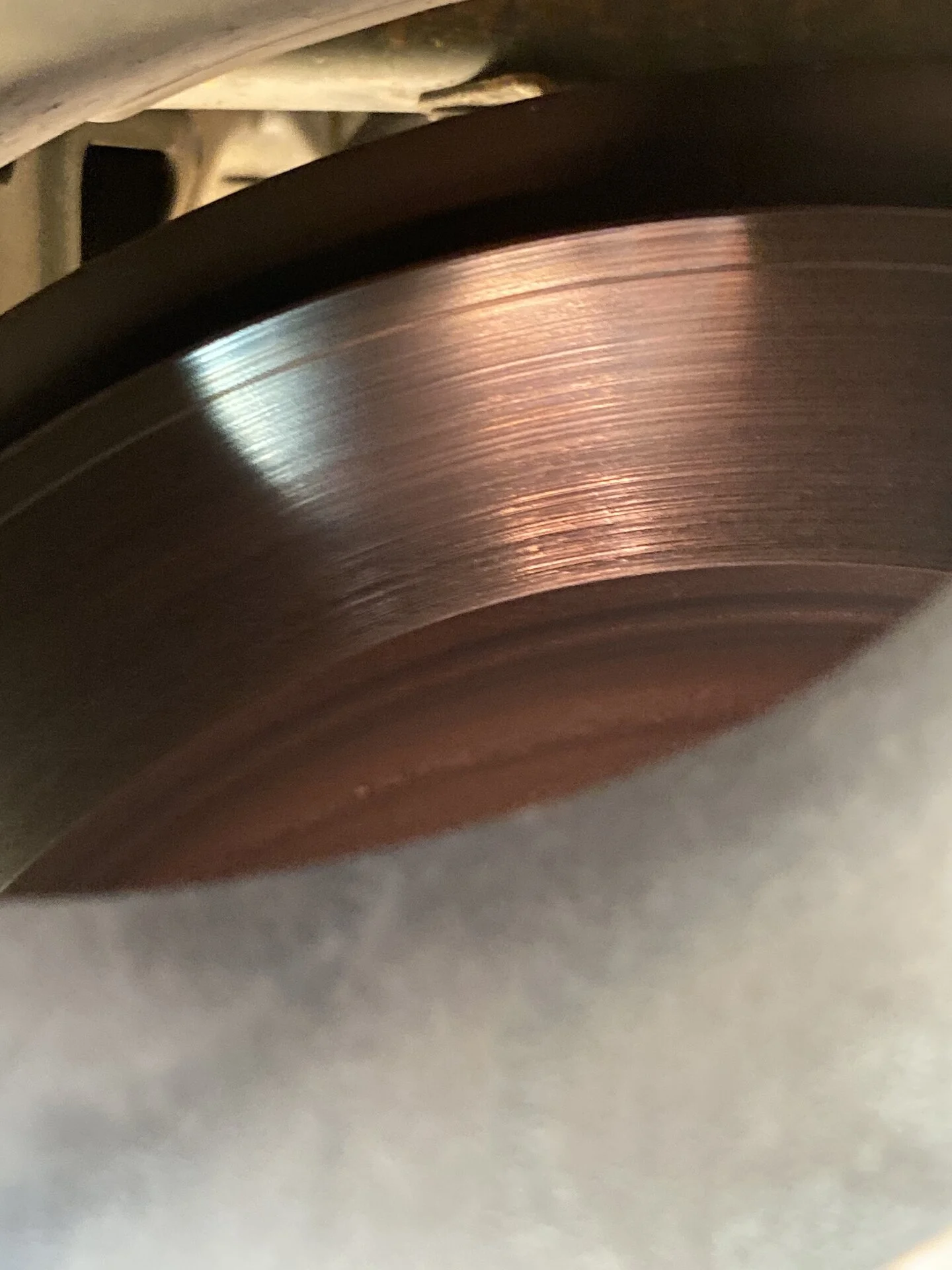

I’ve checked the rotors out and the rear passenger rotor has a gouge. I replaced the brakes and rotors about a year ago and have driven it a total of 13k miles.
I’ll probably investigate that rotor and pads next, but this Texas heat makes everything troublesome. Lol
