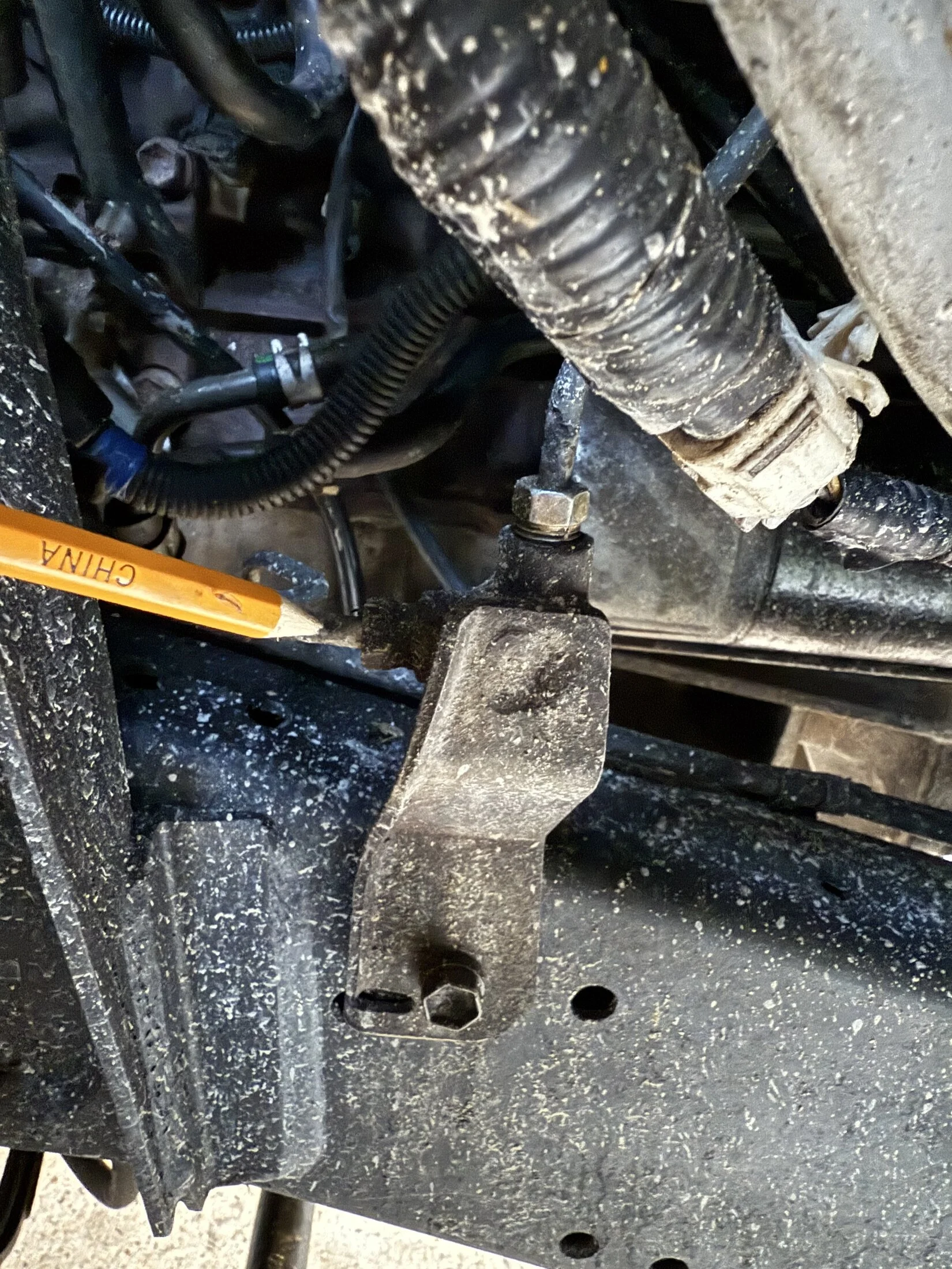

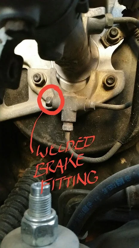

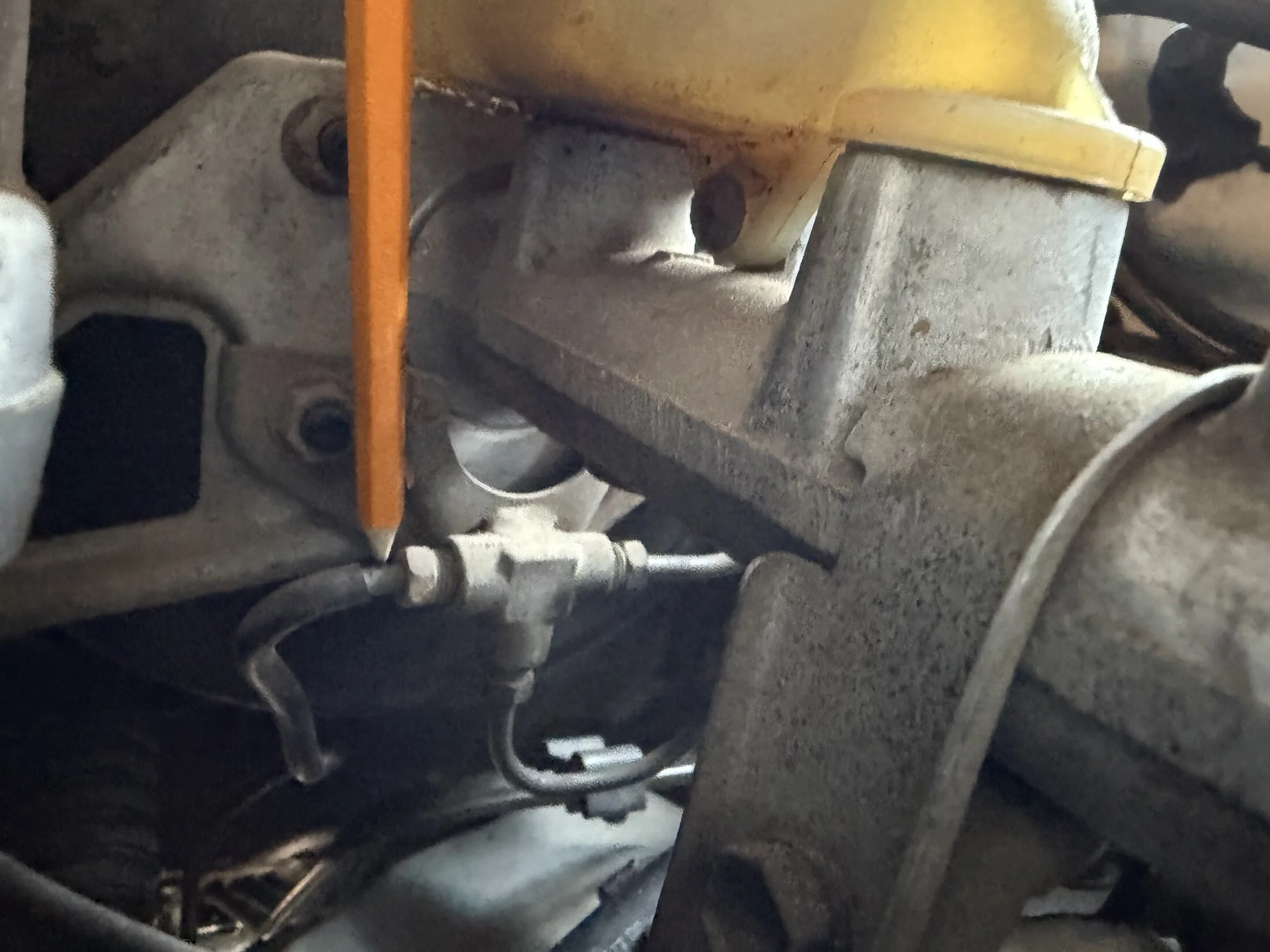

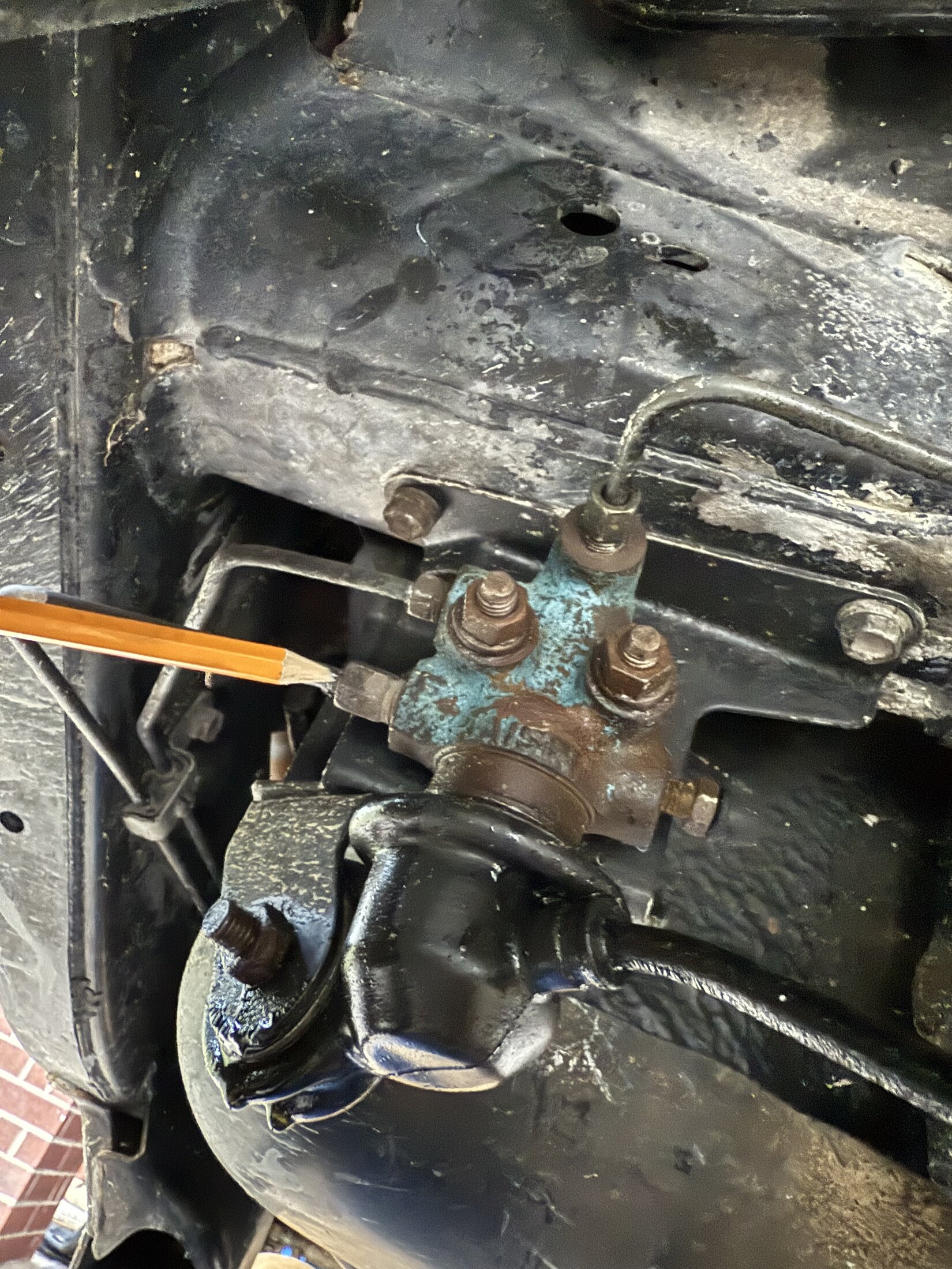

I need to delete my LSPV but not my ABS. I have the wilwood valve and some plugs. But I just want to be sure which line to unplug and plug at master area. I assume it’s a “return” line and not the primary rear from the ABS? And it connects the the rear passenger side of the tee under master cylinder via the elbow connection down by the shock tower and frame? And it’s the lower of the paired connections at the LSPV? Thanks!!

Welded Brake Fitting.
Yeap, your pictures look correct. You will need to test the manual proportioning valve. I marked the "W" with fingernail polish on mine so I could count the number of rotations. Full open is a bad idea.
Thanks! I’ll try to knock it out in the morning. I’ll def do the dirt road test and dial in of the rears. I have all new brake gear front and back so I need to learn its behavior. I tried to rebuild the LSPV but it quickly blew out the piston again. Too pitted from corrosion. So going this route.
