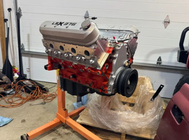

I was looking at those as an option to replace the tired L92 (Aluminum 6.2 Truck motor) in my 80 Series. Originally I wanted to rebuild the 6.2, but for the price, I was nearly at a new engine.
I decided against an LS3 because I want to run regular fuel. I frequently travel to places that don't have Premium available. Basically I wanted a torquey engine that would spin at ~1600 RPM all day hauling a heavy cruiser with a trailer across the country. It had to run on cheap, s***ty fuel and last for the next 200k miles.
I ended up buying an LSX376-B8 crate engine. It's an LSX Bowtie iron block with 9.0:1 compression and an LS3 cam. I'm running it with the L92 truck accessories. Cost was $8k with a two year GM warranty, linked to my 80 Series.
The power level is more than I had with the L92 everywhere in the curve. It's really a perfect powerplant that runs on 87 octane with no hint of knock.
Looks sexy when you see past the truck accessories too.

The problem with the LS3 (and L92 Truck engines) is that it's a 10.5:1 compression, flat top piston engine. Even with a tune to compensate, Knock was always present in high load conditions (Towing uphill for example). The ECU would compensate, but the abrupt loss in timing made driving very uncomfortable.
Leaving a few HP on the table for a rock solid, "lazy" engine was well worth it for me.
-Rob
