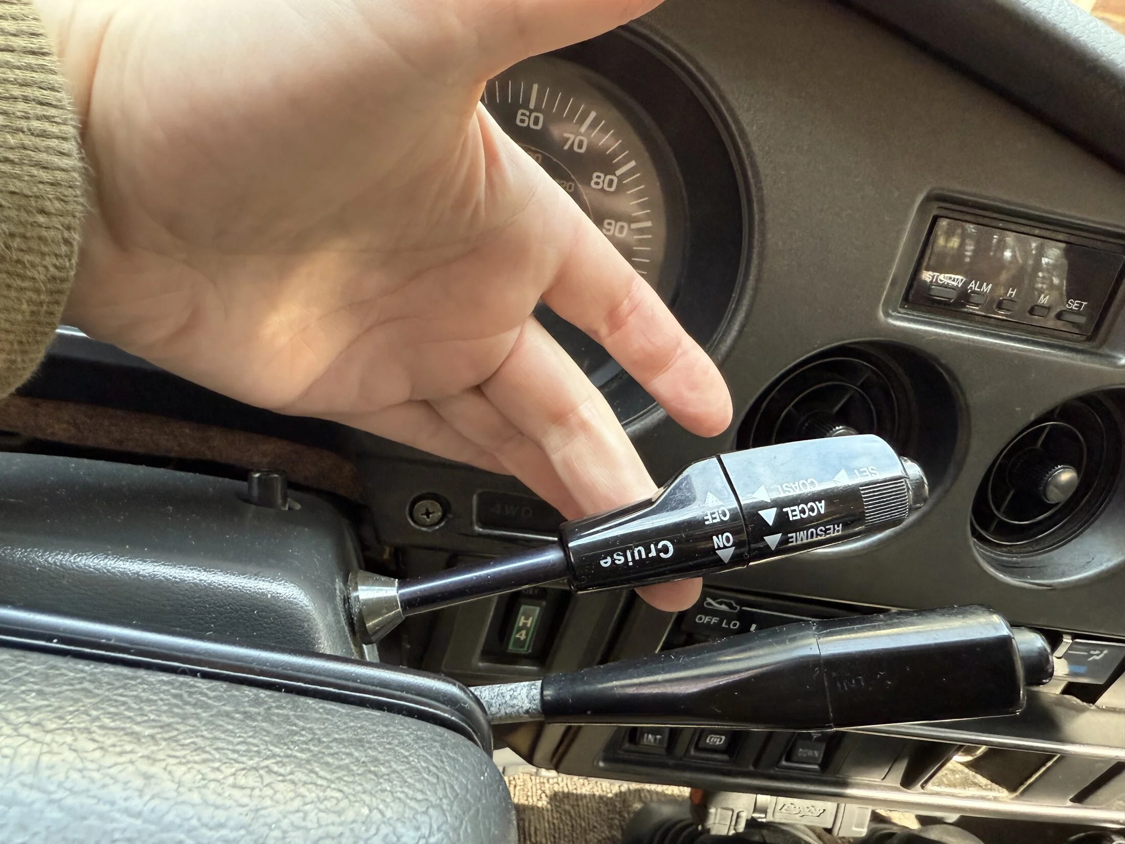

Anyone have any insight on this cruise control stick ??

Well. I'm 99.9% sure it's not stock. But would love to get more information if you have it.

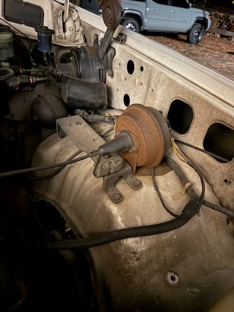

No idea who or what the manufacturer would be. Any type of manuals are long gone. Yes that goes with it the cable end goes to the throttle one vacuum line goes to a main vacuum port needs a tach signal should be the vacuum part a module in the cab and the stalk on the column.
Ok. Going to follow the cables and vacuum lines. Any idea who made them in the past? I may try to hunt down manuals on the interwebs.
The stalk was just hanging there, but opened the clam shell and tightened it down. I'd like to get it working or remove it all together.

Trying to remember who the manufacturer was back then. Pretty generic and never installed anything on the driveshaft. If I remember correctly power ground ignition power tach wire brake signal wire then the components that other plastic ball might go along with it.
It might be easier to install a new Rostra Universal kit vs resurrecting your old one
You would need all new components, but the universal kit is pretty straight forward to install. Quite a few of these being used on 70 series. An example of a one of their controllers, others are on the site:

whoever installed your unit put the stalk on the wrong side of the column, mine is on the left side and all the script is right side up.
it is not a stock item.

Yeah. It made me laugh. If I can get it to work, I will just make it work. If I switch to Rostra, I will get an actual right side stalk.
I've been reading up on these systems. Even if I can get it to "work", I'm sure it's designed for an automatic transmission. My truck was swapped to the H55F a couple of year ago and I'm doubtful I can figure out how to introduce a clutch safety switch into the old system. So, I'm going to remove it all together. If anyone wants the parts, I'll gladly send them if you pay shipping.
