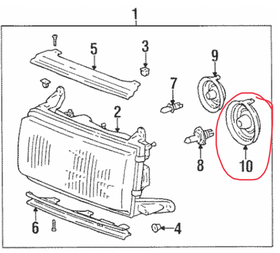

Attempting to replace the halogen bulbs and discovered the low beam (LH) just floating as the housing its supposed to rotate into all chewed up and incapable of holding the bulb anymore. As such I took to the internet to source the part. P/N: 81145 however, as many of you know, the part is discontinued on many sites I’ve tried or I’m having bad luck finding it.
Added the image to denote specifically which part I need.
Any guidance you all can offer I appreciate.

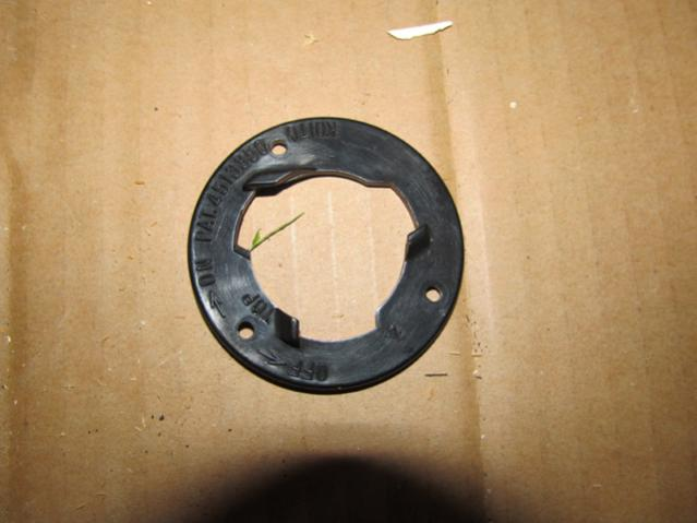

The part you have circled (90075-99027) is not the bulb holder ring. That is the rubber cover seal. The notched ring that the bulb rotates into and locks is held in place with 3 small phillips screws and is not available as a separate part.
However, there are likely lots of headlights available with broken mounting tabs that you can pick up for a song in the classifieds section.
Below is the image of the part you're looking for that I poached from an earlier thread by @TomH in 2014:
