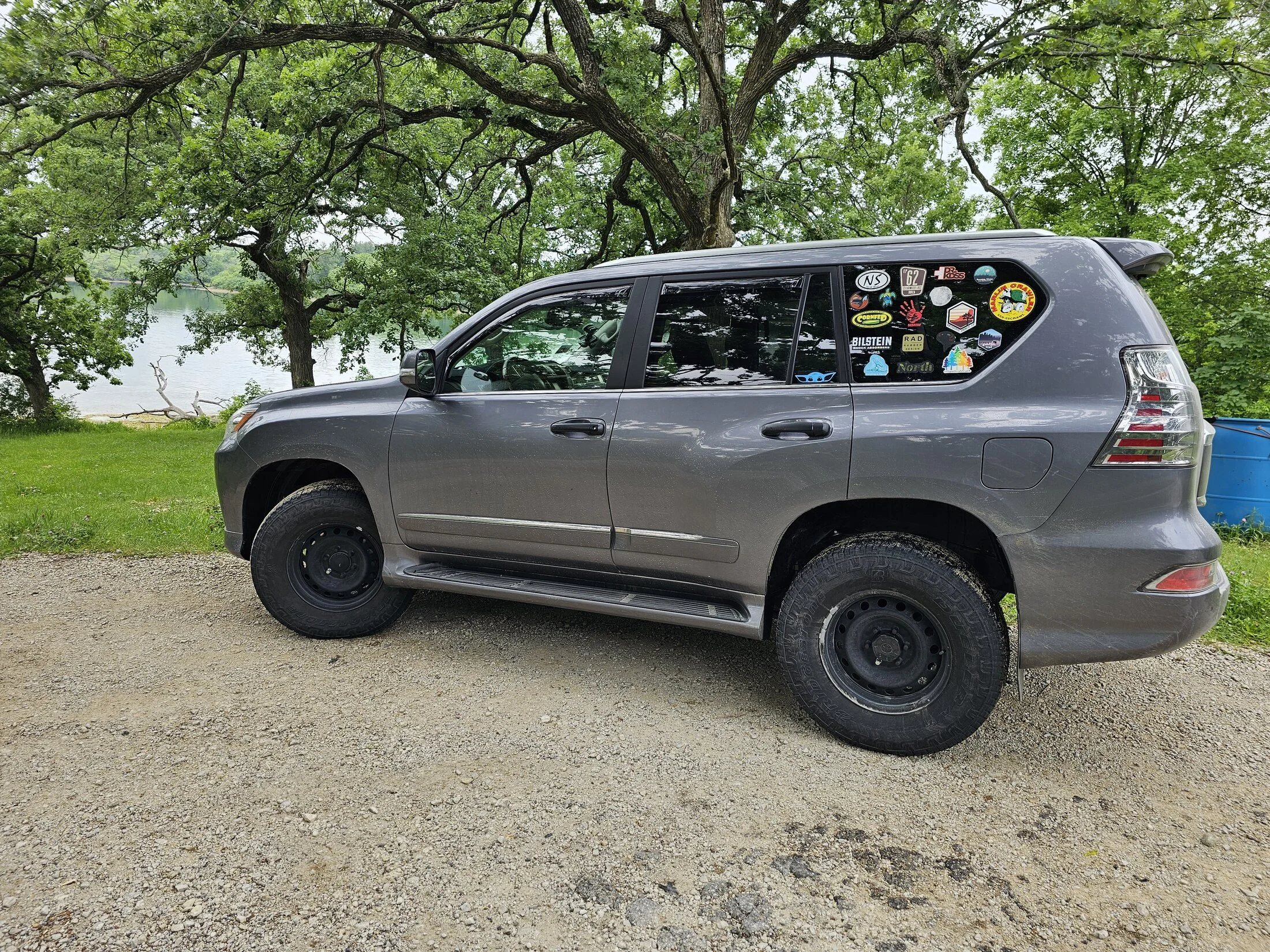

Thanks, my Toyota parts shop didn't know offset/spec for FJ steelies and thought it was a 4.5" backspace. If I understand correctly from elsewhere on this site and your experience, FJ steelies will still fit around the OEM brakes, calipers, etc. no problem, but with +15mm offset the outside of the wheel/tire will be tucked in even more than the OEM 18" wheels? The online offset calculator tells me my wheels are going to be about a half inch closer (.2" on each side) but does not account for backspace....or scrub radius for that matter.
The only other wheel I've looked at is the AEV Salta, which is a 17"x8.5" wheel, so an inch wider, with +5mm offset and 4.93" backspacing. It is roughly twice as expensive as the FJ steelies and fancier than I need for winter-only wheels. I'd prefer not to use spacers, I swap my wheels for winter/summer in Oct and May on all my trucks. Maybe I'm missing something.
You can buy them from ebay. I got five for 80$ ea shipped 3 years ago and 4 for the 4Runner for about 90$ ea shipped about a year ago.
I've run 33x10.5 Goodyear MTRs and LT285/70R17 Revos, both fit with minimal rubbing after doing all the things one must do to run 33s. No BMC.
They have higher offset but are narrower, so they'll sit about the same. OEM is 18x8.5 +25 and the FJ steelies are 17x7.5+15.
Hiluxforever has a full set, but I have one as my spare. You can kinda see how they sit against a 17x8.5-10 here, but these are also 285/70/17s.
They are 28 lbs. So heavier than alloys but not by as much as I was expecting. With the Revos it rides like a camry.

1000mi review: I've been using FJ Steelies w/Toyota center caps and studded Nokian Hakkapeliitta 10 SUV 265/70r17 for ~1000mi now in winter conditions and they are working with no issues.
MPG might be a tad lower than my OEM setup, tough to tell with winds and highly variable surface. I had them mounted/balanced at a local shop. Used Gorilla spline acorn lugnuts in black M12 x 1.5 which were simple and inexpensive. NOTE: The spare is still an OEM wheel so I keep 6x OEM flat lug nuts in the vehicle kit if I have to change a wheel. The steelies & slightly larger tires function well, I like having more sidewall and do not need the bling/cool appearance of OEM wheel so I might just switch all wheels incl. spare to these FJ wheels.
