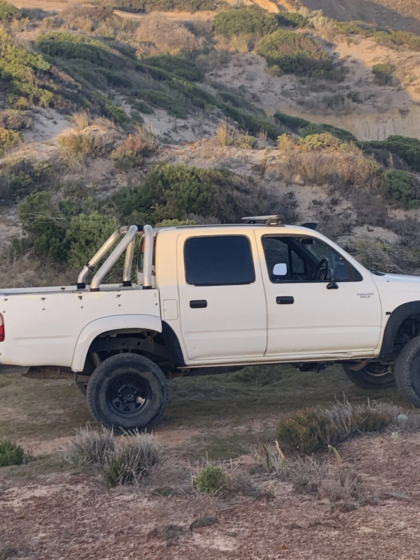

I’ve owned my hilux for 4 years it has the 5 l engine with a aftermarket hi flow turbo system on it my maintenance schedule is every 5000 oil filter fuel filter oil change check the belts and i grease everything underneath I brought my manual from be Haynes I found the best only problem I have had is the alternator I’ve replaced it twice in four years that was due to previous owner installing a amp apparently to auto electrician amp was draining battery upgrades i recommend dual battery system and get ur engine injectors checked in diagnostic system other than that I’m quite happy with my Hilux
