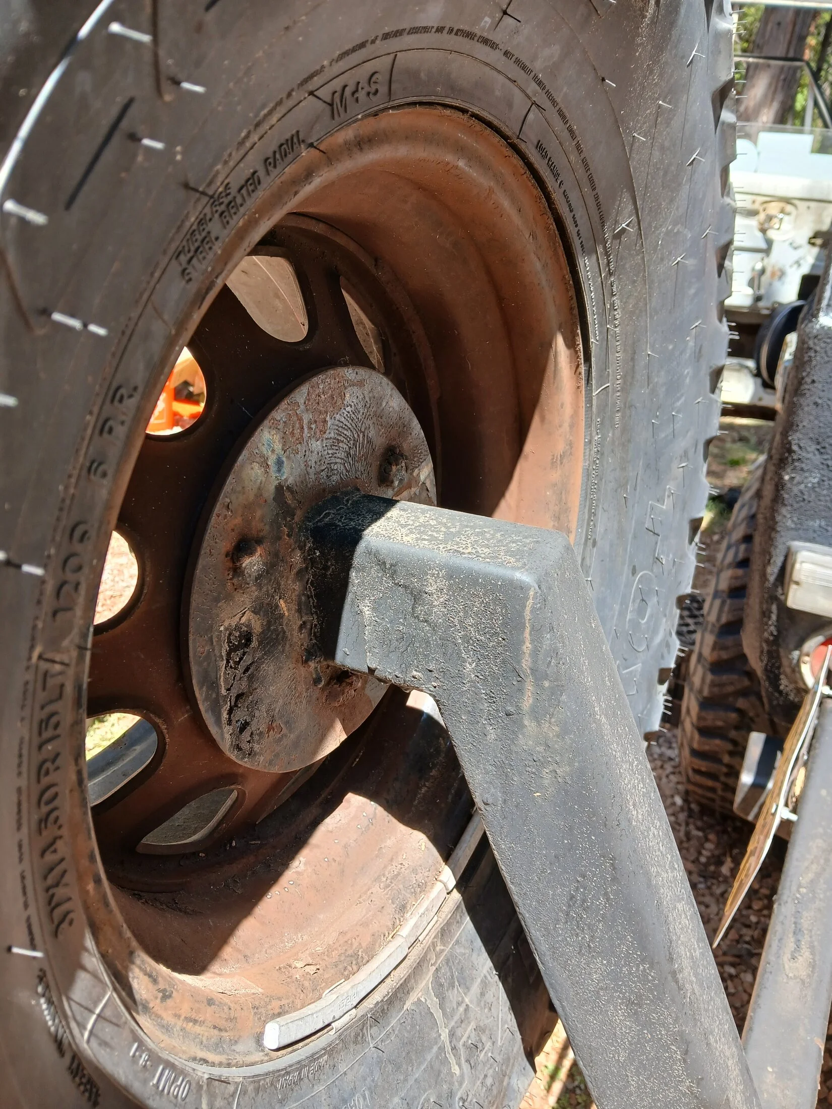

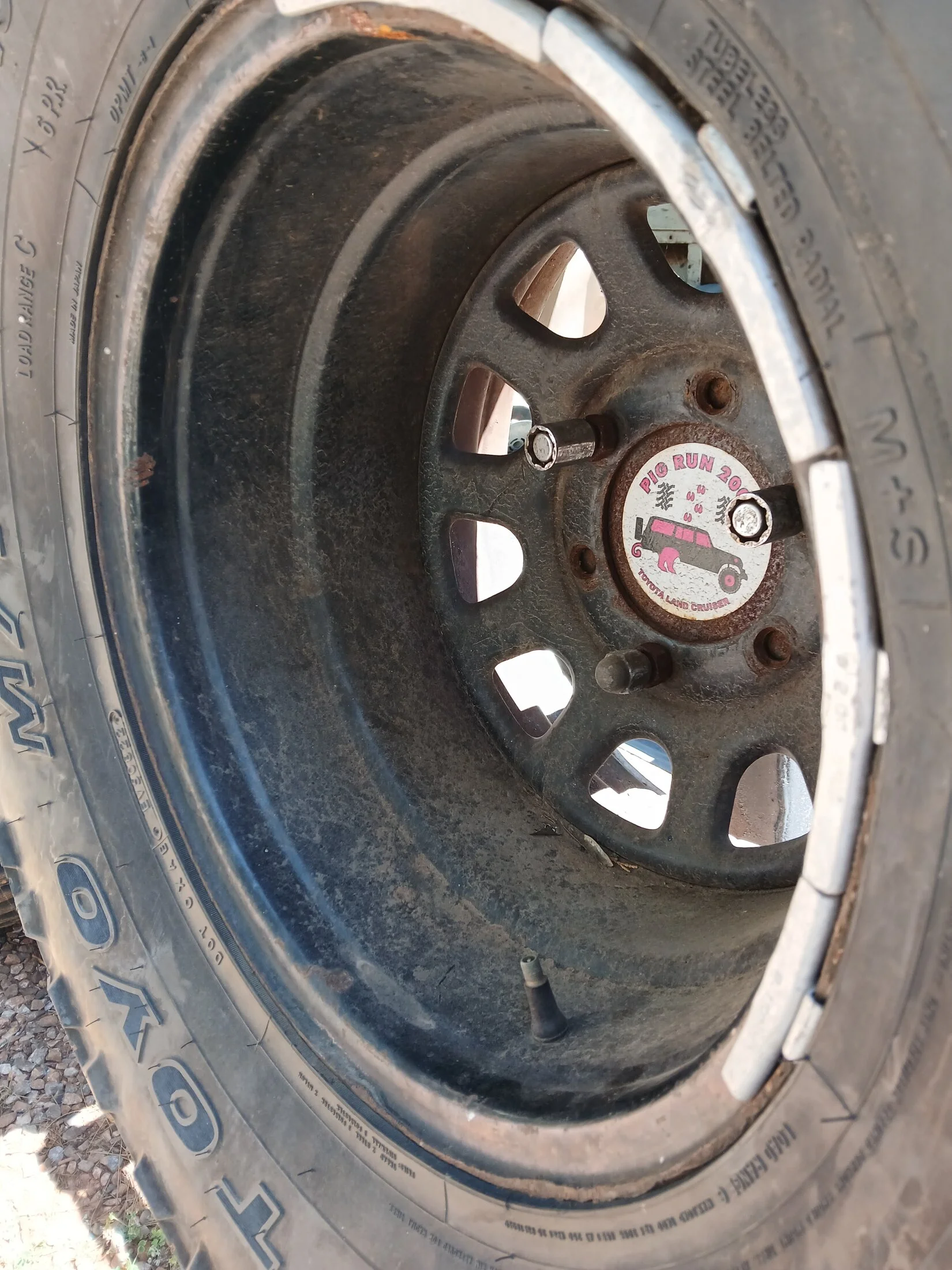

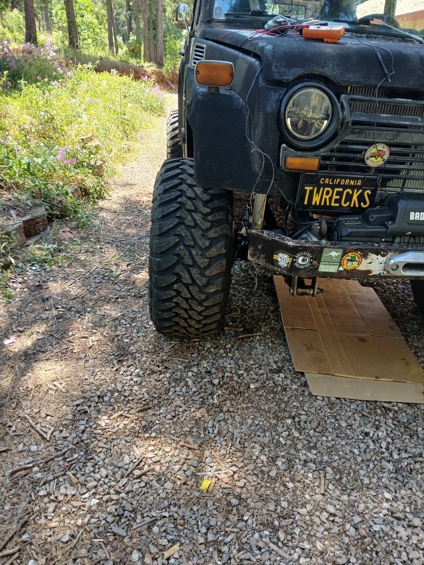

Pretty much what I'm running. 15x12ish with a 2" backspace. Custom made by Stockton Wheel about 25 years ago
US Wheels use to offer custom backspacing. Mine were shipped unfinished, 15x8 with 2.5” BS.
It's great to see one of my pig run stickers still out in the wild!
