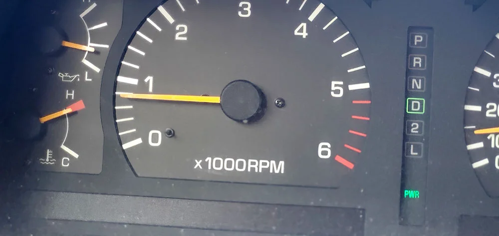

Regarding the engine temperature, please see the attached photo as one example of my engine running HOT.
