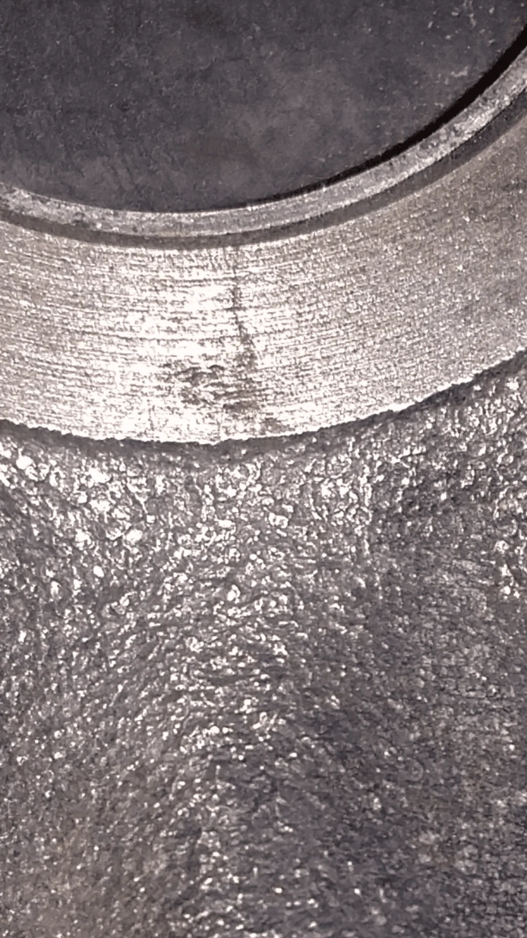

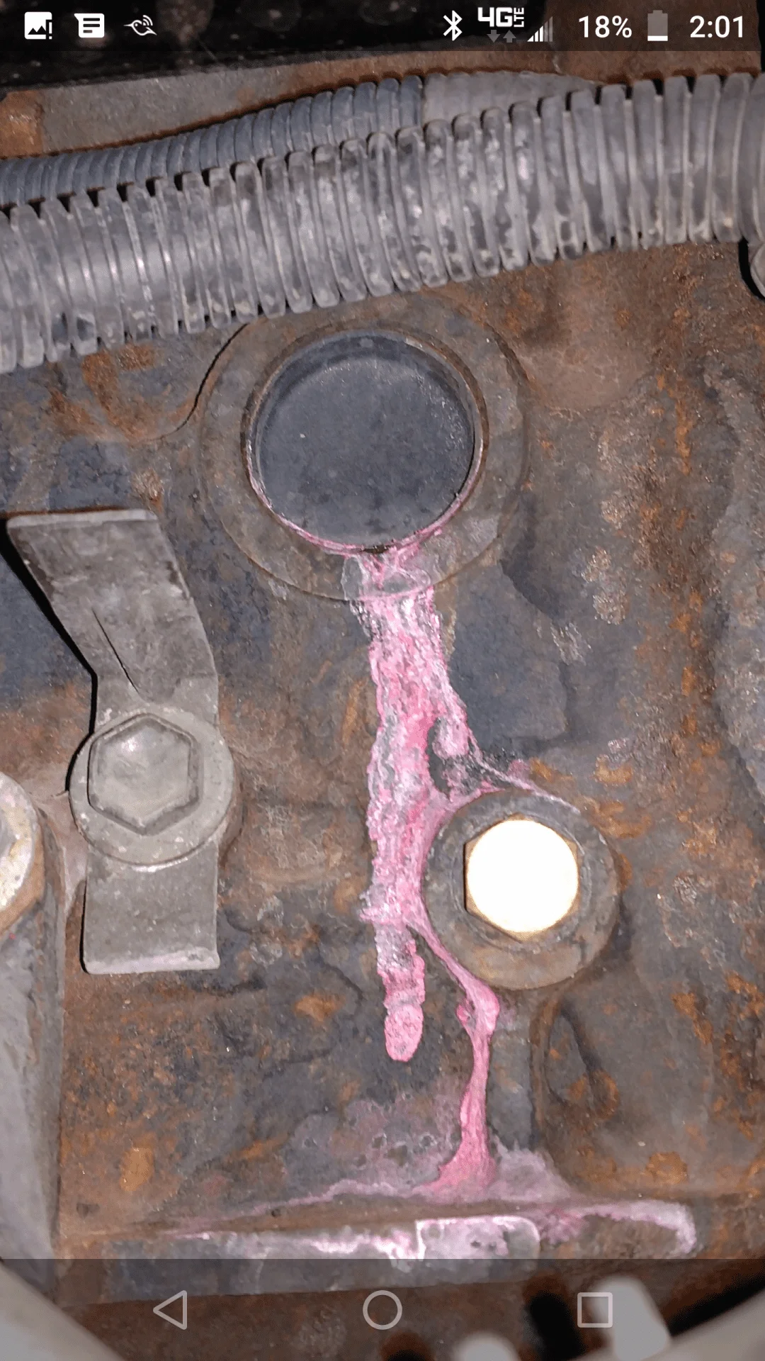

Found this hairline crack a few days ago, zero leakage since. However, I assume the block is done?
Had her 1 year, PO was awesome and honest about blowing the PHH and over heating.
Considering a factory short block when the time comes, my plan is to run her for a while and monitor, good plan???

I'm going to monitor that hairline crack, a few friends have suggested Lock & stitch but with 300K and not knowing the engines previous history I'm thinking a short block is the way to go, and now a brass radiator that sounds awesome.
Thoughts?

If it were my engine block with this issue, I would drain the block, remove the core plug, then with Scotch Brite and or emery cloth, I would clean the area well inside and out in the crack location. I would the coat the inside of the crack with Permatex #2 form-a-gasket sealer, pushing it into the crack area to make sure it was into the crack. I would also coat the outside of the crack in the same manner. I would then coat the inside of the hole as well as the outside of the new core plug, and tap in the new core plug. Let it cure for about 4 hours, then introduce coolant into the system.

Some have suggested Cracked Block 1FZ-FE bars stop leak. Im not knowlegebale in bottle repair though i have heard many great success stories.
I would like to keep driving and enjoying her until the engine is done, and i hope the crack doesn't migrate of catastrophically fail in the process.
Has anyone heard this common crack is a death sentence?
Does anyone know is this crack common on the 1fz?
Do they tend to grow?
When i found this rust free, spent its life in a California desert environment beautiful example of an 80 with 300k (of course she needed work) the PO was open and honest about the PHH going on a hot day in august of 2017 and her over heating. I knew this probably meant i would need major engine work down the road. However, when i got her and did a complete cooling system refresh including every hose on the 80, along with everything on MUD i could find to PM i was blown away with the compression numbers which gave me hope she was better off than i thought.
If anyone thinks this is a bad idea please chime in and i may just get a factory short block and get the head redone. I am between Sacramento and San Francisco, i have heard good things about Valley Hybrids (George) and Yota 1 (Nick) for engine machine work for the head or to just bring the truck to them. Any other suggestions on people in the area?

There have not been any "catastrophic failures" from what I have read on here, but I have seen a few of these cracked block threads.
I would follow what I suggested first and see how it plays out before I would do the Bars Leaks. If it starts weeping, then do the bottle of Bars-Leaks.
I would absolutely use Bars Leaks brand based on something I saw first-hand.

Thanks, I'll work on him painting a freeze plug from the dealer.
