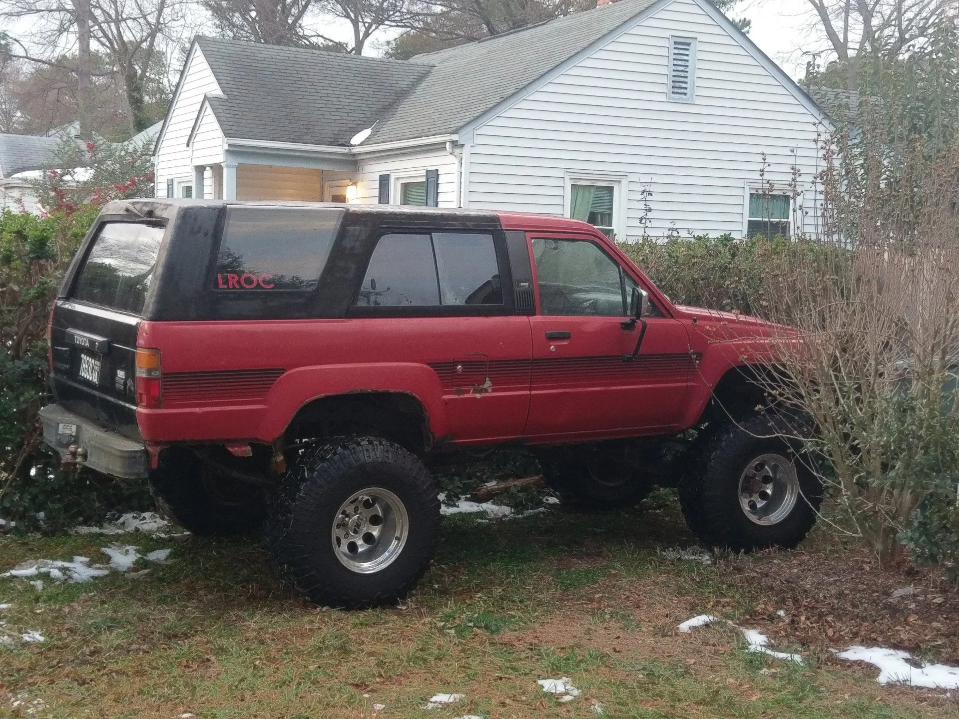

I had my heart set on an FJ80 for rock crawler build that can accommodate my growing family (1st in the way) , but I stumbled upon a 1986 1st gen that's got a Bolt on SAS kit, geared and lockers. The price is right but I have some concerns.
1. I've never wheeled or owned a leaf sprung front end truck or SUV and the ride was bumpy! I know it's not my sequoia but there were frozen ruts from snow melt and it was so rough it gave me a headache. I can picture that all day on the trail and just calling it quits. Is this just the nature of leafs, or are they too stiff, or will reduced tire pressure remedy this?
2. Where are the problem areas I should look at for not so visible rust (frame or otherwise) for when I go back with cash?
3. I see a lot of people wheel 22re trucks but never see anyone really push these runners. Is that just my experience or is there a fundemental reason.
4. It's an original motor and auto trans with 137k. Hardly ever see autos, is there a reason?
5. Anything I should look at outside of the normal fluid check that you'd do with any vehicle?
"Bolt on SAS kit" what? That sounds a little weird. I've never heard of such a thing. Since it's a 86 I guess you could... but you're still talking about spring hangers/shackles etc.
The 22RE isn't the most powerful engine and an auto trans would just emphasize this.
As for not pushing these... well the whole Toyota rock crawling scene started with 22RE rigs with manual and lower gears, lockers, etc. Many many years of build threads all over the place (pirate4x4.com marlincrawler.com ih8mud.com ttora.com etc...)
Low miles for an 86. Ask about the timing chain tensioners how long since checked or changed.
Mine only has very slight rust in the wheel lips nowhere else but it's an Arizona native.

Sorry I mixed terminology. By "Bolt on" I meant off the shelf style, not custom. Has high steer, lockers, 5.29s, 35 Baja claws with nice wheels and it would cost half of what a bone stock fj80 would run.

Leaf spring will never ride as soft as coils. But if it was bad enough to give you a headache it may need new shocks.
I ran OME fronts on my '84 Xcab along with Bils 5100's. That worked well enough to chase desert racers for 15 years or so. Yeah, coils would ride better, but with the right springs and the right shocks a front leaf can work pretty good. Driving off road like that does tend to hammer the lower trunnion bearings. I went thru several sets. You can tell they're done when the steering starts to feel notchy or like it has detents in it.
The truck came to me with unknown front springs, an add-a-leaf in the rear, & 8 (!) single shock per tire Rancho 5000's on it. It rode like what you're describing, and for a while I thought I'd made a mistake. Taking one of each pair off the truck made a big difference, but it still wasn't great. Then I had to use Roger Brown's OBW to weld the RF upper shock mount back on in Saline Valley. The 5100's & hoops went on as soon as I got home & got the parts.

Well I bought it, sat down with the wife and talked about cost/benefit, and decided getting my foot in the door with the cheaper of the two options was the way to go. Also understanding that it wont be a family thing for a year or so, might as well save the money where I can. Plus, since I dont have to spend money on suspension upgrades and wheels/tires, if I decided to unload it I wont lose my ass. Plus, I can tow it with my sequoia and a rented uhaul and not have to worry about buy/storing/maintaining a trailer, or buying a new truck.
I've started to cut, treat and paint. Eventually will done inside and out all custom by summer time. Worth a build thread once I get a little further or does no-one care?
