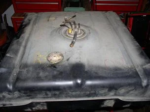

Fig. 9: ’96 GM full size Van tank with ’88 TBI intank electric fuel pump and factory ‘96 GM sender. Tank was miss-labeled at junk yard (yellow writing). Stock Toyota L/C sender at lower right corner.

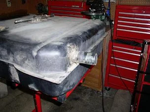

Fig. 10: Tank

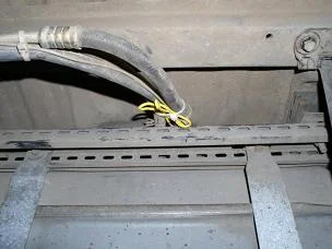

Fig. 32: Yellow wire is for in tank GM fuel sender. Unit is grounded through the fuel pump.

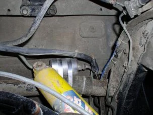

Fig. 33: Fuel filter, Fram part number: G3727. If truck ever runs bad replace this filter. Great filter but has a tendency to restrict fuel flow when dirty. Located in front of tank, passenger side.

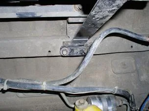

Fig. 34: Front of gas tank and skid plate mounting.

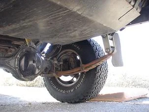

here is the rest of the pics have. hope this helps some of you out.
