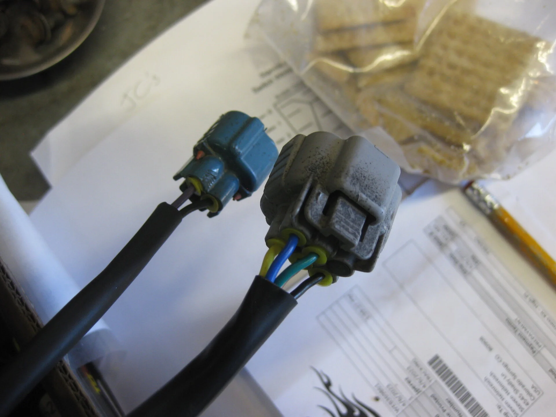

So, I took the Toyota wiring connectors off my axle harness and swapped them onto to the end of the TG harness. Crossed my fingers and.....it works. Pretty slick. See pix for wire color mapping. I ordered the FZJ-80 'high pinion' harness at the recommendation of the sales guy (who said it would fit a 100 series).
This was WAY more hassle than it should be - it was supposed to be 'plug in simple' and was a giant PITA. A buddy with a 4Runner studied his harness and helped me figure this out and suggested just doing the connector swap, with the frustrating 'pins' and 'locks' on the Toyota connectors. Also, the TG wiring seals (the yellow 'plugs' on the wires) don't fit tightly (cheaply made), so I will squirt a bunch of silicone grease into the sockets to prevent corrosion. But, in the end, it works.

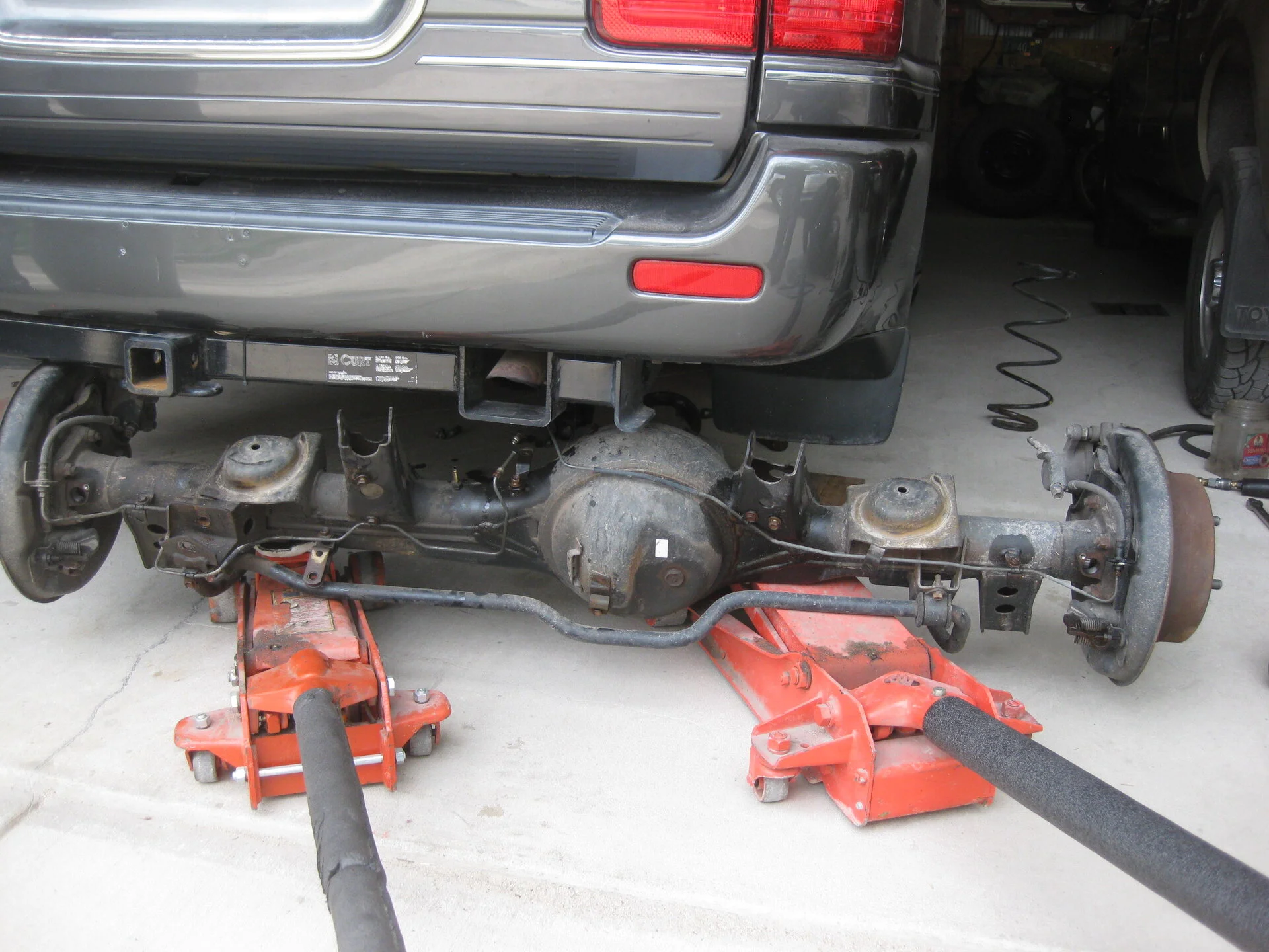

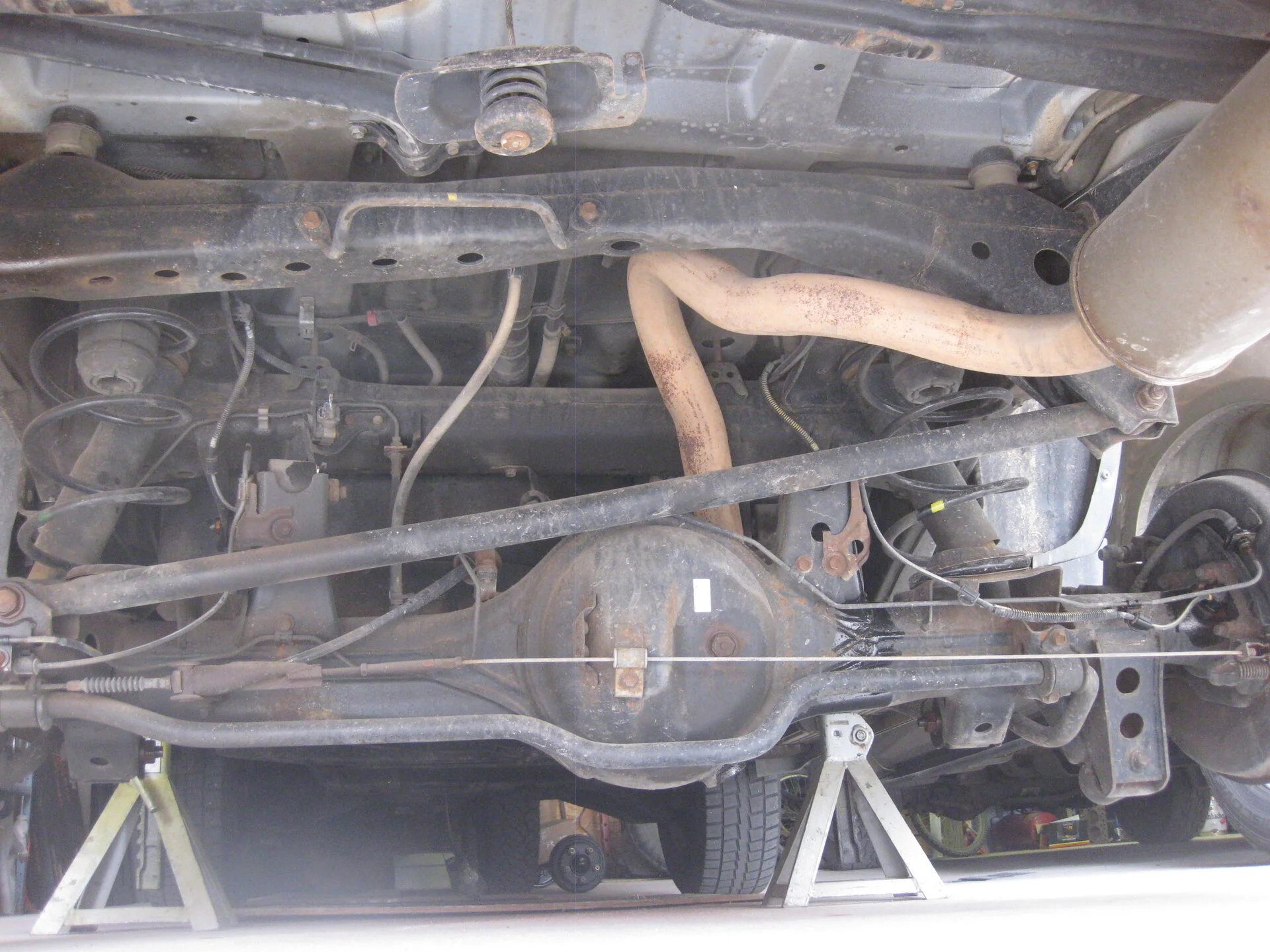

Swapped in the axle yesterday. 2pm - 9 pm, minus an hour for dinner. Lots of disconnect, reconnect, 3 come-along pulls to get bolts started. Nothing helpful in the FSM, but it's not super difficult to figure out. Pix for your viewing pleasure.
Seems to drive just fine - no odd sounds, smooth at 80 MPH, brakes work, no ABS lights. I now need to run the locker wiring and then should be done.
