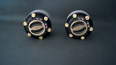

My Oct 71 FJ40 is being restored. It has two mix matched locking hubs on the front wheels. One is a warn and other says ‘Selecto’ , I think.
I want to replace them but not sure what to go for. I want good quality and to look the part. Any recommendations? Thanks. Ps not sure Aisin did hubs for a 71. Cheers.

This sounds weird, but if both hubs work, why not leave it? Mismatched hubs are 'hub patina'. You will look the part with two mismatched, but period-correct hubs. You have coarse-spline hubs, and I suspect that all you can do is find a used/old matching set on Mud. I doubt you will find new ones.

Thanks. I’m doing a full nut n bolt restoration so they need to look new. Thanks for the info
Saw those but wasn’t ready for the price 😧
Well, seems like prices have gone up. Perhaps another MUD member has some but even Specter Off Road has used ones for over 500.00 a pair. The ebay seller has them restored so I am sure that is why they are higher.
Thanks - no idea they were so expensive. Maybe those EBay ones will do then.
I've got some 70's drum brake frt ends from FJ40's and the Warn hubs on them dont look anything like the ones in that ebay auction. The price seems a little extreme too. You just need to watch the classified section and maybe post a wanted ad. You'll probably have to restore them.
I bought these for my 73 fj55 before deciding to convert to discs. Could complete the restore, or use as is.
I believe the six spline were discontinued by Warn. There is a pair on E bay that would probably be good for a restoration.
Guess if your doing a complete better than new restore that will only be driven on payment and spend most it time in garage or plan on selling once your done these hubs are fine. What everything perfect just pay the price. If you actually plan to use it off road don't about perfect and buy a good set of used hubs but not this style. These are very tough hubs but if you are in a pitch and need to get them locked better hope the splines are lined up. These are not spring loaded. Knobs with not turn if they are lined up. Certainly not bad hubs but better coarse spline options out there in the used market.
I needed new hubs for my LJ77 and went with AVM.
Cool Cruisers list them but they are out of stock.
Here is the model:
LandcruiserFJ401963-12/19756690AVM4044404
Here is the model:
Those are available "HERE"
