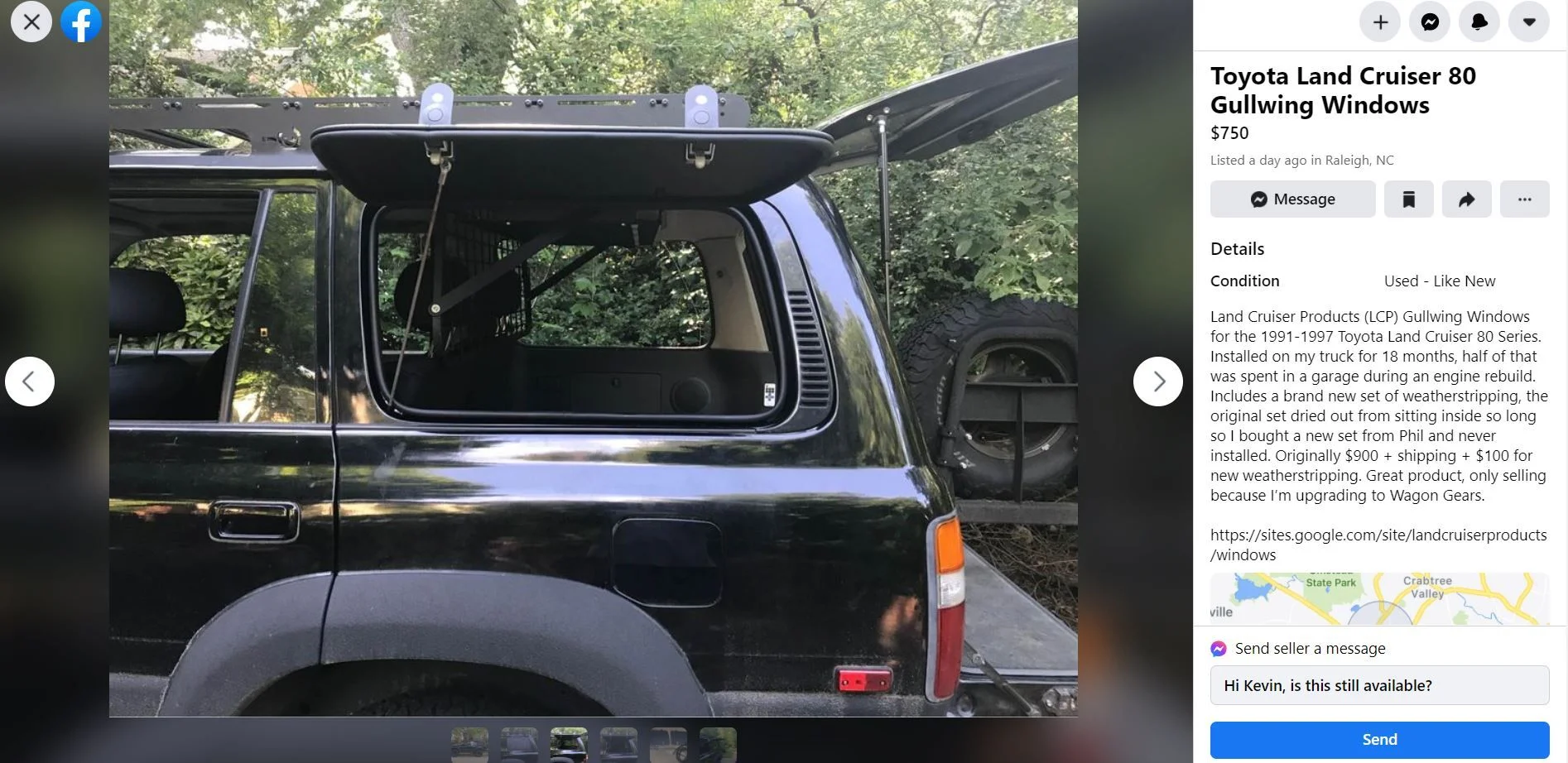

Also here's a link to a set, will cost you $588 in US which is less than your $700 :hillbilly:
used gullwing windows for an 80 for sale local in Raleigh...
