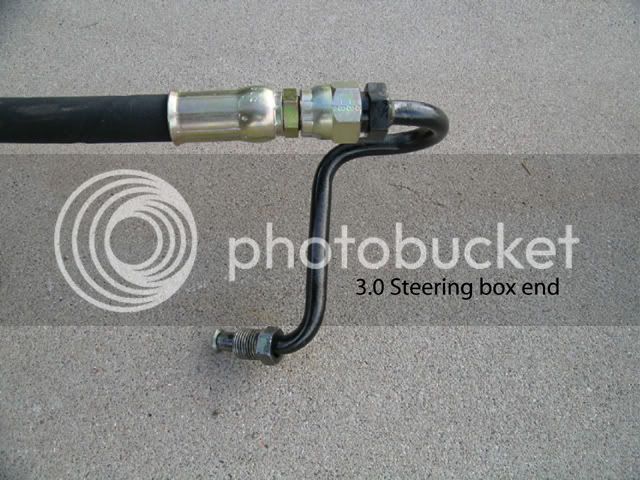

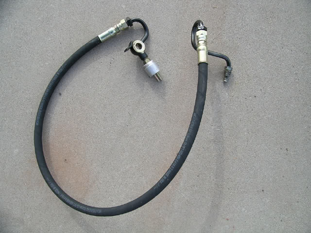

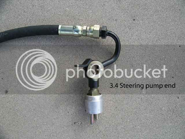

Does anyone happen to know a local place that can make high pressure hydraulic lines?
I am looking to reroute the steering (eliminate the ABS box) and need a custom high pressure line made.
Ideally I'd like the 3.4 PS pump banjo fitting on one end, and the 3.0 steering box fitting on the other end. I have the existing hose ends if that is helpful.
Thanks.
I wasn't aware of that. I'll have to go by and check that out.
Any idea as to whether they can (or will) reuse the ends I have? To me, getting compatible ends would be most of the battle.

Just to update... I found a guy just up the street from me. Scottsdale Automotive, just West of Scottsdale and Thomas (480-945-1177). I believe Art is the owner, as well as the guy who did my PS line for me.
I took him the line from my 3.0 steering box and the 3.4 steering pump.
He cut both ends off, and then soldered them to a more standard high pressure fitting. We then checked the length I needed and he crimped some ends onto a new piece of hydraulic line.
Seems like a quality job, and he did it while I waited (and watched). I'll post back when I get this thing running if there is a problem with the line, but I should be good to go.
