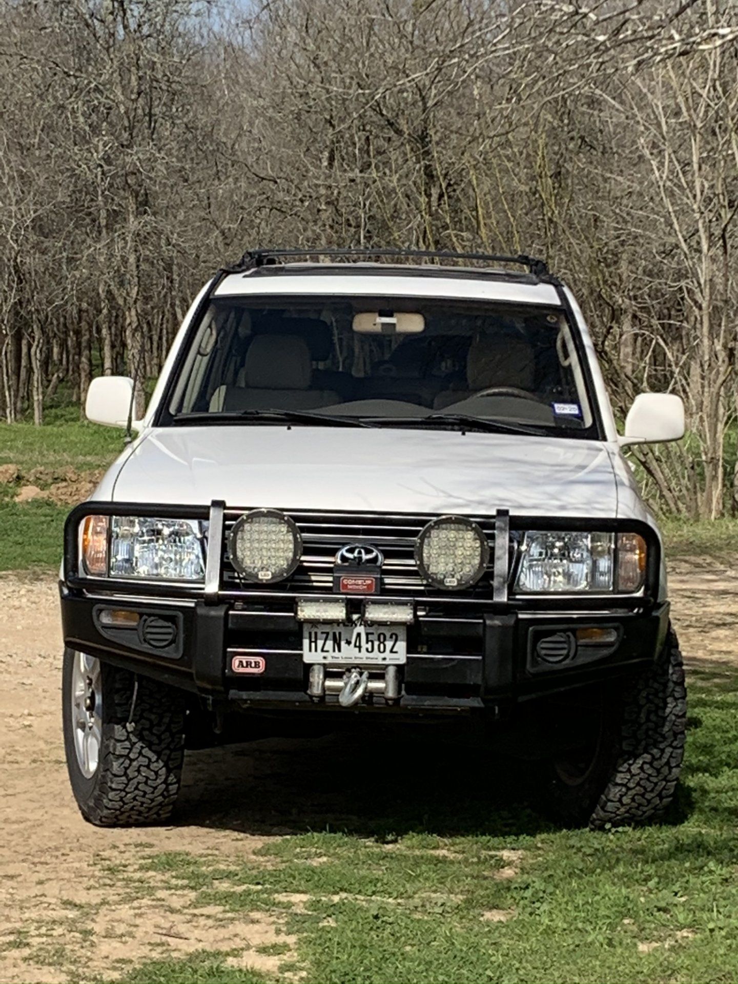

I am partial to the ARB bumper
Looks sharp

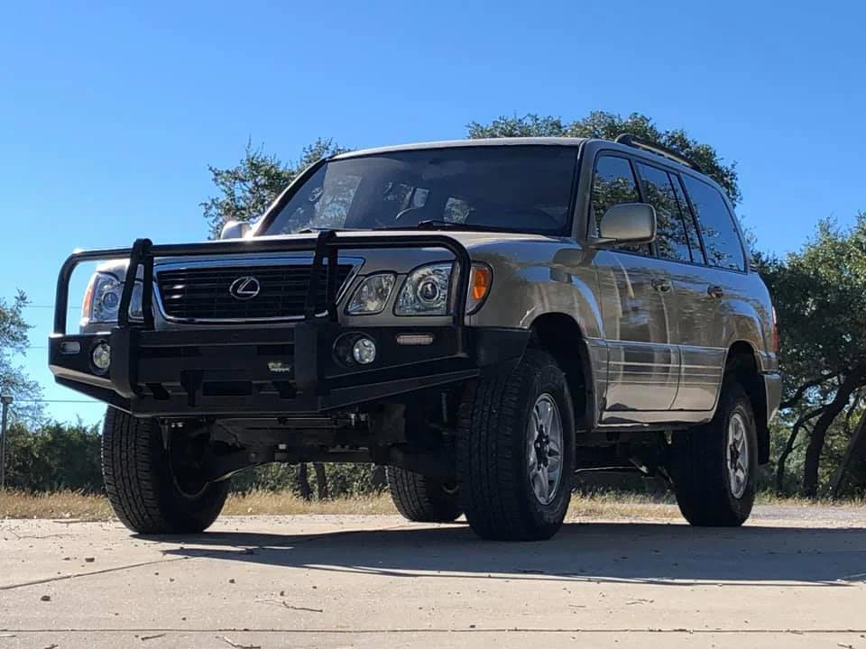

I have the IronMan4x4 Foam Cell lift kit with the Trail Tailor Diff drop. So I swapped out AHC with Foam Shocks, Rear Coils, and new front Torsion Bars. I also have the IronMan Bumper which you can get right now for $999 plus free shipping to a freight dock. Still on stock sized tires at the moment. I did all the work in my garage by myself. I also ended up having to change outter tire rod ends, upper ball joints and sway bar links and bushings. It aligned just OK with factory upper control arms. It would be better with some UCA's designed for a lifted truck. Once Apache Offroad is back in stock with UCA's, I think I will go that route and have it aligned again.
