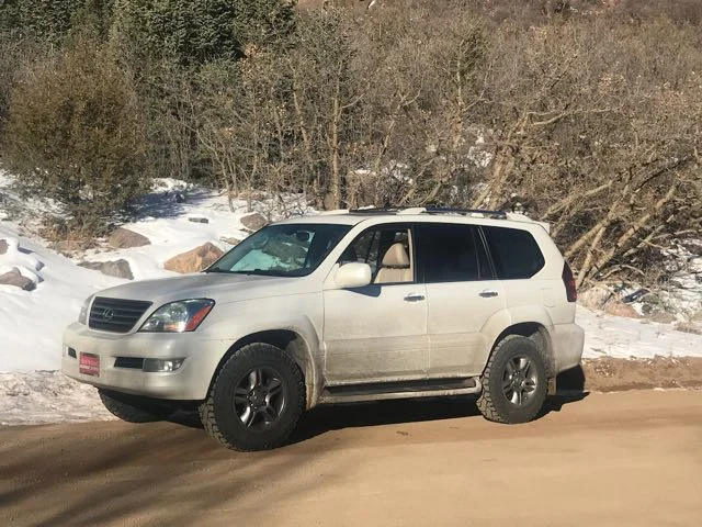

How do we have a 2-page 29 post thread without any photos? 😁😉
1910790
Here's a pic of the GX w/245/75/17 Goodyear Duratrac's
Stock suspension in Normal ride height.
