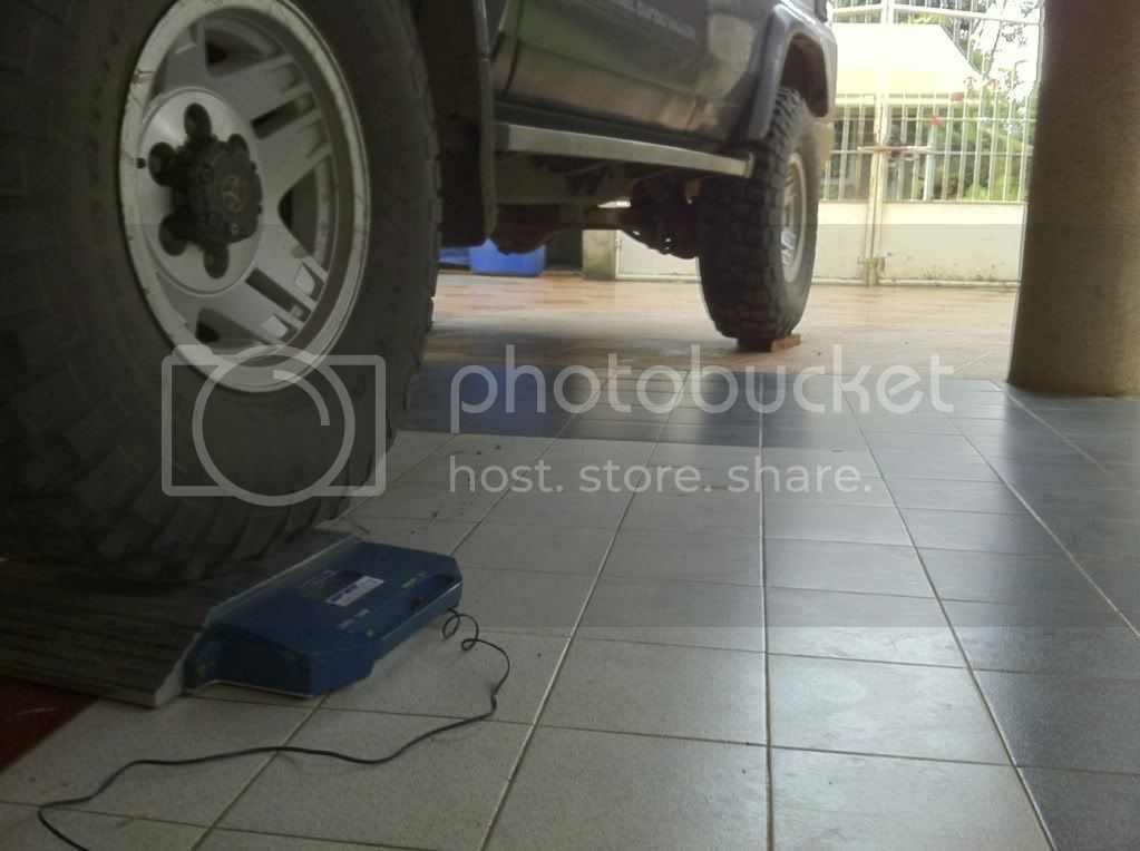

This is a pretty pointless thread but I have been struck by how even the weight feels among the four corners of my Prado that when I had the opportunity to measure the weight at each wheel I couldn't resist. I'm a pilot and an aircraft mechanic and I brought one of our aircraft scales home to ship to another shop and thought, "What the heck...I should weigh the cruiser."
It's important that the vehicle be weighed in a level attitude so I got some wood blocks that were the same height at the load cell. I put the scale under one wheel at a time and took readings. My findings were quite remarkable:
Weights KG:
LH Front: 538
RH Front: 542
LH Rear: 567
RH Rear: 575
Total: 2,222
Weights LBS:
LH Front: 1184
RH Front: 1192
LH Rear: 1247
RH Rear: 1265
Total: 4,888
I weighed it with me in the driver seat (89KG) and 3/4 tank of Diesel cause that's what happened to be in it - also, that's typical of what I'd have in it while wheeling in order to limit spillage.

I thought it was pretty impressive how close the weight distribution is. Some day soon I plan to add a winch to the front which will just serve to balance it out even more. So there you have it, a pretty trivial post about the weight distribution of a 1990 Prado.

Howdy! Interesting. I wonder how much difference there would be if you went back and did it all over again without the wood block spacers. Is fuel spillage a problem in the Prado's? I thought they should be able to run upside down like an airplane, ya know? John
Yeah, I don't know how much of a difference the wood blocks would make in the end, but there was one time when I got it crooked on the blocks due to one of them slipping and I know I got different readings when I squared it all up again. I just can't remember how different - I'm sure it wasn't much.

Thanks for the info... I did mine a few years back on a weight bridge, front first then rear, and then all....
Similar results..The Prado is balanced quiet well.
