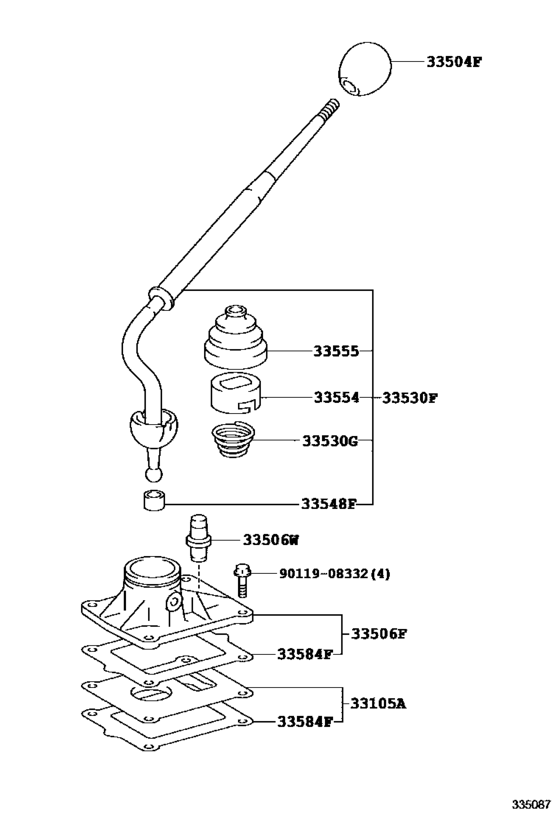

Does anyone have the part number for the seat?
Unfortunately, I am unable to identify on the diagram..
I think that 33548-31010 is what you are looking for. It should be available at a local parts store, since it is the same as in V6 5-speed 4Runners and Pickups.
