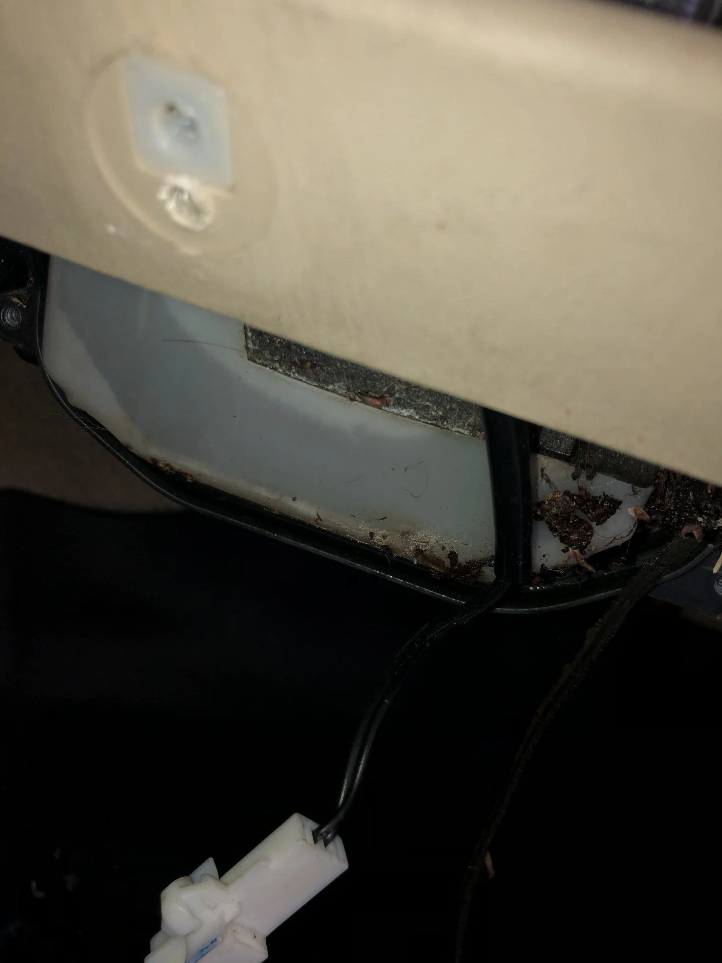

little drip with AC on hot day on passenger's feet

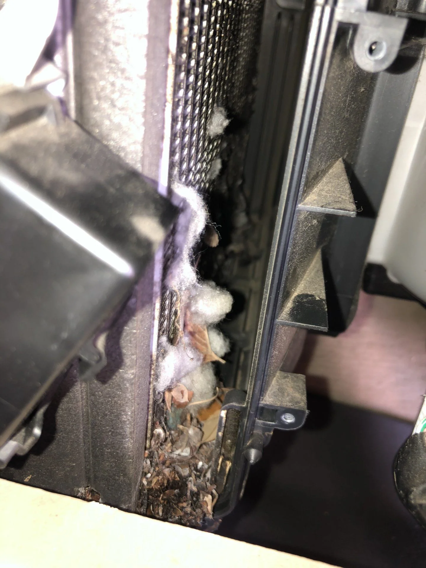

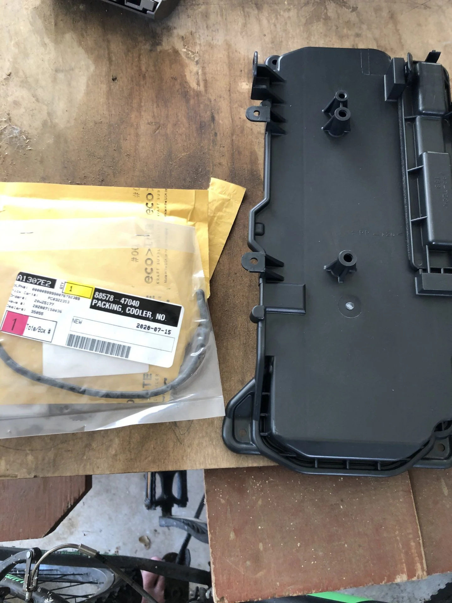

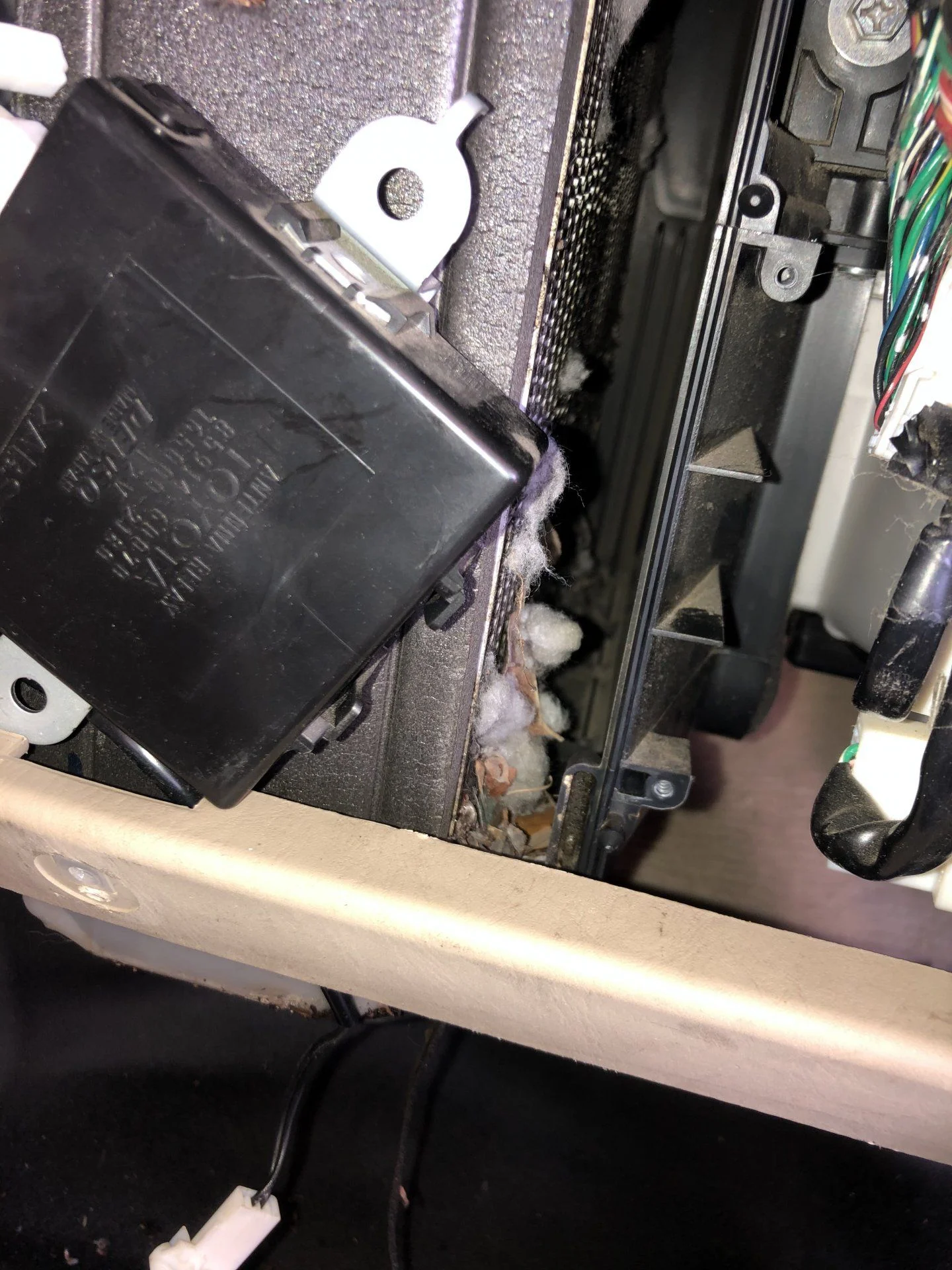

@Shortpencils even tho it was footylicious I went ahead and plugged her up. The old gasket was super compressed. Also did the mod to let me use cabin air filters. 🍌
