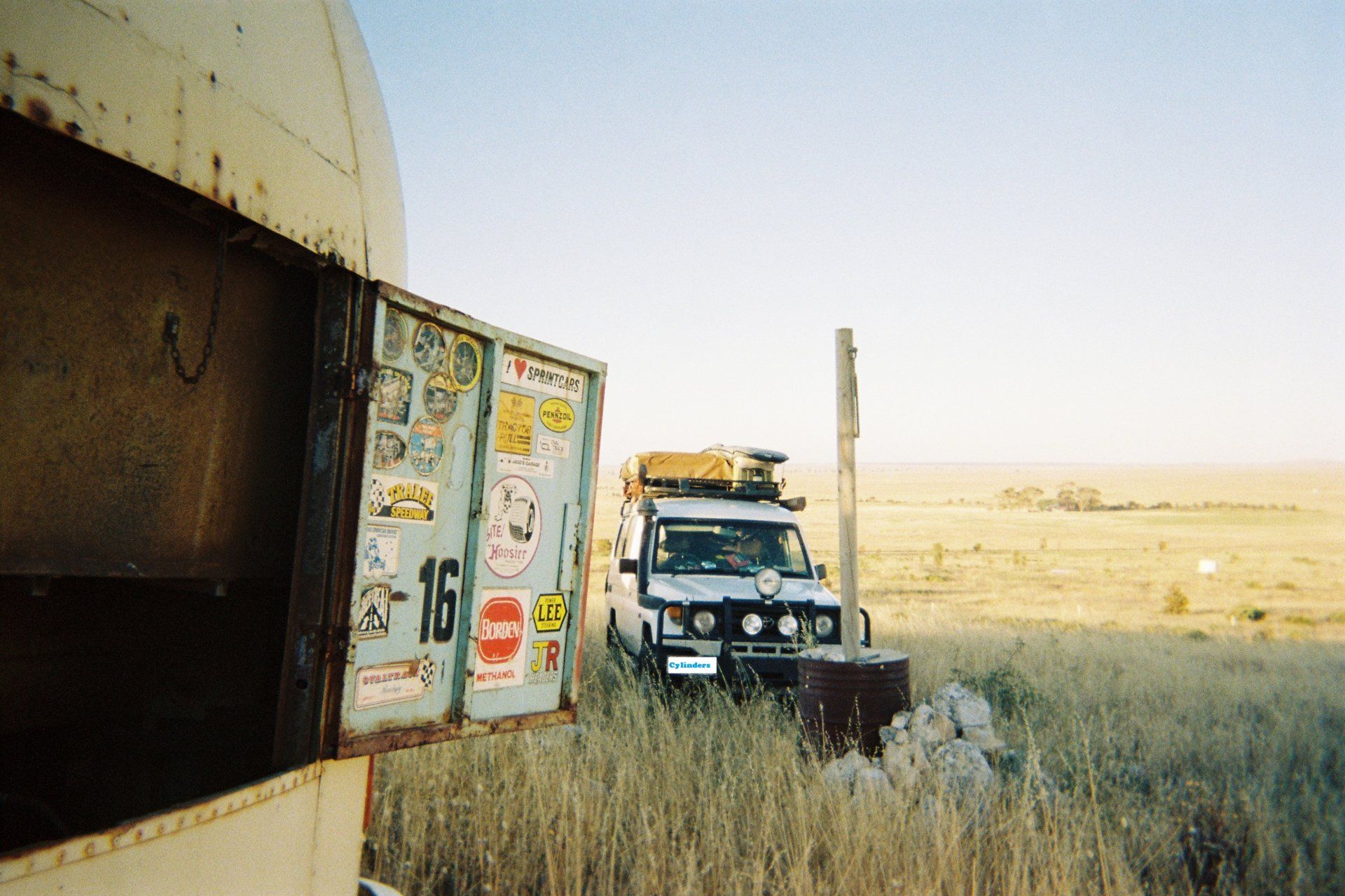

I had already had the good fortune of co-piloting my good mate's Troopy from Brisbane to Perth back in November 2016. We went South from Brisbane as far as Ulladulla, then cut west to Canberra and onward to the Nullarbor and beyond. We did it all in 8 days and though it went by faster than I ever imagined, I have some great memories from that trip including spending my 30th under the Super Moon in outback South Australia, a few parties with people we met along the way, and surfing some truly frightening waves/spots. The other thing that happened was I realised that at some point I was going to have to get one for myself, and do the trip many more times in the future to feel like I had really seen and done it all.
First glimpses of Western Australia in the dawn.
Speedway stickers on an old bus.

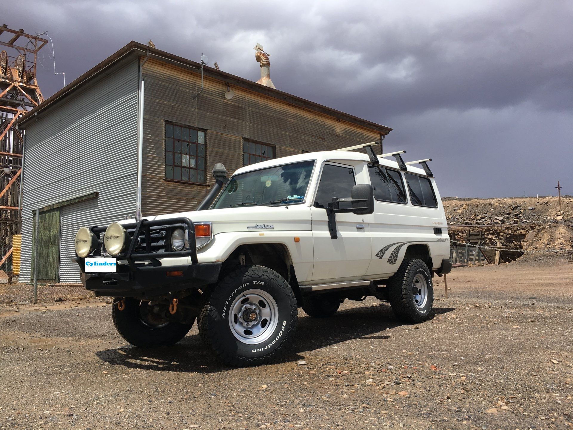

I got to work, and began to go through tyres pretty quickly. The good thing was that I could get them really cheap second-hand in town due to all the mining work in Broken Hill, the bad thing was that I was losing a few hours a week to blow-outs and I didn't have those hours to lose. So, I rang around and eventually found a NOS set of five 105 series steel rims in 16x8 0 offset, and had them set up with the tried and true BFG KO2 ATs in 285/75/R16. I still have the same set running now, nearly a year and a half later, with at least 40,000 kilometres on them and a very rough start to their lives, having been worked hard for the remainder of the project.
Linda and her new shoes, on the road to the Broken Hill Miners' Memorial. Interestingly, Broken Hill Proprietary and these buildings behind me became BHP, the world's largest mining company. There are probably close to a thousand men remembered at that memorial.
Sightseeing with dubious access permissions amongst some of Broken Hill's older process buildings.
