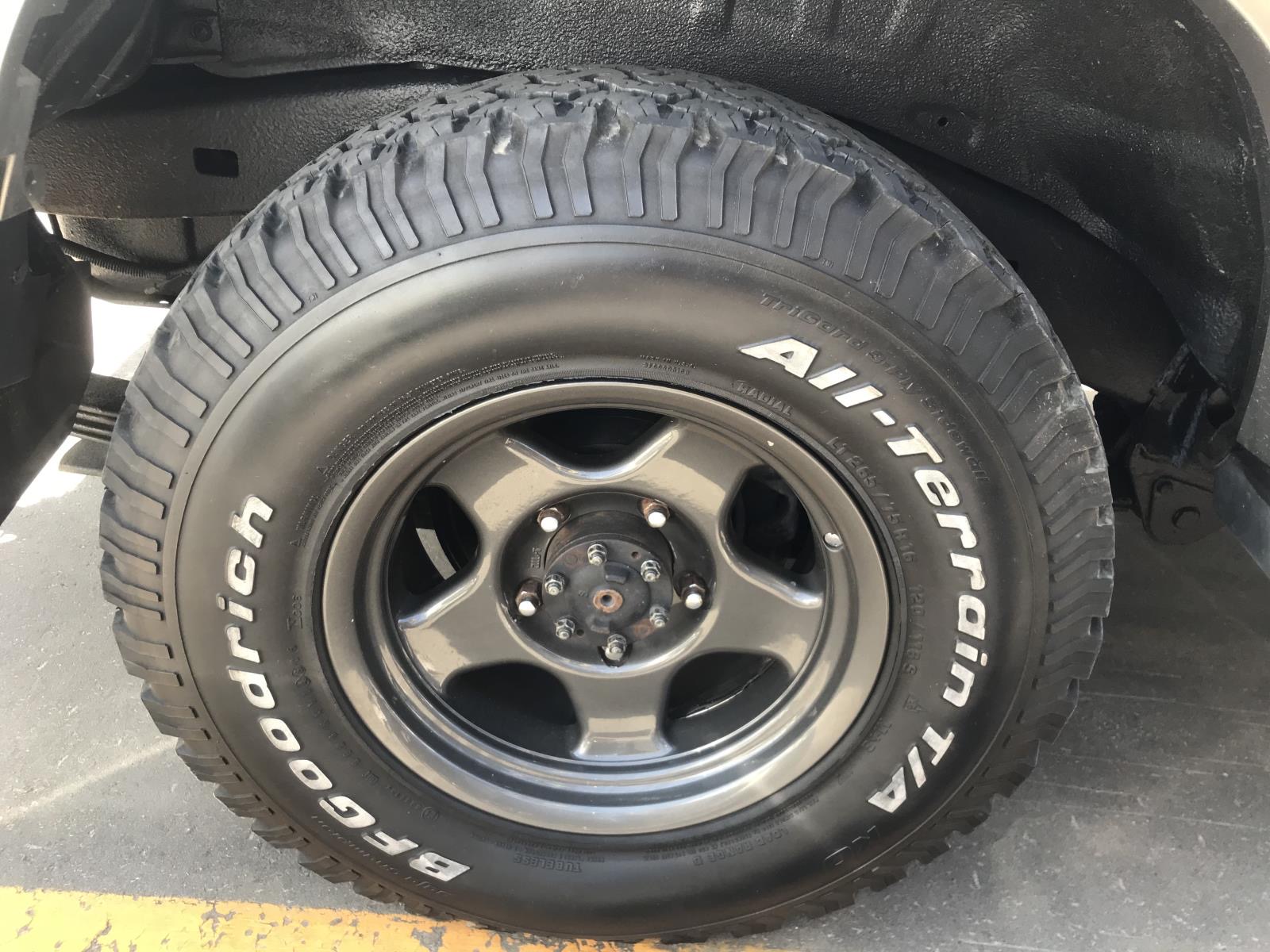

Does anybody know what brand wheels these are? Obviously the vehicle isn’t in my possession so I’m trying to ascertain from photos, and wheels are NOT my forté.
Cheers
Cheers
Probably Bradley wheels. We have a clone here in the US called Stealth Custom Series F5.
