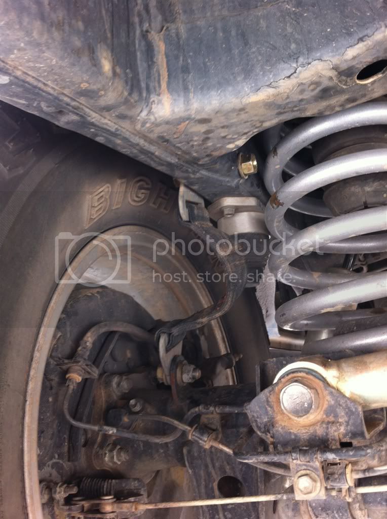

That strap doesn't allow for enough travel when driving thru town!
lexi4darin said:That strap doesn't allow for enough travel when driving thru town!
Is this one of those "Jeep things"?
When you post up about spring noise on the rear end, it looks like the bolt for the limiting strap is hitting the spring.

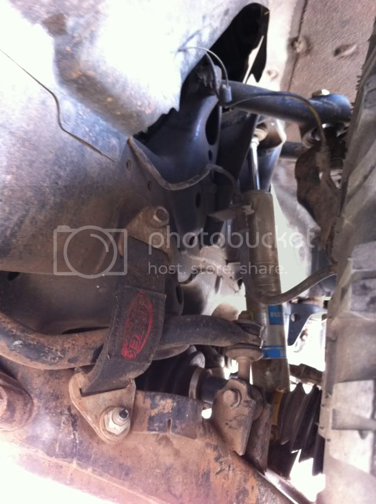

The front drops about 2.5" when lifting the front end with a floor jack. Not a great pic.
What do the vendors of the high dollar shocks recommend? Limit straps up front? Do any of these shocks have internal limiters to eliminate the need for straps?
thanks
Do you know what length the front limiting strap is? Most people offering them have a range from 10" and up from there. Is that short enough for the front set up?
