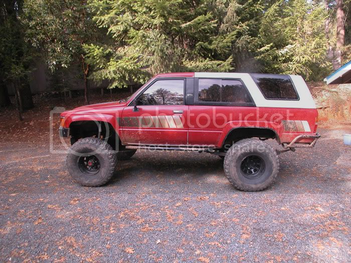

Heres a shot of my runner on level ground.
Your 85 4runner will sit lower than my 86 4runner just because ot the frame.With same lift your truck will sit about 2" lower than mine.
