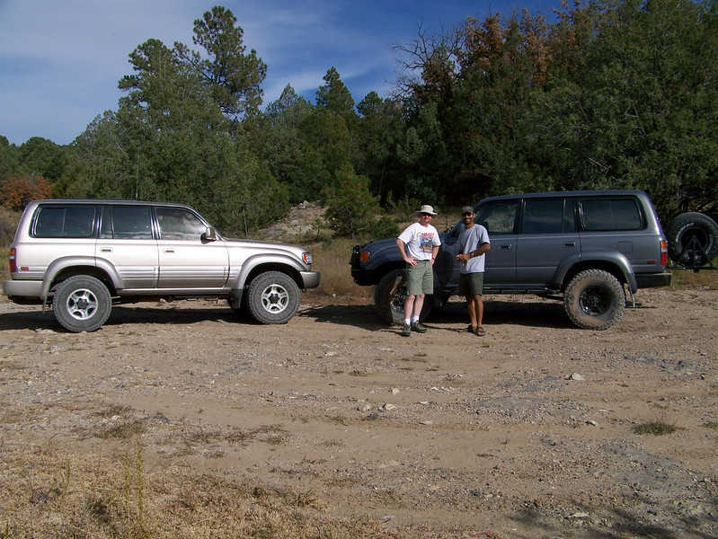

No problem with the stance, it had a very slight rake, which like you, I prefer. I too don't understand why everyone is so against a rake on an unloaded 80. :rolleyes:

I think you will really enjoy the mediums. They ride a little stiffer, but it is more controlled better ride. Plus they just fit an 80 with 33's.
Here is a picture of my LX on 33's/mediums (unloaded) and Ali's 4"/35's.
Jack
Looks like a nice stance to me, I think it is a lot of people getting all worked up over nothing....
