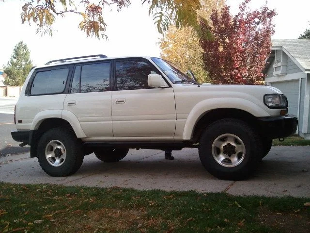

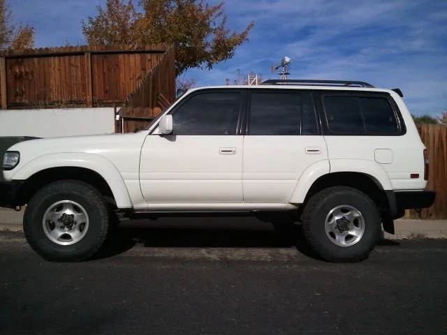

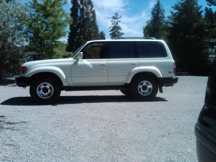

Finally got the springs on. :eek:
Drives very nice, and i'm happy with the results. I dont see why some people say its "harsh." (first pic is an old one for comparison.)
33's look kinda small though!

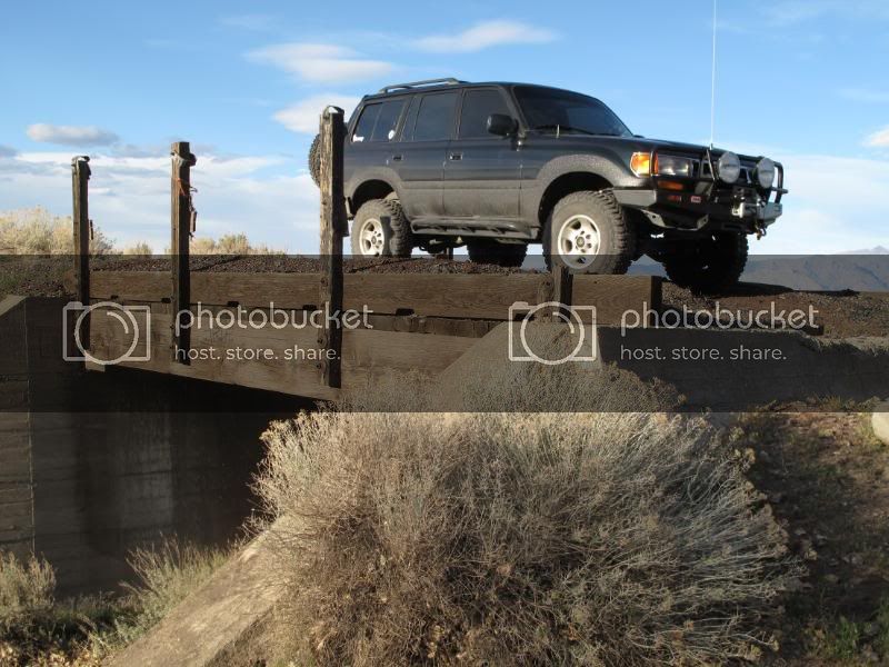

Here's a pic of mine with the J's and 255/85's on it.

Thanks Matt, that's just north of Pyramid. Yours is looking great.
