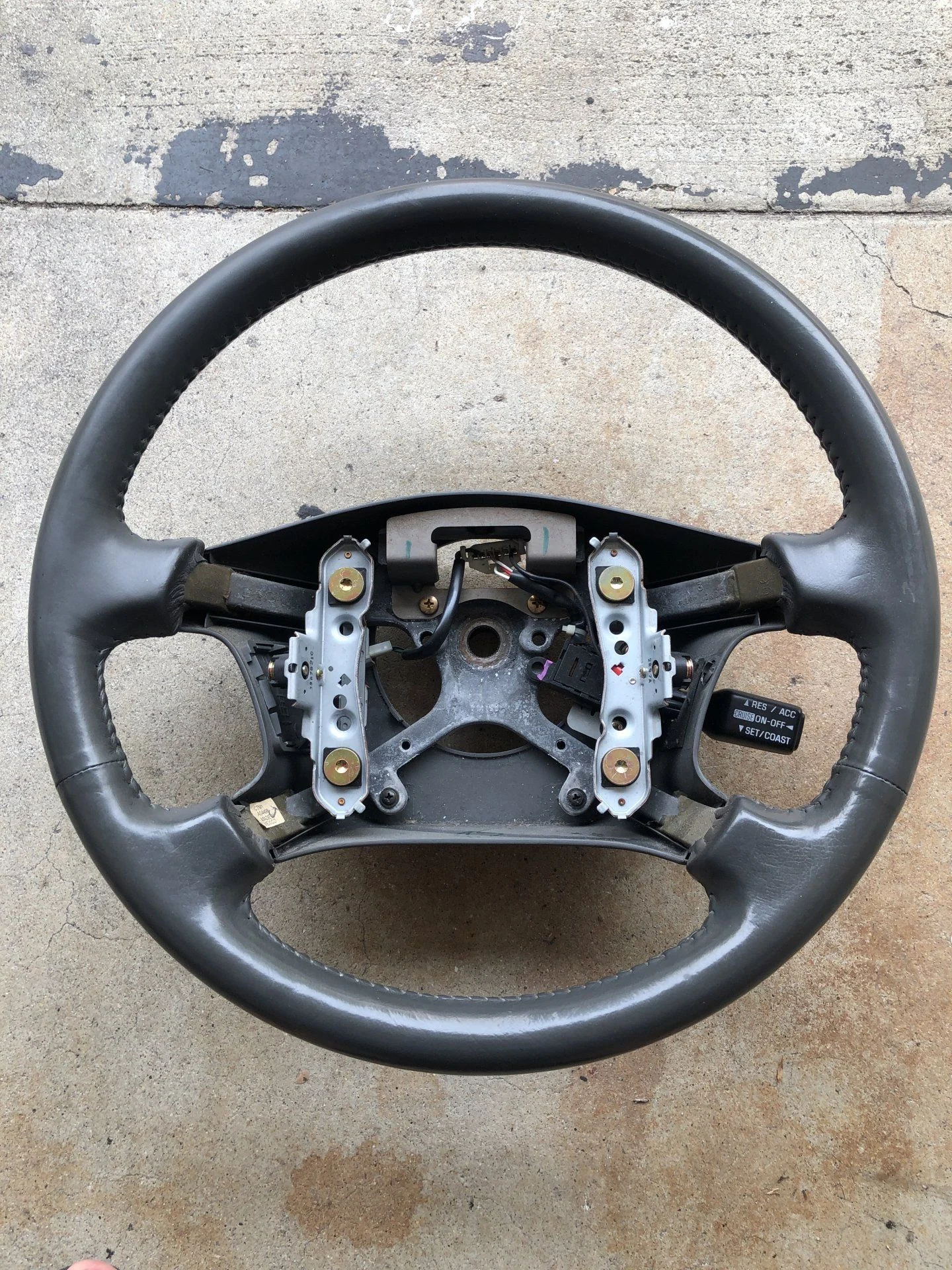

You’re welcome to the wheel for shipping, it’s in good condition, gray leather.
i’ll message you on the wheel. THANK YOU for the offer.

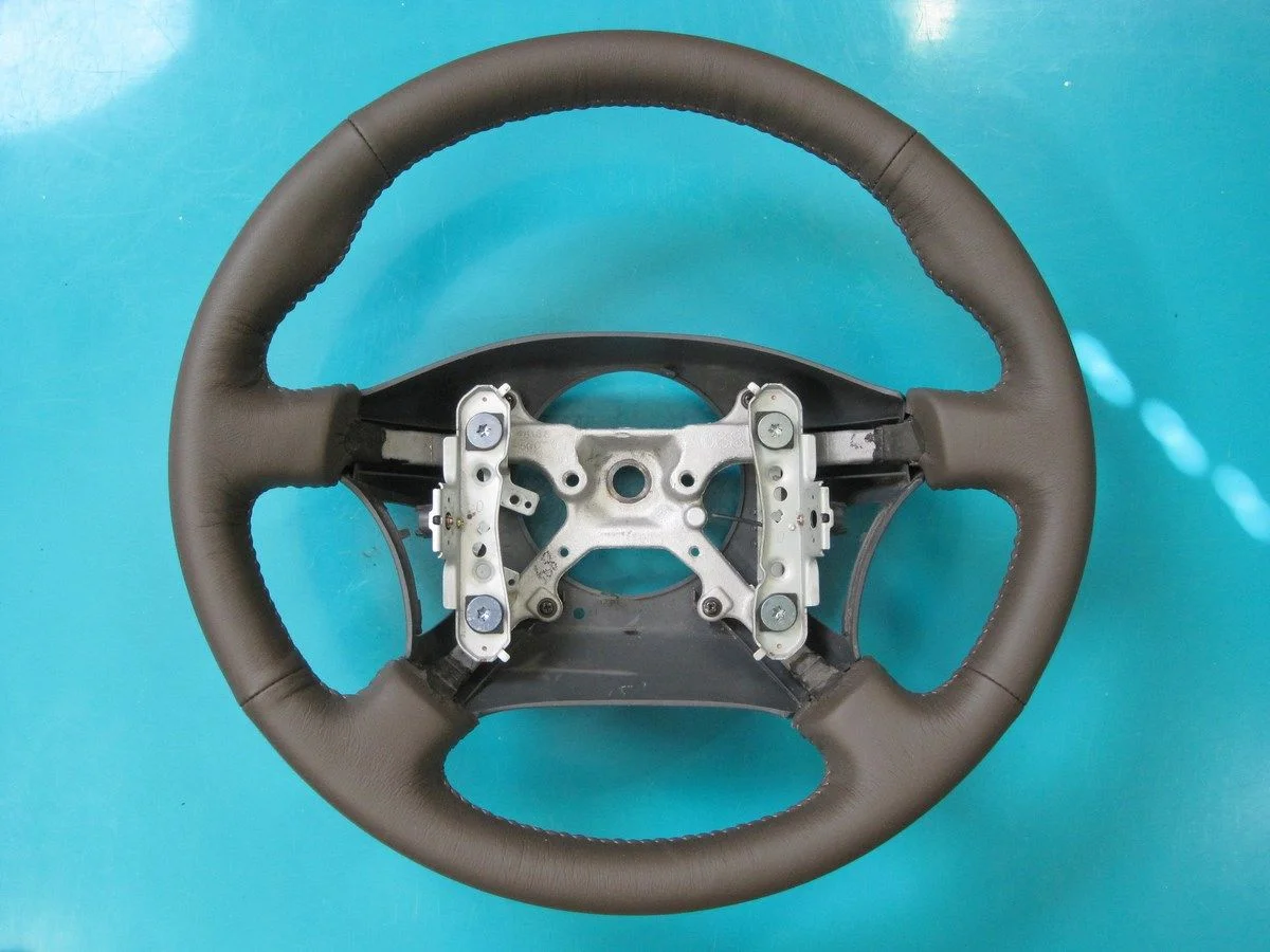

I bought a used LC wheel for my LX450 from @arcteryx. He shipped it out to Dallas Custom on my behalf.
The horn contacts are under the airbag, BTW. You're not cleaning the clock spring.
Here's my original thread:

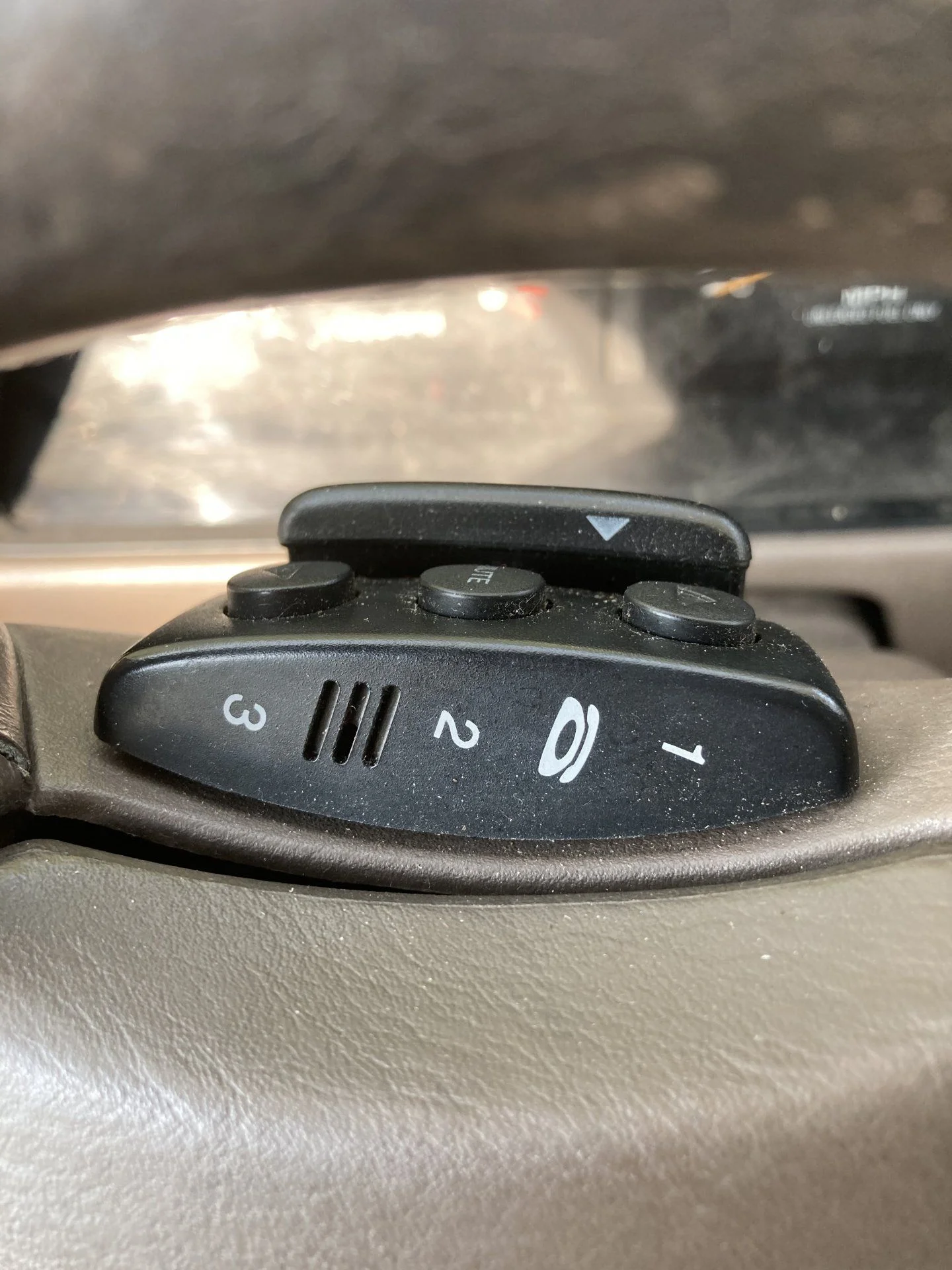

ONE THING i am not sure if is if the LS400 wheel has the phone control parts attached to it or if i just keep these and screw then into the new wheel or something.

Depends on how much money you want to spend and what results you expect.
I wanted the OEM look with an improved feel, and that's exactly what I got. However, DCSW will do anything you want and all the options are a-la-carte.

i have the controls pictured. i’m trying to just figure an economical strategy to redo the wrap. but the horn is not working well either.

You didn't read the thread I posted. DCSW is Dallas Custom Steering Wheel. It's what they do.
