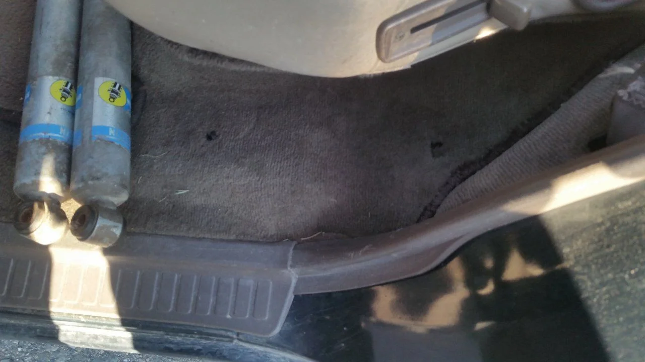

Feel free to add other things to look for. I just also saw a picture of an interior and realized I'm missing what looks like a plastic step to get to the third row seats. Now I know why there's studs sticking up out of the floor. Thanks MUD!

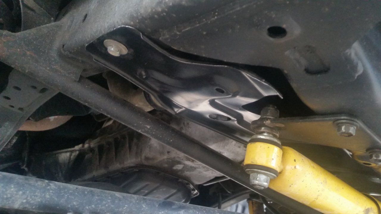

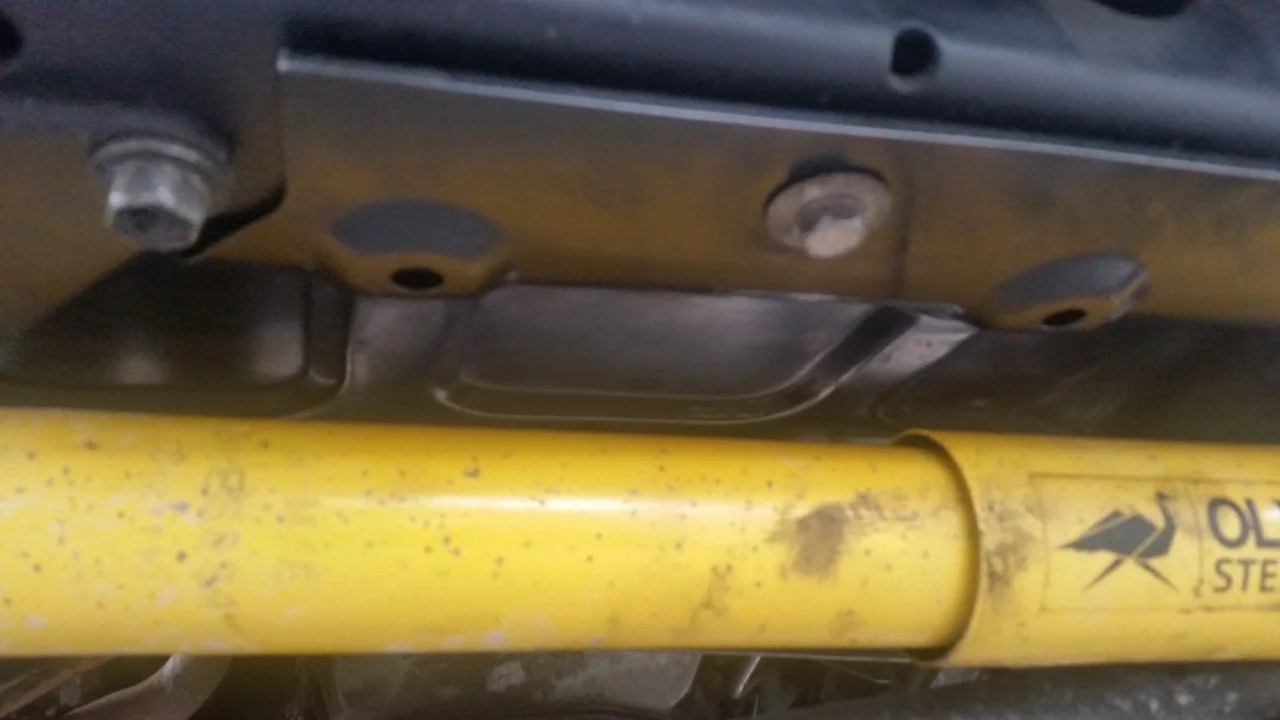

There is a splash guard that is bolted to the bottom of the frame just beneath the radiator. It blocks mud from splashing up into fan and radiator and looks like it may also act as additional ducting to for the fan.

Here's a picture of it
Here's another
Here's a picture of where the step would go
