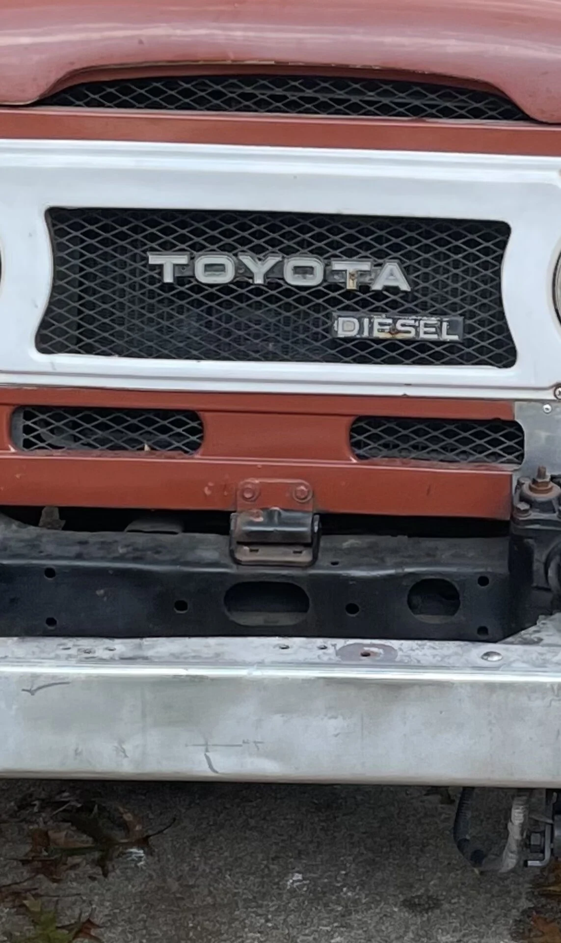

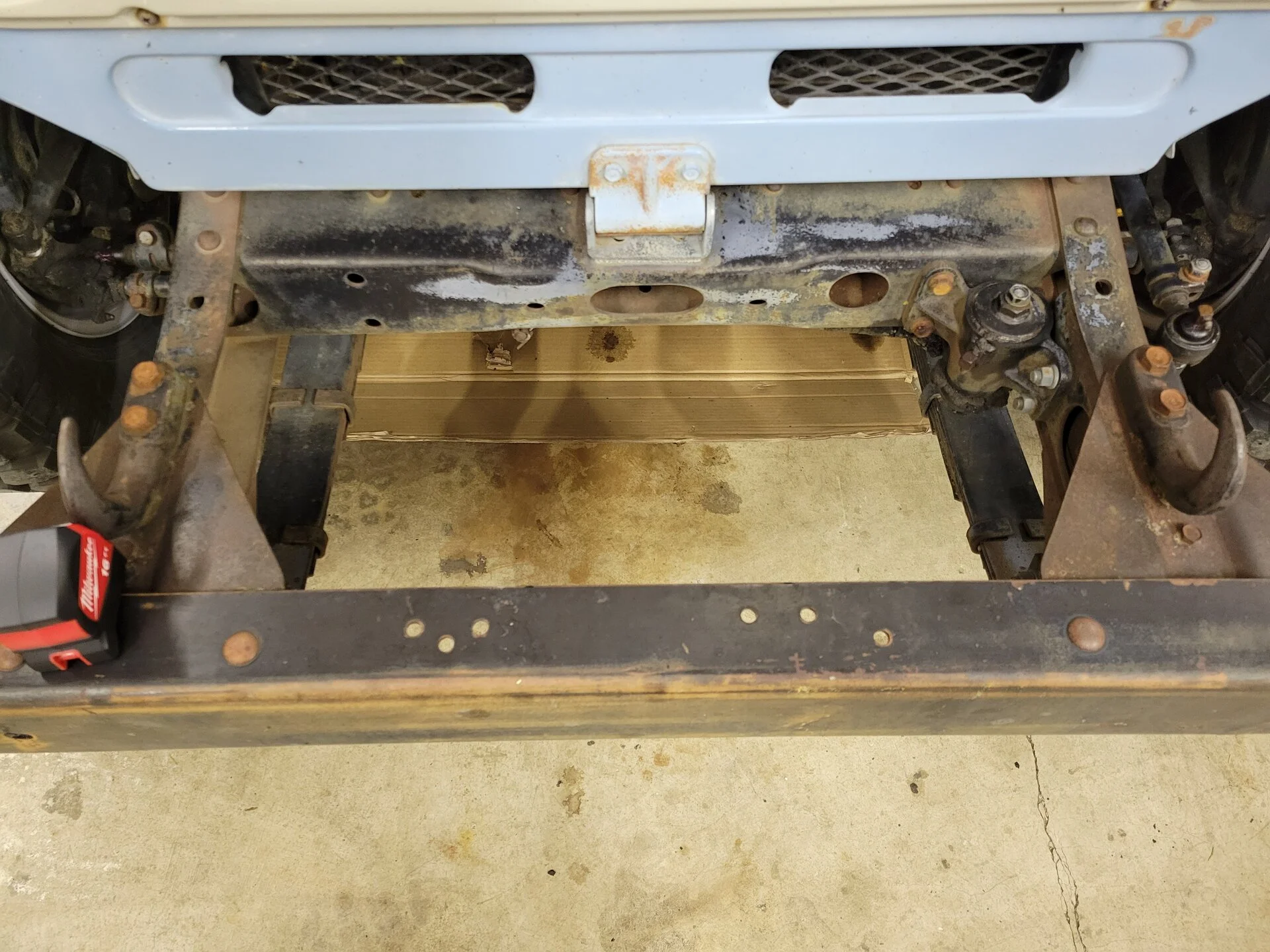

So I'm taking measurements on the bumper for the winch and I notice these holes. Definitely not symmetrical....I assume they are NOT factory? They'll be easy to fill when I do the winch but if they are factory I'll leave them....but what were they for??
Idk if it is factory or not, I thought they were aftermarket, but I have the exact same holes you do

@Pura Vida So those MUST be factory!? What's the chance that we both have the exact same asymmetrical holes? I'm sure someone knows what they're for. @Living in the Past ??

I think the holes are for other market items? I bought a new bumper from Toyota in 2020/21 and it had a dozen extra holes.

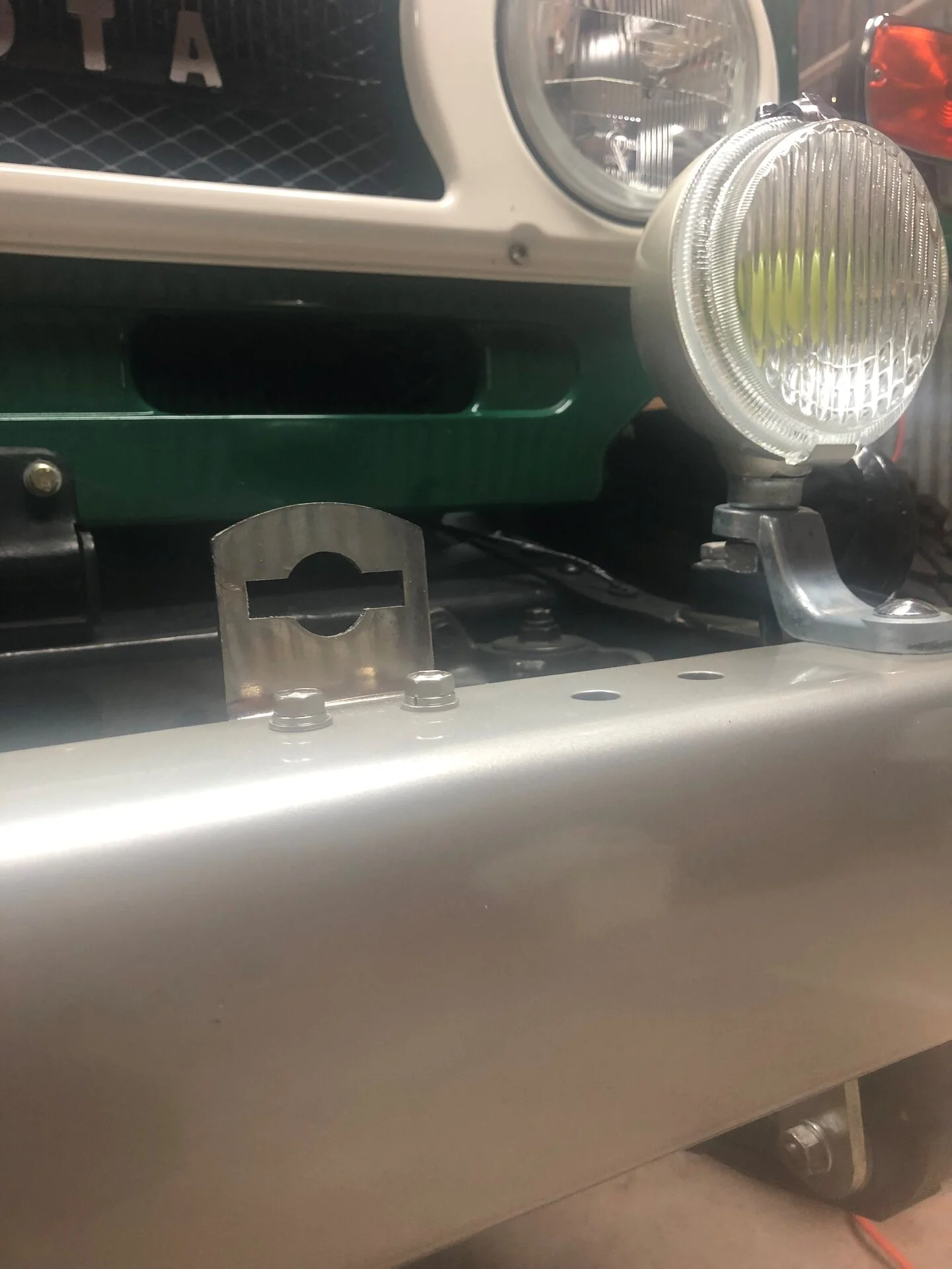

Two holes closer to the bib on the right side are for the license plate bracket. Two together on the left are for the bracket to use as a guide for the rod to hand crack the engine. The two separate holes are for the factory PTO winch. Outside the frame there is matching hole on each side. These are for the factory fog lights. The two other hole on the right side are for the license plate bracket when a PTO winch is installed. Could possibly be two extra hole on the bottom right side out of the frame. These would be for different license plate bracket when a winch and fog lights were installed.

@Living in the Past THANKS! I figured you would know.
My factory license plate bracket is mounted in front of the passenger tire.

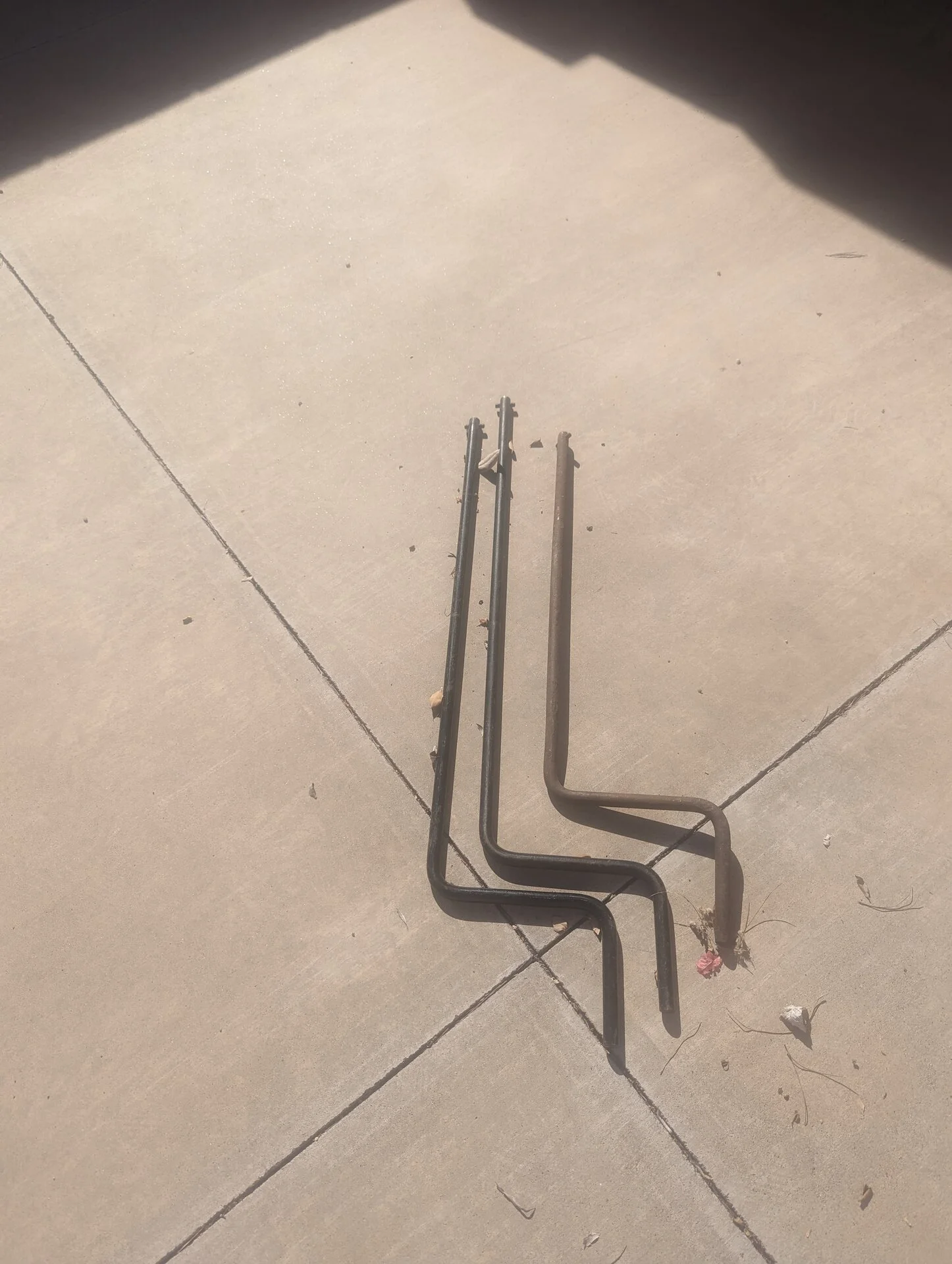

You just brought up a topic I am curious about. The PO said he really enjoyed adjusting the valves, and that an easy way to do it was to use the jack handle to turn over the engine. He remembered inserting the jack handle through the gap between the crossmember and the front bib into the crank pulley to roll the engine. Is he correct about the jack handle or is there another crank handle that I'm missing? I can't figure out how the jack handle would engage the crank pulley. (I have the factory handles secured under the rear passenger jump seat)...
Never heard of a jack handle working. There is a special tool to start the engine, also used to lower the spare on the FJ55. Tool was dropped from US market early on in the FJ40. My 65 FJ45 still has the clips to hold the rod, but had a goofy spare tire hanger without a winch to lower and raise the spare tire. Rod is nothing that special. Can post a picture tomorrow but there are pictures already on mud. Search hand start in the 40 section.

Not the jack handle but there is a special hand crank tool that goes between the bib and frame and fits into the claw nut on the crank. You can start it this way; much easier if you are properly tuned.

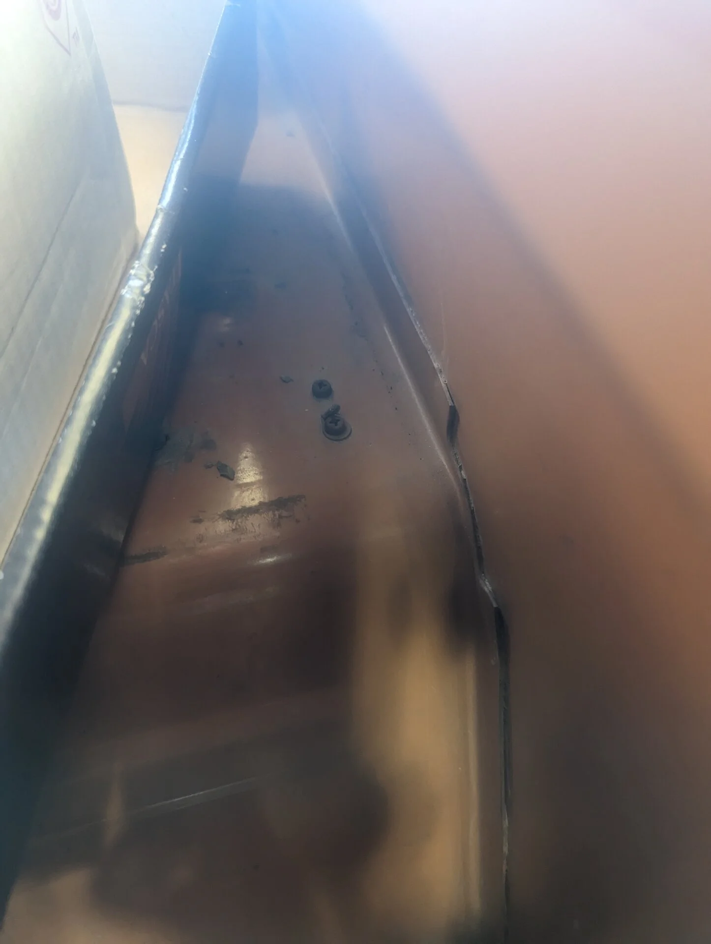

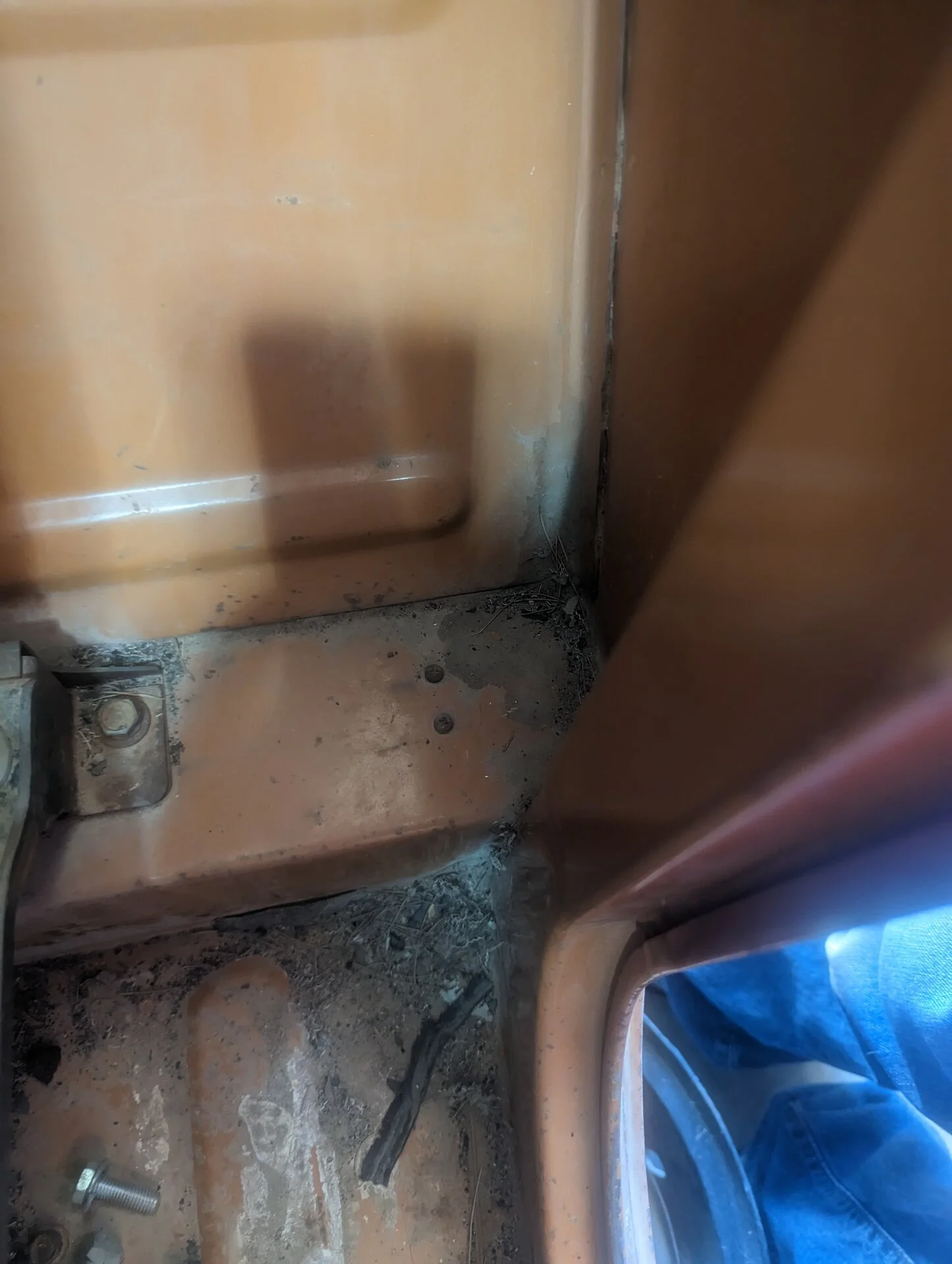

Would have to check my 2/73 to see if the screws are there. Factory there were two clips on top of the fender well and one low. Low was horizontal not on the angle of the front side of the fender well. My FJ25 I sold a few years back the lower clip was on the mounted to outside of the tub. It was an early FST which had a CJ5 style side doors. 1/79 the jack was mount to the bracket behind the seat. Markets that still had the rod the lower clip was on the jack mount. The rod also came in two lengths.early were 850mm and later 1004mm.
Checked and the screws are still for the rod clips on my 73.
Plus the rods used to lower the spare carrier on long wheel base 40 and 55 series

Never seen the clips in a 40 series and that includes the 61 FJ40 I have. The clips are larger than the ones used to hold the rod for the jack. I know I have some clips for the larger rod somewhere. These are actually harder to find than the map lights. Those were fairly easy at one time. I would like to find the rod holder for the late 40 series. 79+ the tool kit was under the passenger jump seat and jack handle rods under the drivers side jump seat. There is a style of clips that stacked the rods with the starting rod on top. Will have to be sourced out of another market.
I checked and mine has the screws for the clips. I don't think I'd have an issue making the crank rod itself but the clips might be a challenge. I'm going to see if I can find clips from another source that would work and look correct, but I'm sure it won't be easy.
