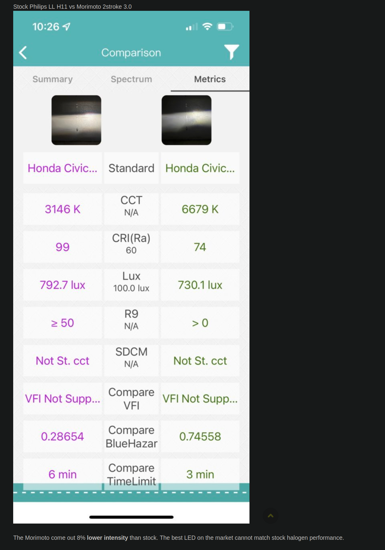

According to repeated studies from UMTRI, higher blue content 4000K HID and 4000K and above LED generated more glare. Their research showed the highest color temperature lights produced the worst glare. There was also more research done at earlier dates that showed similar results.
Furthermore, according to Daniel Stern, blue light is one of the least helpful colors of light at night. It tends to focus in front of our retinas rather then upon them. I've also, anecdotally, did the blue light test that Mr. Stern was talking about in the article. I used a blue pump SST-20 flashlight that I built. When I tried to see things in the dark with blue, objects did indeed appear to blur. So we have this 5000K LED light, whose spectral power is nothing like the sun, not even providing much useful light for the viewer.

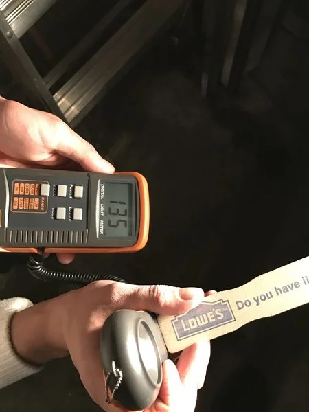

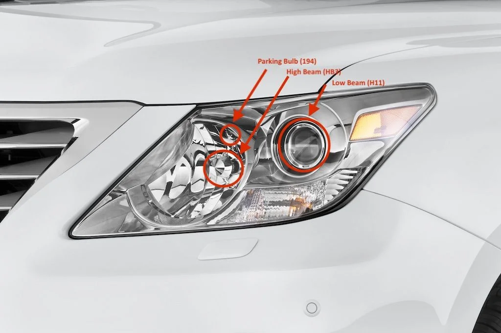

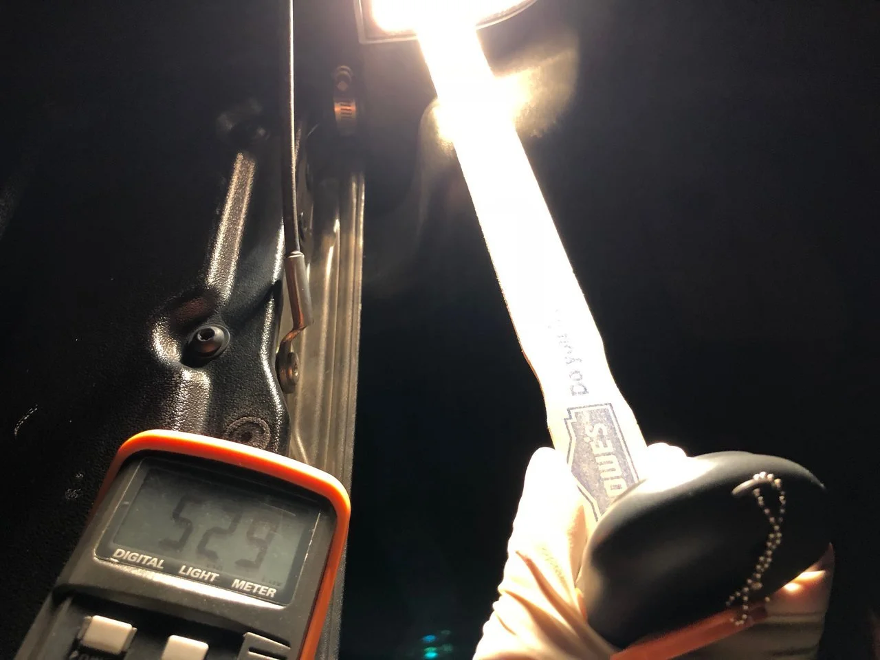

This is what I have come up with for lighting upgrades. The total cost is maybe $100 and the OEM look is maintained. This is all theoretical at this point. All factory cutoff lines are maintained (with a small exception for the fogs). I think you probably made a good decision with the HID, the only drawback being a reduced CRI rating in exchange for more light.
  • Low Beam Upgrade H11 to Philips H9 Is nearly double the light output of the stock Osram H9.
  • High Beam 9005 to 9011 Will gain you about 22% more light
  • Fog Light Upgrade H11 to Philips H9 45% more light (this needs a end cap applied or there will be a small amount of scatter, though nothing like LED)

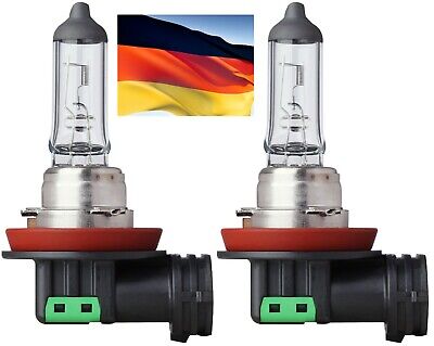

If someone wanted to run and external low beam harness than you could go with these German made 90w H11 in the headlight. Fog lights may melt.
