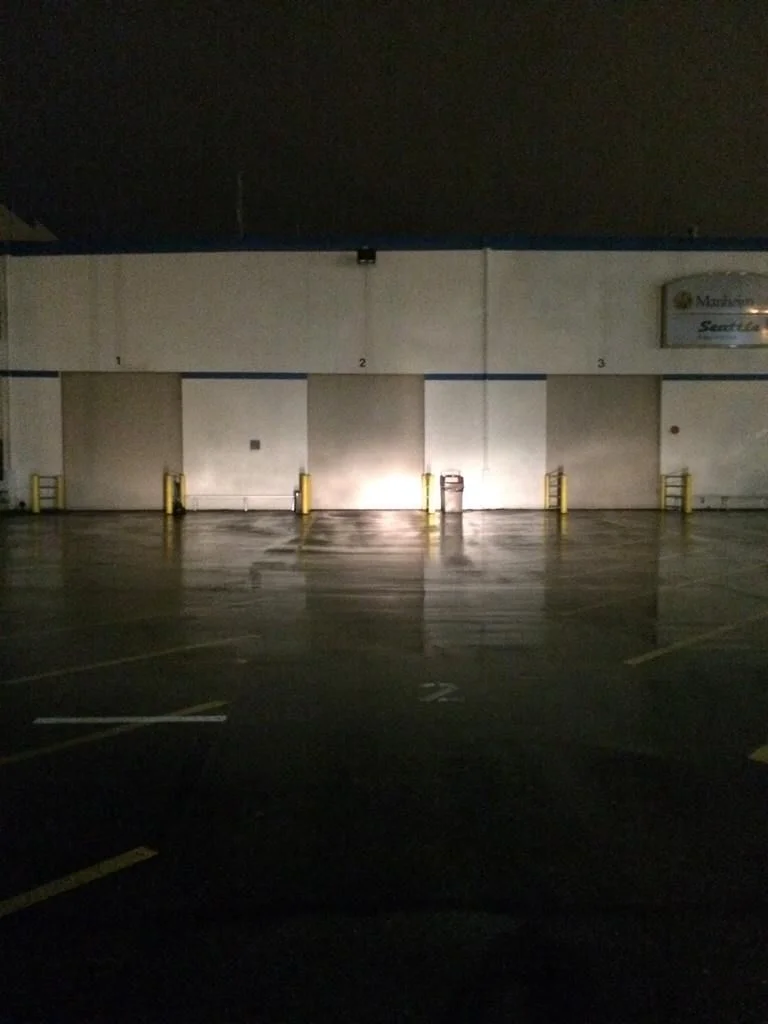

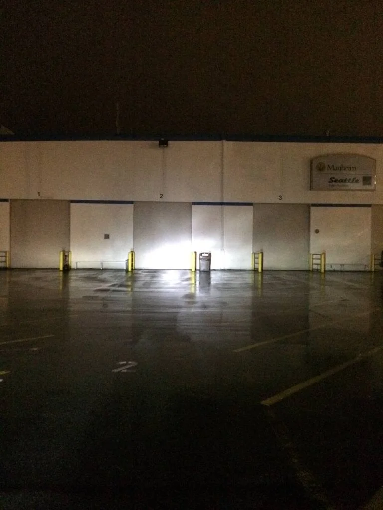

As you can see from the picture in one of my previous posts, the LED bulb (that I got obviously) doesn't have a very defined beam pattern, and it looks a bit like the HID-dump-all-the-lumens-fast. I fear that the LEDs can have beam pattern issues, and not being blinded or flashed at isn't really the same as the headlight operating the way it should :)
Do you have a night-shot from your LED install mdandashly? 35 feet away from a wall? Would be great to collect some wallshots taken with the same distance.

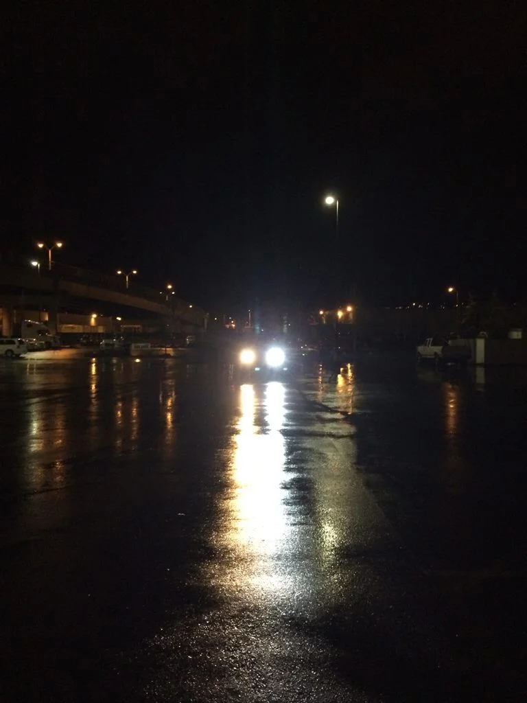

Yeah, just because you don't get flashed doesn't mean they're doing what they should! How about getting in someone else's car ~25' away facing yours w/your lights on & see if it blinds you? What about the projected distance of the LED's? Is it ~50' or is it ~150'+?
Nonone has seemed to mind. And again in did stand in front of them from varying distances and and no abnormal issues.
I'll see if I can snap a pic of what mine look like with the LED's facing the sides tonight or in the morning. The throw is really pretty far; I see road signs illuminating from a much greater distance than previously, and they do seem to light up the road better. That said, when I get behind a car at a stop light their entire cabin is lit up very well and I've seen several people readjust their mirror while I'm behind them.

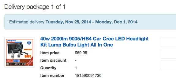

On my "my ebay" it shows the seller has changed the pricing to $79.99, but I bought them at <$60 a set (see photo attached). Prob due to the influx of Mud orders. May be worth shooting them a message and seeing if they will price match.
Both of those that I received were 2 LEDs per unit. For what its worth, my order dates were 11/2 and 11/23
Mine definitely don't dump the light fast. Especially when the brights are on. They also don't have a "beam" like the old halogens did. It's a very even scattering of the light which I really like, especially for the trails I find myself on at night.

I had a friend drive the opposite direction, and he said the passenger side light was slightly blinding. I think it's a matter of adjusting the headlamp a little. So far, no angry drivers have flashed their lights or anything at me.
