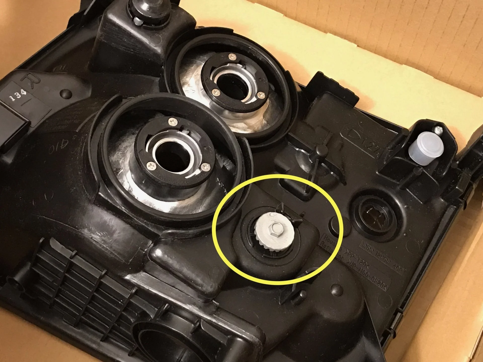

Does anyone know what's the trick to adjust the height of the beams? Just installed the bulbs, very bright but I feel the beam is slightly too high and may blind oncoming car. But the LED chips are in the correct position (3 & 9 'o clock) it may need slight tweeking, but very time consuming.
Would be great if I know which way to turn since this is in the factory reflector housing.

You'll need a longer than average #2 Phillips screwdriver. Photo is the backside of the right ((passenger) side headlight.
Look for this adjuster, see the two molded fins about the grey gear, thats the guide slot for the Phillips head to engage those teeth.

LED Definitely the way to go. Is there enough room to get the screwdriver on to even engage on that hex head? Luckily there's not a battery in the way like on driver's side.
