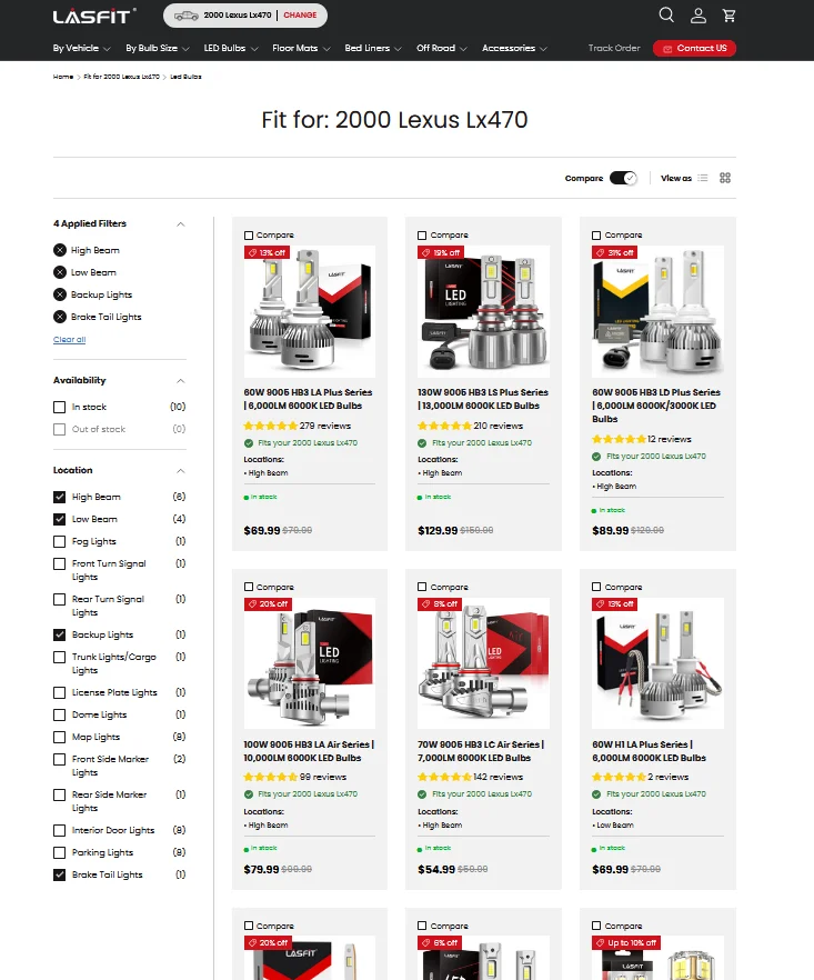

You installed these on the tailgate break lights? Can you send me a link?LASFIT OEM style replacement LEDs for the headlights and taillights. They're the shizz.

LASFIT for LX470 Direct fit installation; no kludging required. You need to ensure whatever you buy and install is compatible with CANBus. These are.You installed these on the tailgate break lights? Can you send me a link?
Thank youLASFIT for LX470 Direct fit installation; no kludging required. You need to ensure whatever you buy and install is compatible with CANBus. These are.
