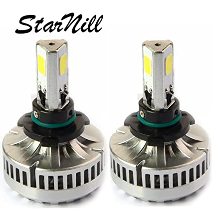

The issue with most LED bulbs is that they usually use 1 or 2 emitters, which aren't able to emit the full 360 degrees like a halogen bulb. Most the LEDs used have a narrower emission angle of 100-120 degrees? The surface area of the LEDs that emit light are also smaller than the halogen bulbs filament, so misalignment with the reflector housing and/or uneven illumination patterns lead to poor quality illumination on the road with a poor cutoff pattern and even hotspots (glare) to on-coming traffic.
That said, the closest I have seen for more even illumination is a 3 sided LED bulb like this:
I only run these in my high beams and returned the matching set for the low beams as they caused too much glare to oncoming traffic. The 3 LEDs in the radial arrangement still have hot spots that don't mesh well with the 100 series's low beam reflector housing. Oh for the LEDs I added a 3"x1" aluminum heat sink to the external LED drivers and have had them 2+ years without issue.
