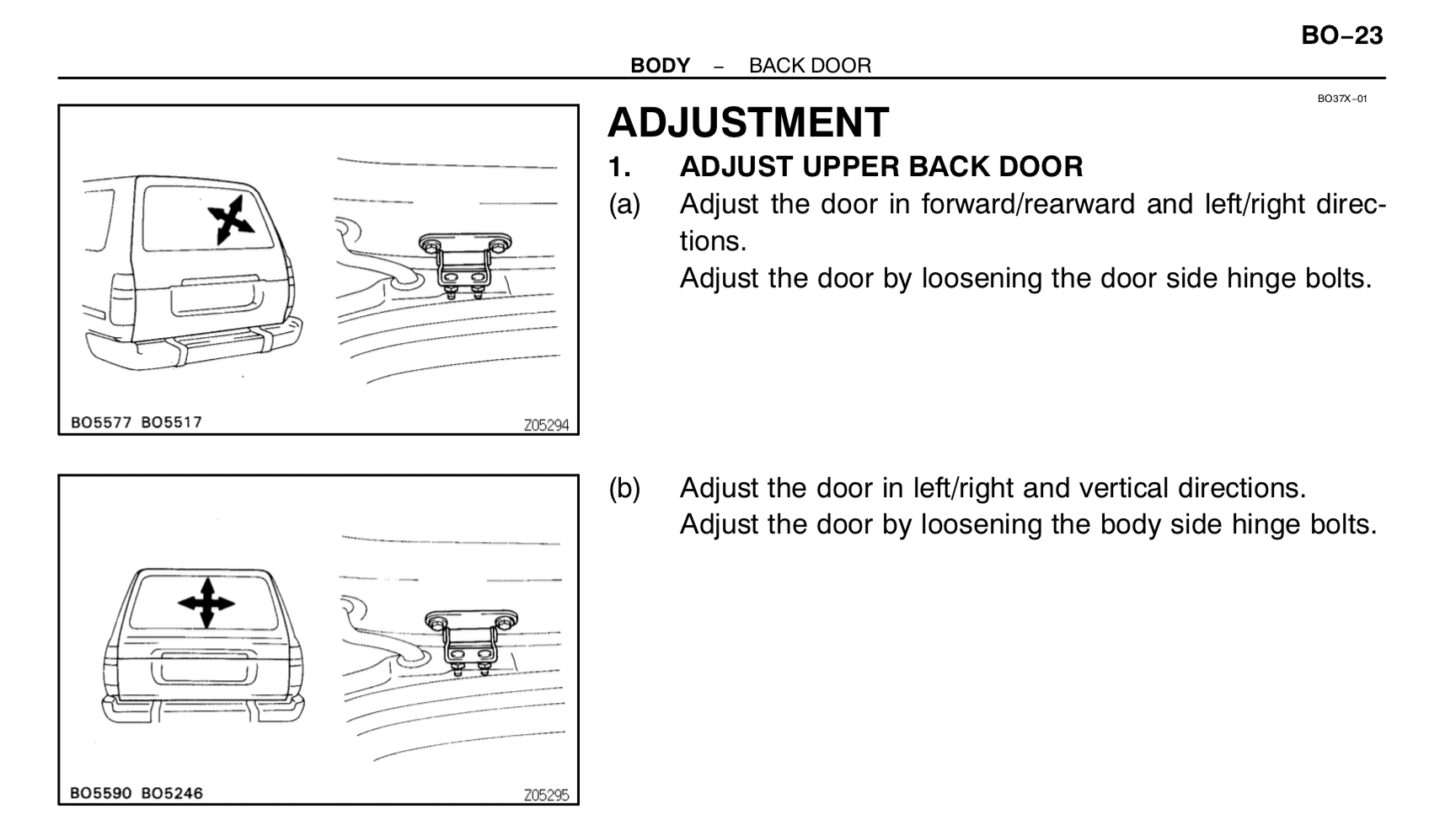

I don't see anything in the FSM about what adhesive to use with weather stripping but I wonder if an adjustment of the door would help -
