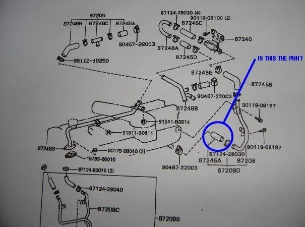

I had a little left side tip over on a trail recently and the rig sat on the DS for about 2 hours. Later that evening I noticed a small coolant leak and then the engine started running rough. It then threw the code for the knock sensor. I've replaced the PHH (last year) and confirmed that the clamps are tight, but coolant seems to be leaking from close to the PHH. It's very difficult to tell where exactly it's coming from. I'm going to investigate this weekend, but wanted to see if anyone had any thoughts on what and if anything could have happened in this area with these two issues after the rig was on it's side for a bit.
Any and all reasonable deductions and wild guesses are appreciated.
Yep, it's the "PHH Neighbor". If you pull your throttle body off, it's the formed hose that runs from the bottom then down beside the PHH.

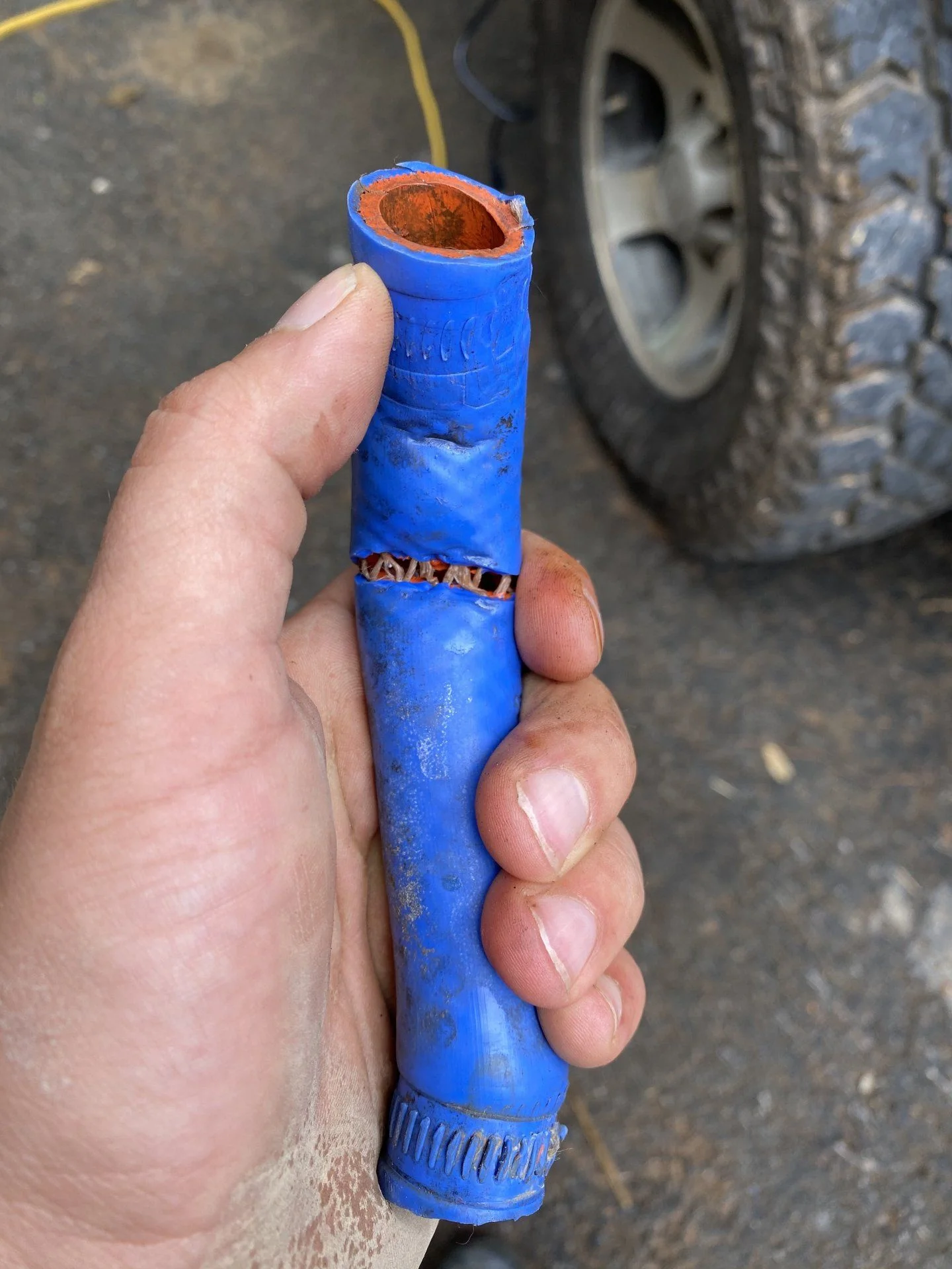

I think this theory is correct. The leak was from the piece of tubing that runs from the heater control valve to the top of the metal pipe that connects to the PHH. It was leaking down the back of the pipe and then coming straight off the PHH making it look like the PHH was busted. My guess is it was worn out at the bend and the flop caused it to pinch further and crack open. It was like this when I bought it so I'll likely purchase the molded hose kit from Wits End for peace of mind.
The fluid was leaking right onto the knock sensor so my best guess atm is that it is exposed somehow and the coolant is causing it to short.
