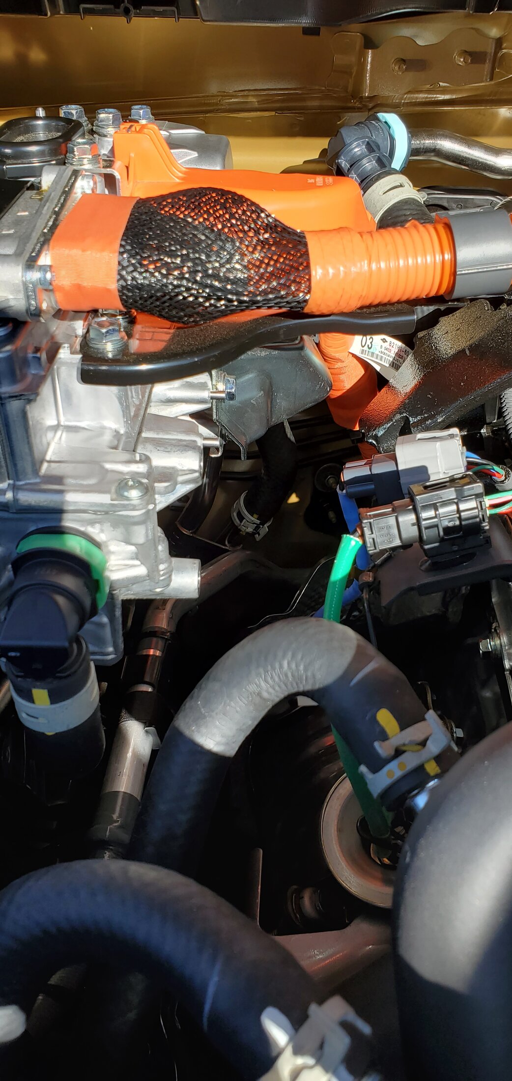

Quick update. In my LC's engine bay, there's a cooler line behind the hybrid battery that sat too closely to the firewall. The techs adjusted it, and the sound is gone. I'll keep testing, but here's a photo of what I'm talking about. I'd check that area and see if that's what's causing your rattle.
Glad to hear they found a fix - hopefully! I'll take a look there this weekend to see if I can make some adjustments.
I'm 90% sure that's the correct fix for me as well. I couldn't replicate the rattle in my garage, but I do see where the metal hose/adapter piece is contacting the firewall and made slight wear in the paint. I didn't have any tools that fit back there to adjust the hose positions. I used some zip ties for now and I haven't heard the noise after a short drive. I scheduled an appointment for Thursday to have them try to adjust it. I'll report back, but so far it's looking like the same fix as yours.

Cool. Glad to know it worked for you. Mine's been silent since the fix. My dealer submitted the issue as a potential TSB.
Brief update: The dealer adjusted the hoses/brackets and it's still quiet. No more zip ties. Not sure exactly how they adjusted it but there's about 1" more clearance to the firewall now before anything hits. That should fix it.

I have similar issue. Been to the dealer 3 times now. They adjusted thr bracket that holds the cooling line, the also put spacers on that bracket (passenger side). The issue seems to be mitigated but i still hesr it every once in a while, more so i put it on tow haul mode as someone suggestd here. I dont think the dealer really found an issue but they told me they were doimg trial amd error in adjusting those lines. I hope toyota comes up with an official diagnosis and a definite solution

Where did you pit the zip ties? Can you send a pic? Did the dealer say anything?
