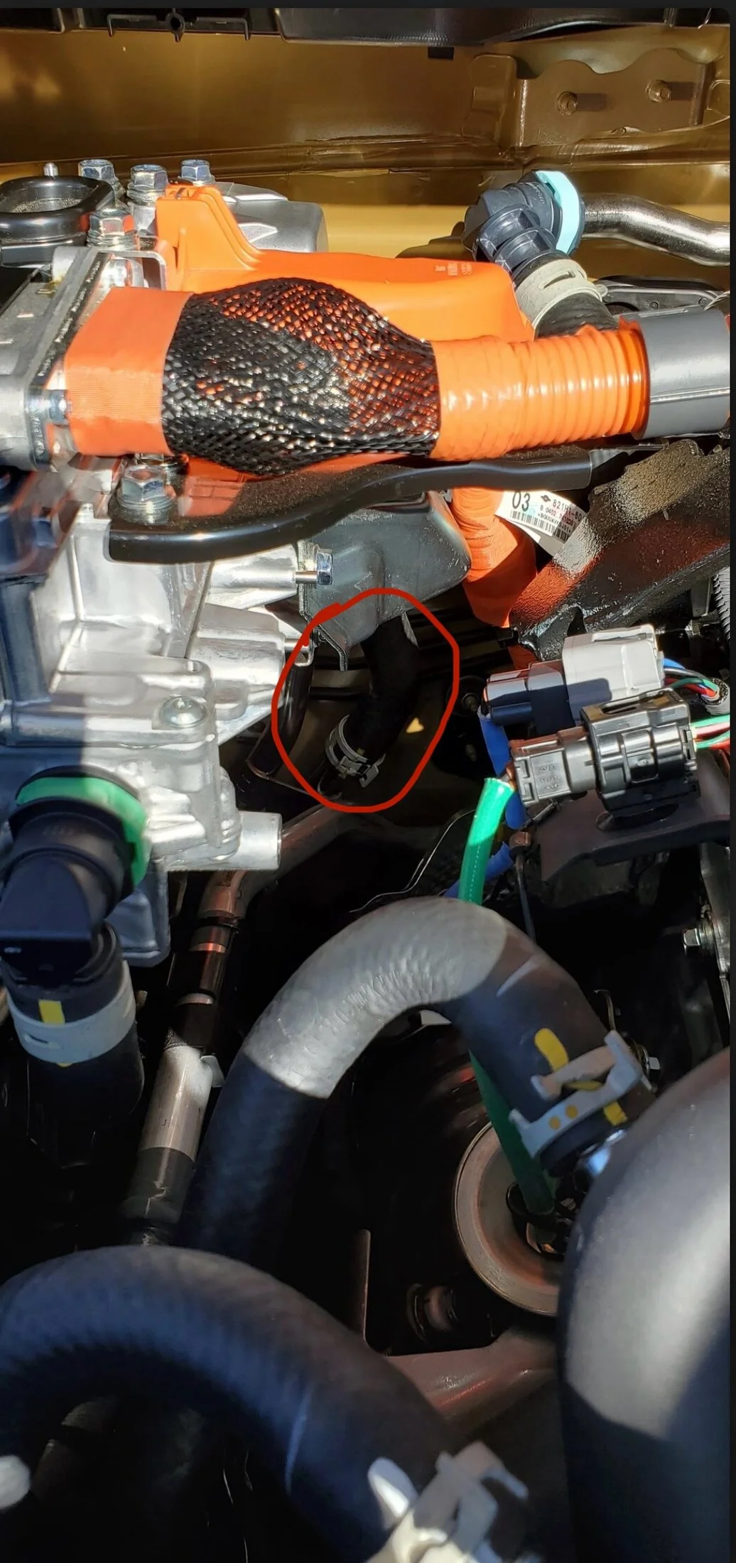

Hello, when you say coolant hose, is this the one you mean? Sorry, I am just wanting to know. I’ve taken it to the dealership twice and they can’t seem to replicate the sound but as soon as I drive off there goes the sound again ): so i’m gonna try to mess with it myself
I don’t have this noise but yesterday I was installing new UCAs and on the passenger side when the rear inner fender liner is off you can see and reach the hoses in the above pic pretty easily from below.
It’s pretty easy to make one of the hose clamps on those hoses tap the firewall. I put some dense foam between the metal bracket and the firewall and now can’t make it hit. A section of old radiator hose would be perfect to wrap around that double heater hose and take care of the problem if this is the source.

First pic is rear of passenger side wheel well with cover removed looking up toward the firewall.
Second pic is where the hose clamp can hit the firewall with very little movement and where I put the foam.
