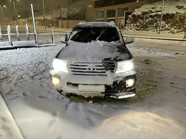

I’ll attach a picture of the previous snow storm so you get an idea of how the roads will be. At that time I had a 4X4 2005 Jeep Grand Cherokee with no low gear and no central differential that didn’t move at all 😅
Thanks again

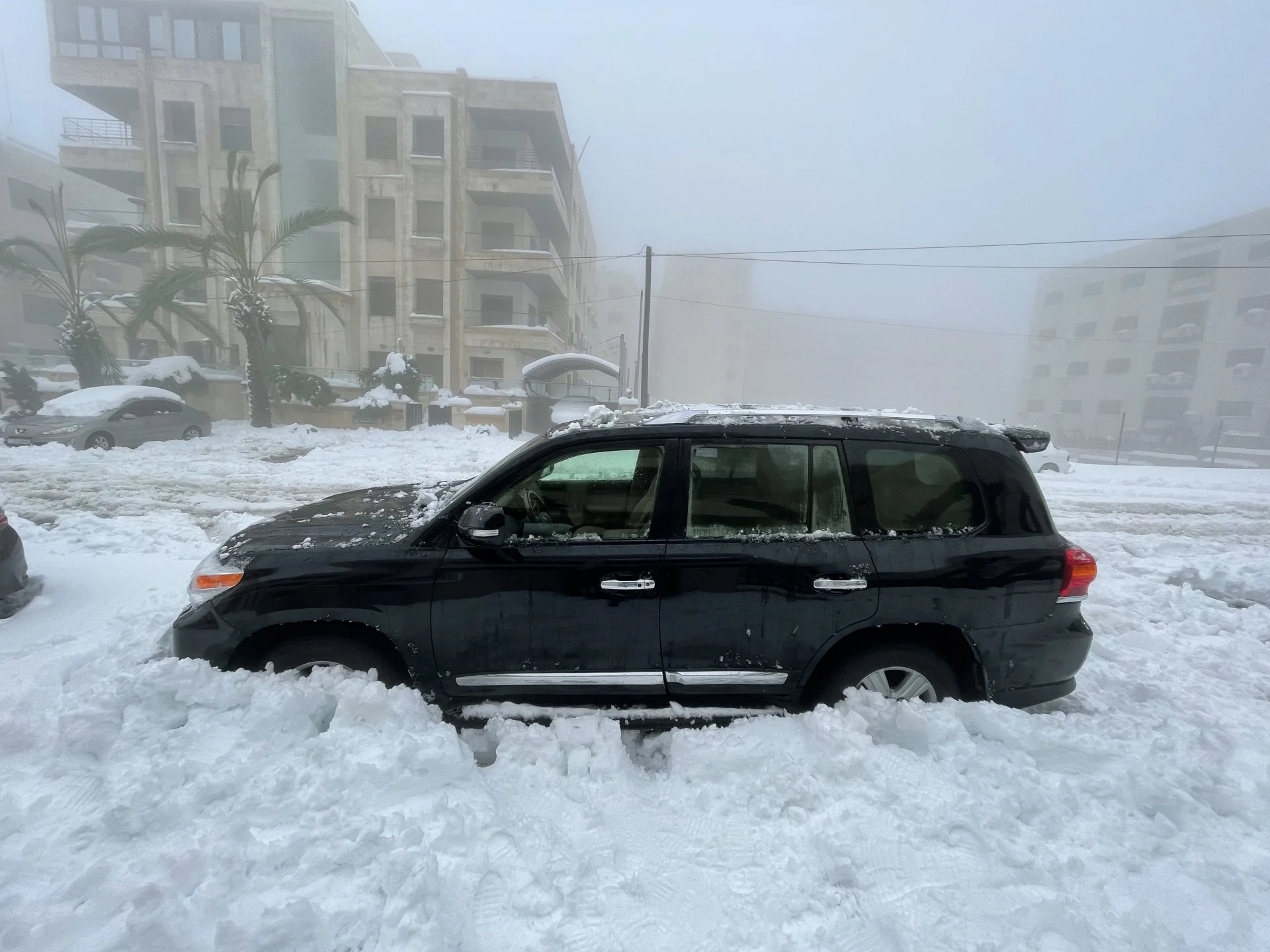

I want to thank you all for the great tips and advices it really helped. First time to drive LC 200 on the snow and I felt complete control of the vehicle.
The L4 and locking the central differential helped a lot with going down steep hills, I felt that the car is stuck to the ground and going down slowly. Going up hills was smooth as well. Drove on maximum 20-25 cm of snow, apparently it will be 50 cm after 12 hours.
